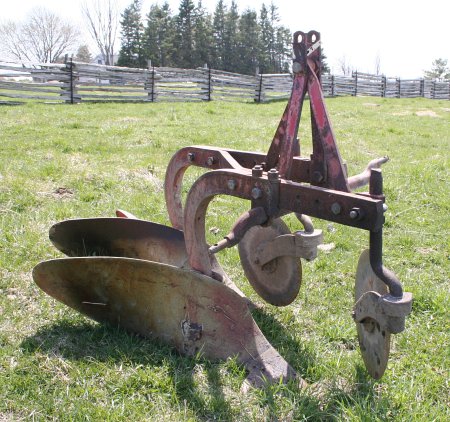

I bought this plow last weekend at a local auction for $150 CDN. Anyone know what it is? I think is is a MF but that is all I know! I hope to give it a try Saturday on a little bit of my the pasture. I am hoping to plow about 400' by 300'. Any before you start tips or you should do some kind of adjustment. I am very new to this. Any suggestions wouldbe appreciated. Steve

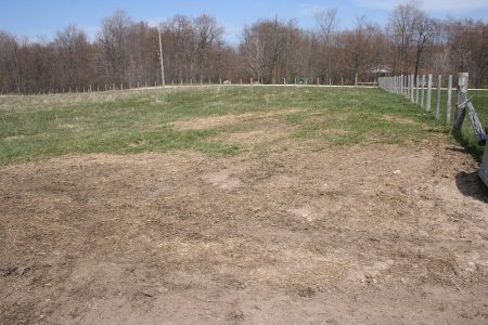

Here is a picture of the pasture.

I have no idea about a brand, but of course it's a two bottom moldboard or turning plow. I'm only guessing, of course, but unless you have pretty loose easy soil to plow, it just might be a little too much for your tractor unless you run it pretty shallow. I'm not at all confident that I could describe in words how it needs to be adjusted. Do you have a neighbor nearby who has used one and could show you? On the first pass, or first furrows, you can have it level (side to side) and almost anywhere behind the tractor, but you'll need to adjust the depth it runs by adjusting the length of the top link on your 3-point hitch. Then after that first furrow, you'll be running with your right side wheels in the furrow, so with the tractor tilted to the right, the plow needs to be adjusted to be level with the ground. How much that tilt is depends on how deep you're plowing. And the plow needs to be adjusted so that the right side plowshare is the appropriate distance inside your right rear tire track (distance determined by the size of the plows). And for the plow to roll the soil over in the proper manner, you need to be moving at a pretty fair speed. Does that make any sense? Or help any? /forums/images/graemlins/tongue.gif

Thanks for your help. I think I understand what you are saying. My tractor is 32HP HST with loaded R4's. The manual says it will pull a 2 12" bottom moldboard. My soil is full of rocks 1" to 6". I do not believe it has been plowed in 20-30 years. It has been used for hay and cattle pasture. I'll know tomorrow morning how it going to work out. Steve /forums/images/graemlins/smile.gif

Those are great plows. It has the lift points for the arms that look like 'cranks' and by rotating this cross piece, you can adjust the plow level right to left for best plowing. The fore and aft adjustment will be with the top link.
What you may not have is draft control, and that will give you some fits if you don't have it.
You have probably the best plow set-up you can buy. The ones sold now are have fewer adjustments possible, and are made with more short cuts. Hope you get it set up good to plow that field. Have fun.
To set the plow up, I would park it on a flat surface and run the left wheels (front and rear) up on 6" blocks. The lower the plow to the flat surface and level it so it sets flat right to left and front to back. This will duplicate the plowing when the right wheel is in the furrow.

Might be wrong but it looks like a Dearborn to me. Check out this info on setting them up and see if it may be of help to you. plow setup
   / New Plow - Hope to use it this weekend #9
Parts of that plow look like an early Ford, but those are Ferguson (or Massey Ferguson) coulters. Just a guess, but I's say mid to late 50's Ferguson....
They look to be in decent shape.
Happy plowing!
