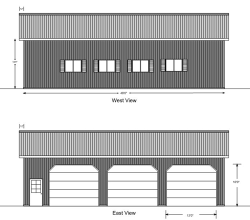

I am finalizing the plans for my new 36x48x12 pole shed. I need help determining the required post sizes (ie. 6x6, 6x8 8x8) and lintel beam to run above the 12' wide overhead doors. The roof is engineered trusses on 4' c/c, pitch is 4/12, and finished with 29ga high rib steel.

You might be able to find out by looking up a pole building mfg's site and see what they use on a building of the same approximate size.

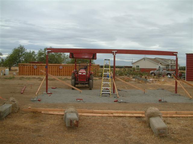

Got it all figured out based on local snow loads, winds etc. Now to price the required steel beams.

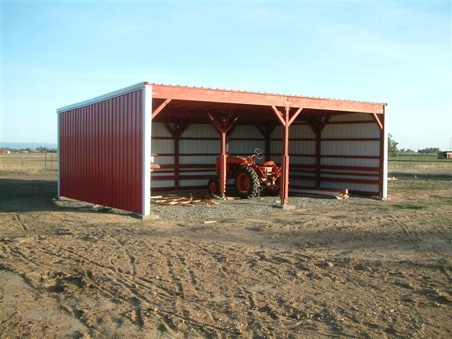

I used doubled 2x12s (glued and nailed) to span 14 ft in my 20x28 ft pole shed. Posts are 4x6 PT. I like to paint the parts before installation.
View attachment 228856View attachment 228857
I had an engineer calculate the requirements yesterday. We have huge snow loads in this area. I also wanted it to support non-windswept unbalanced snow loads along with the possibility of adding insulation in the future. Remember the span is 36'.
