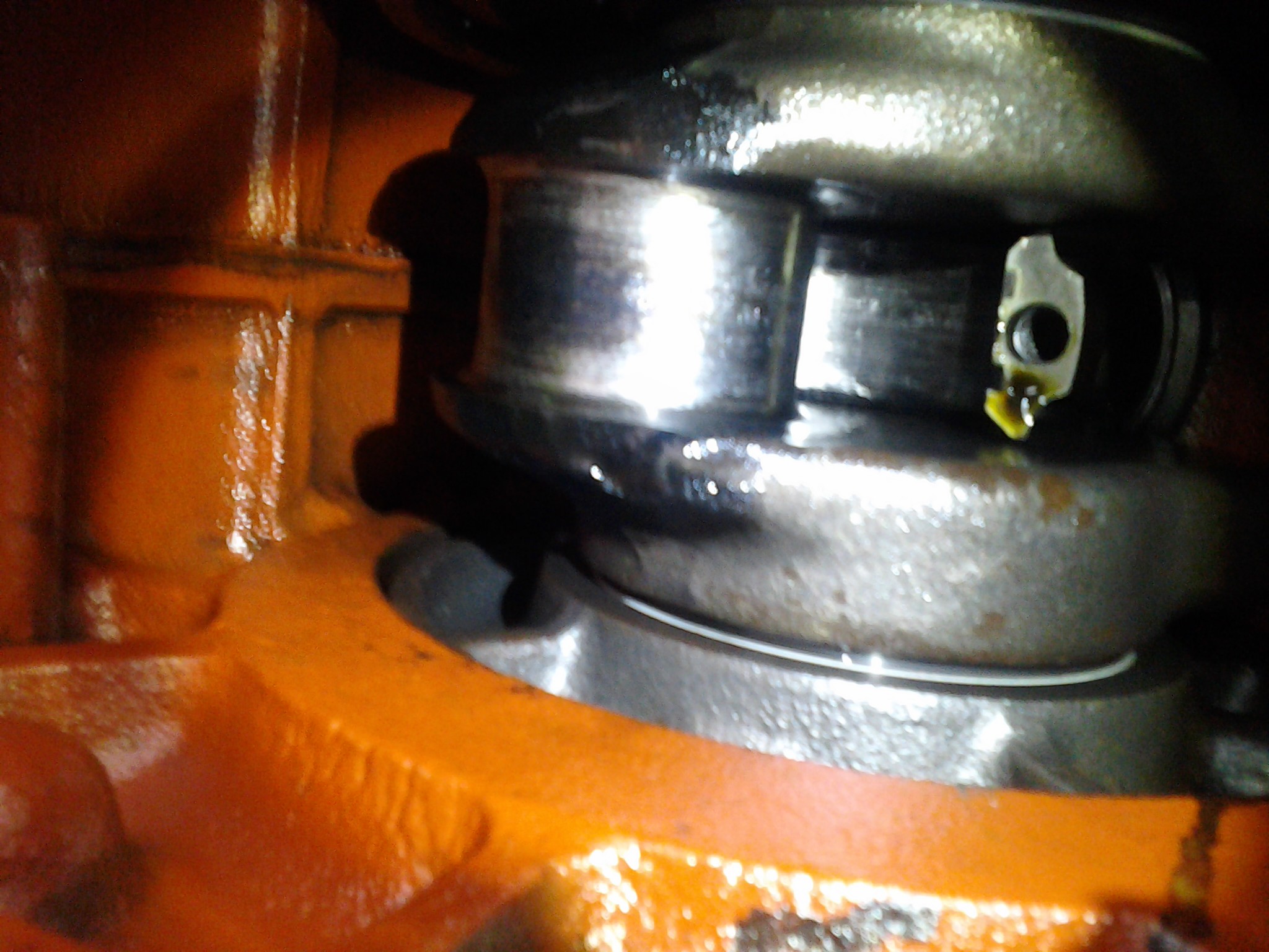

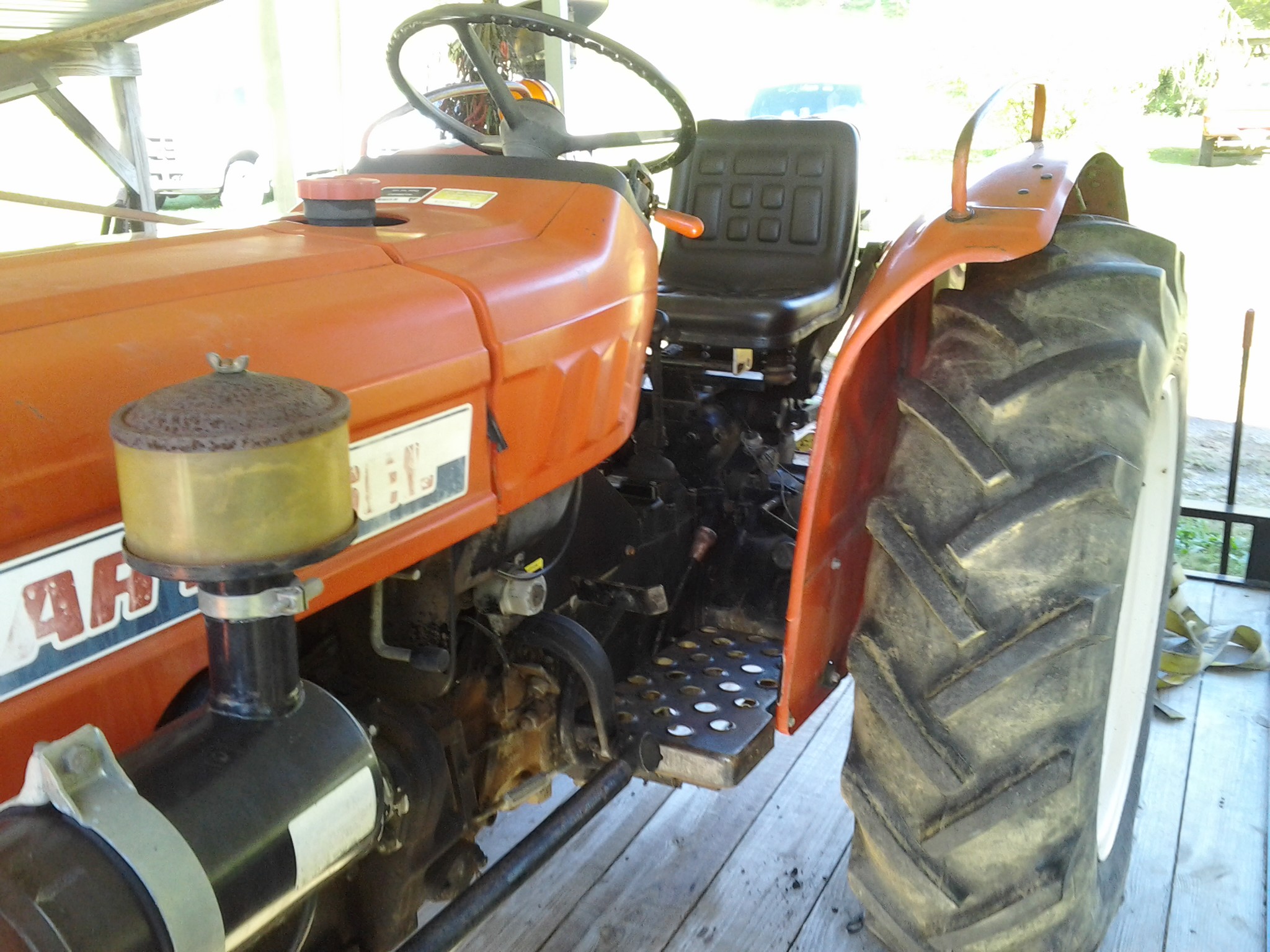

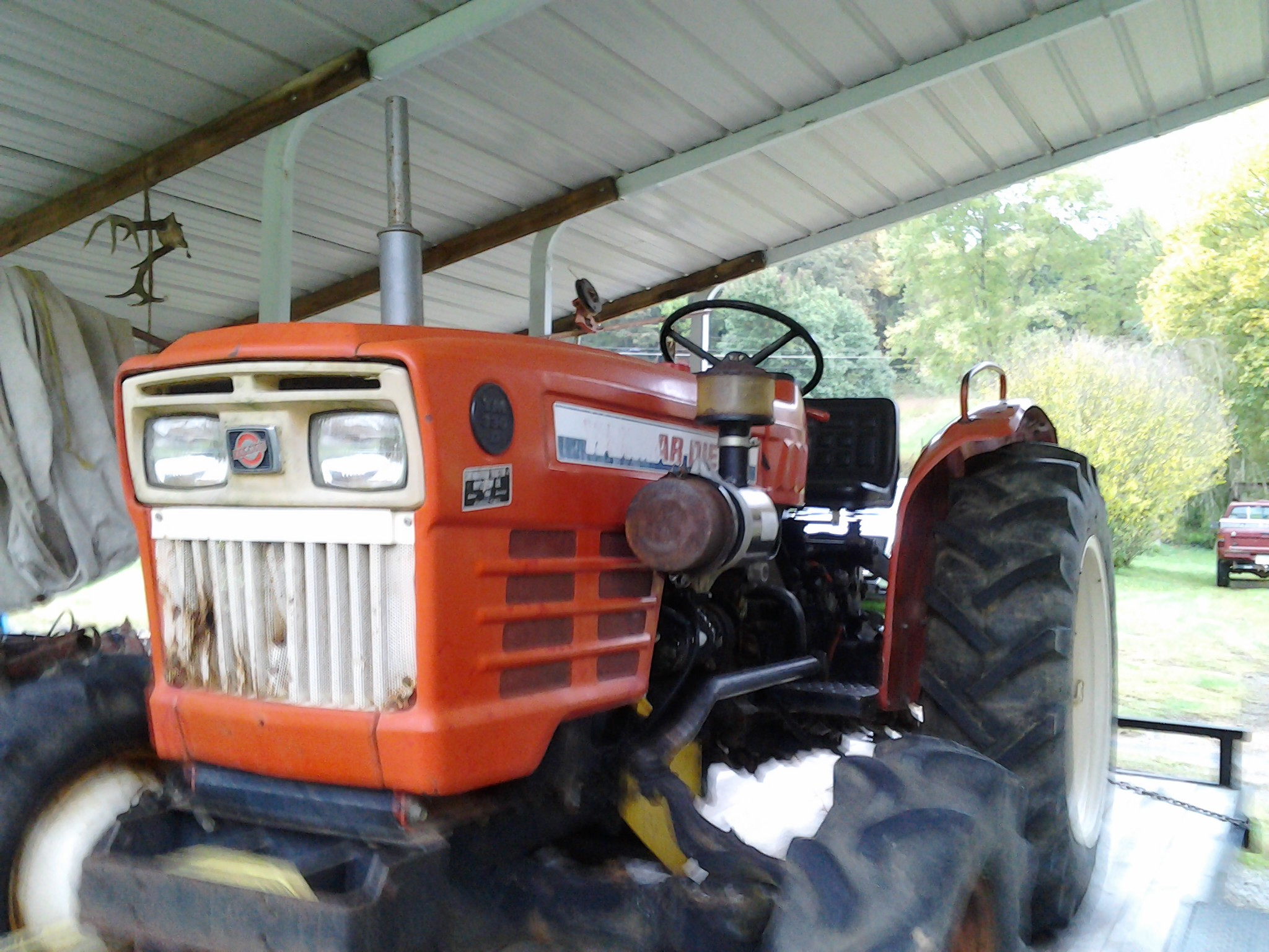

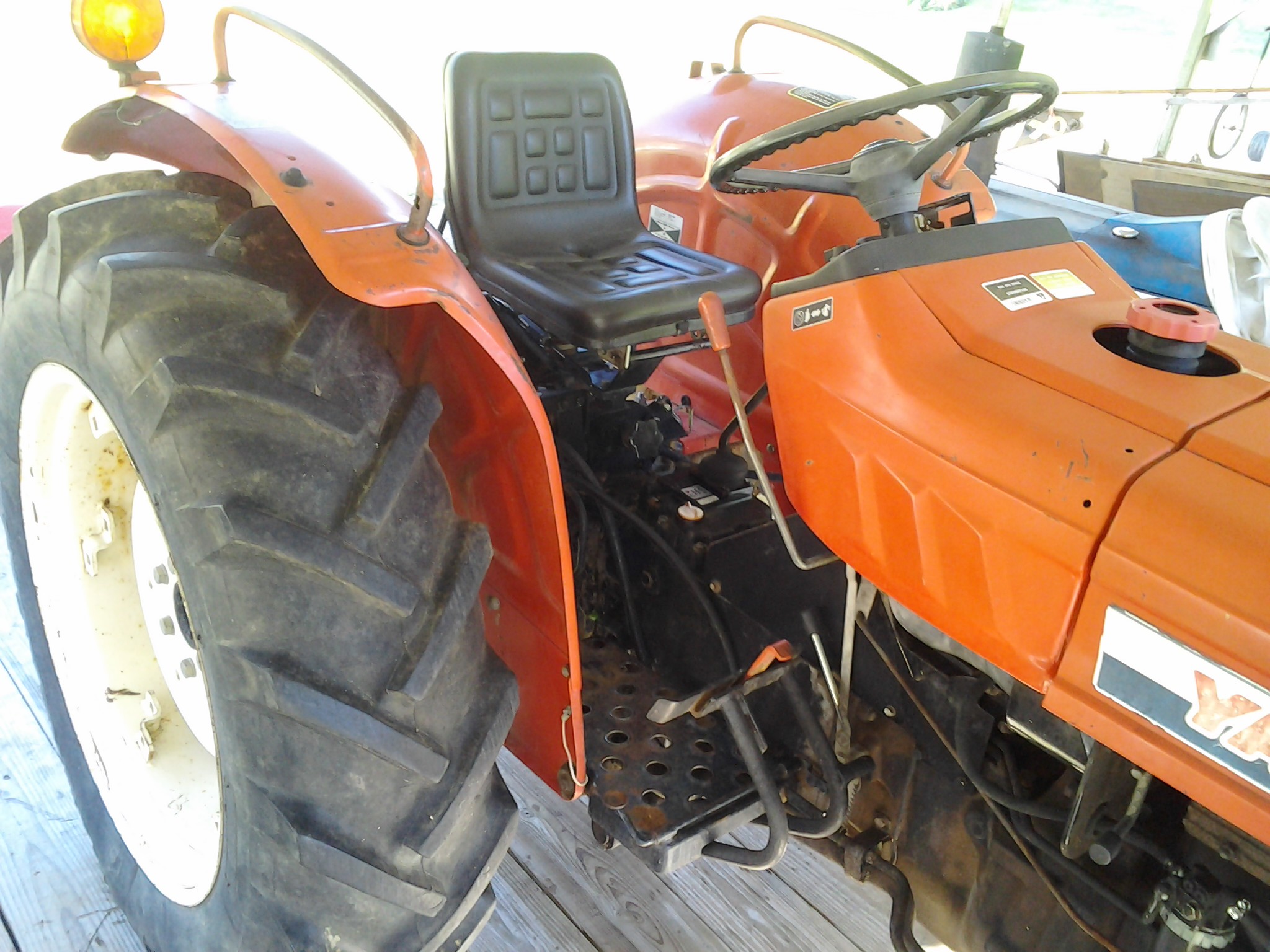

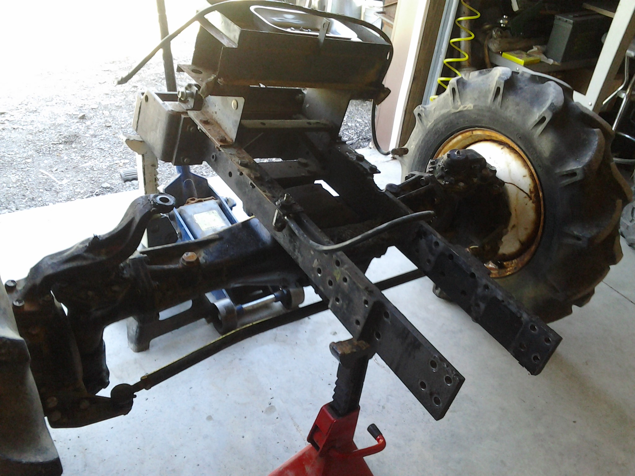

You would think I would be tired of working on yanmars but instead I went today and bought another YM336d. It has 847hrs with a spun rod bearing. It don't seem to have ever had a bolt turned on it. If this turns out good I'll sell the other one. 027.jpg

Could you take the best of both and make a really nice one. The body panels look worn. It has an odd looking badge between the headlamps too. Is that common?
On the intake, is that a turbo? The exahust pipe has no flapper cover to keep out water, rats, birds and wasps.
   / NEW PROJECT
Thats the original paint and the original Yanmar emblem. Everything on this tractor is original except the muffler. The thing on the intake is the air filter. You have to remember this is not a gray market tractor. I agree with you about the flapper but since I'm going to tear the engine completely down I will be taking care of any problems.

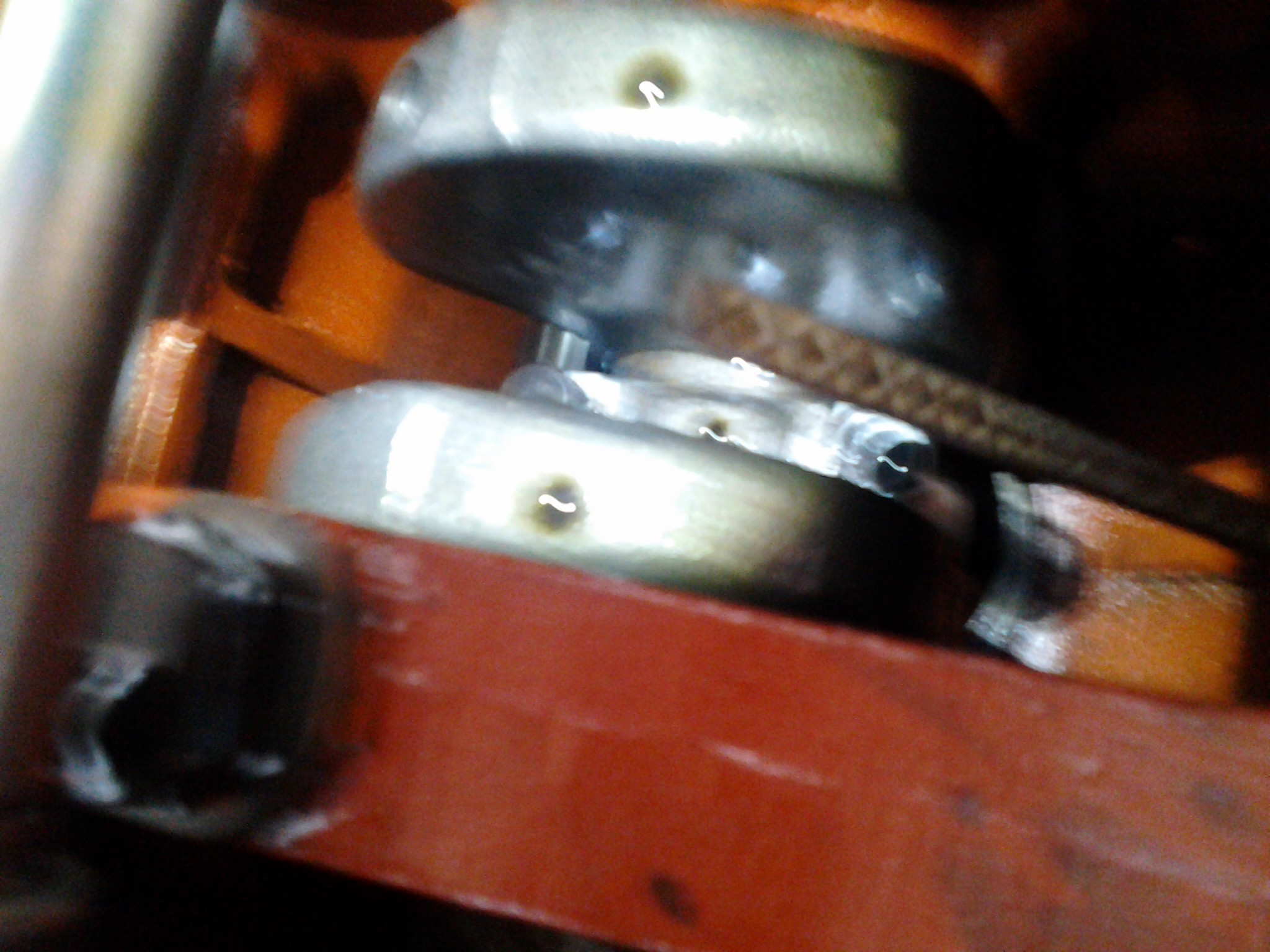

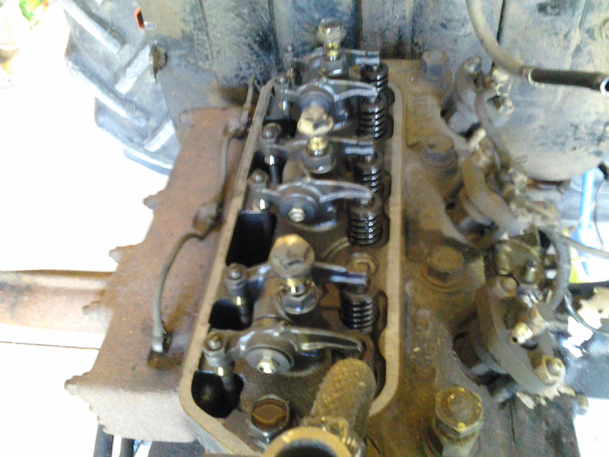

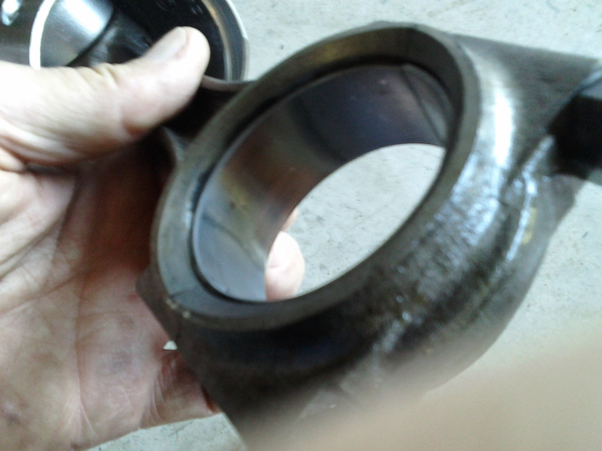

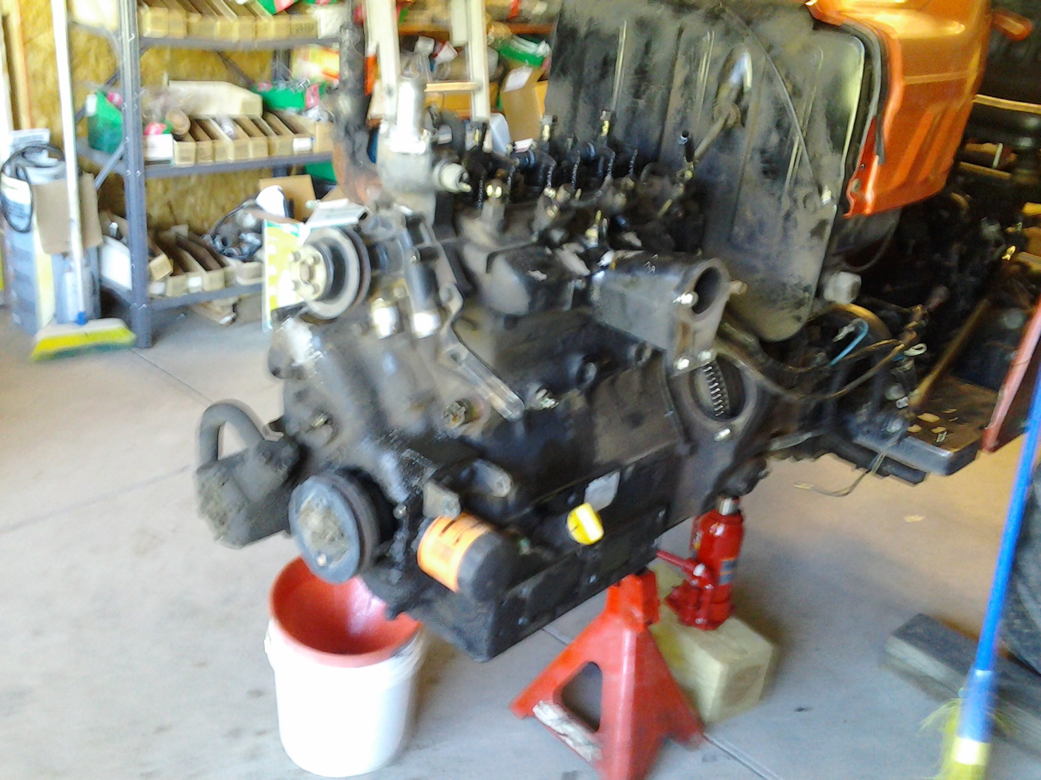

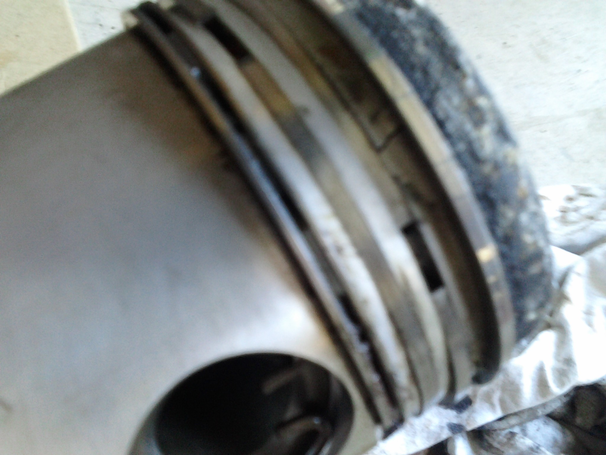

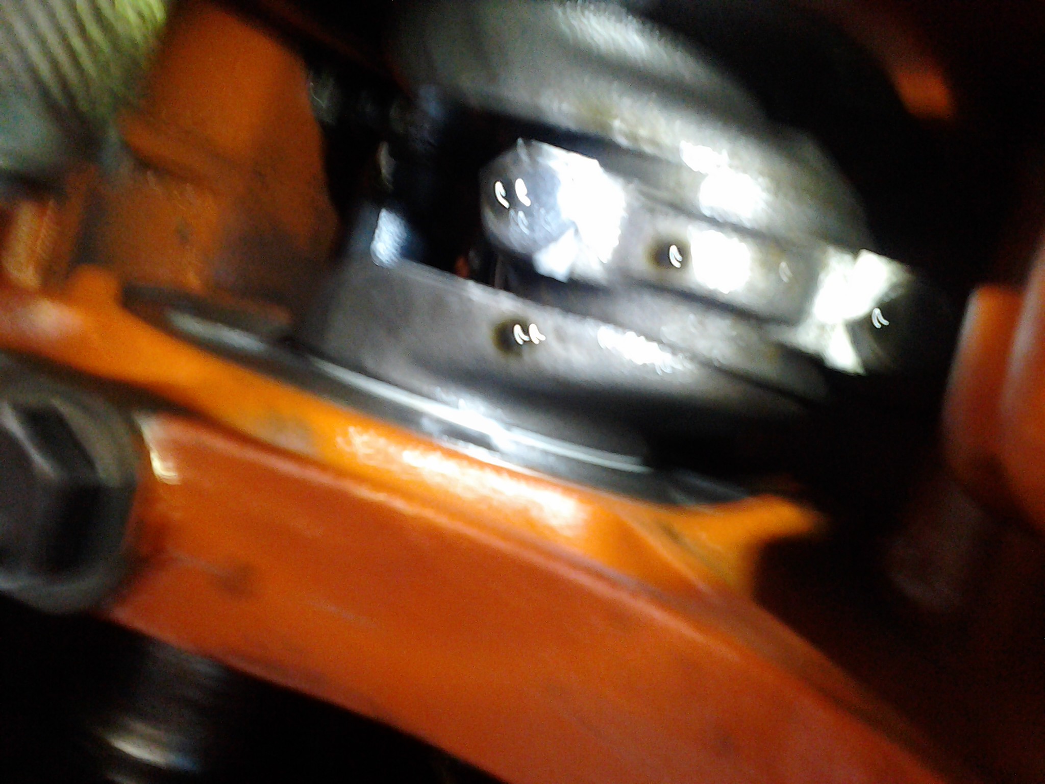

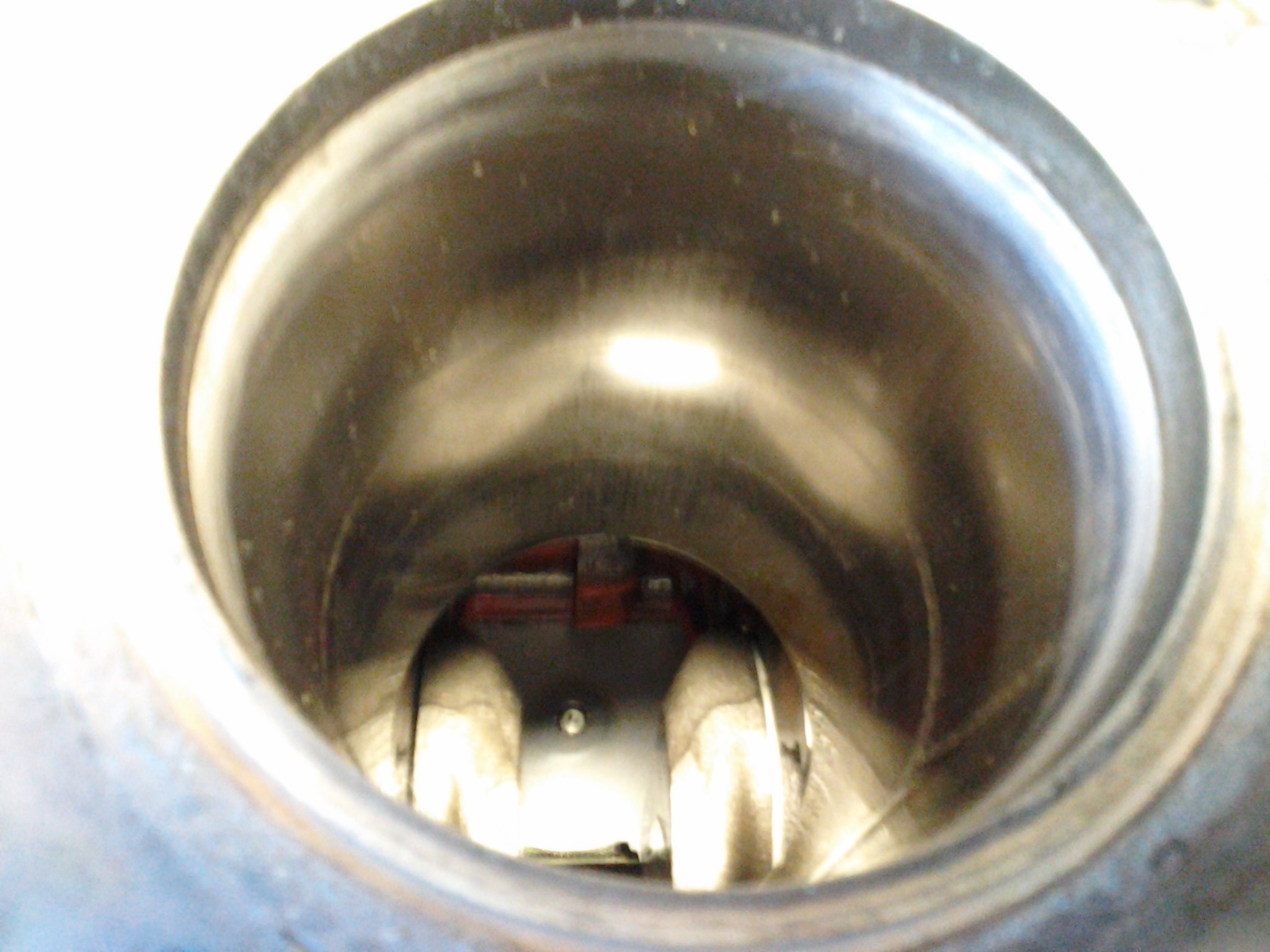

Found this one on Ebay and had to go 180 miles one way to pick up. Here is a few better pictures. It seems that only the one rod bearing was the problem. The engine looks like 847hrs inside. everything looks new.It doesn't look like an engine that has been run without oil. Maybe some thing blocked the oil galley on that rod.006.jpg003.jpg004.jpg007.jpg008.jpg

I guess it's time to drop the crank and make a trip to the machine shop. If you bought it right, you should be able to get some $$ for it

If it turns out as good as I think it will I'll keep it and try to find a loader. I like my ym2002d but it is a little smaller than I need. The other 336 I have turned out to be a good tractor once I got the bugs out but this one is a nicer one.
   / NEW PROJECT #10
I couldn't tell by the pics.. Will you have to replace the rod as well as turn the crank. I have owned drag cars, and when my engine turned a bearing, it usually also screwed up the rod
