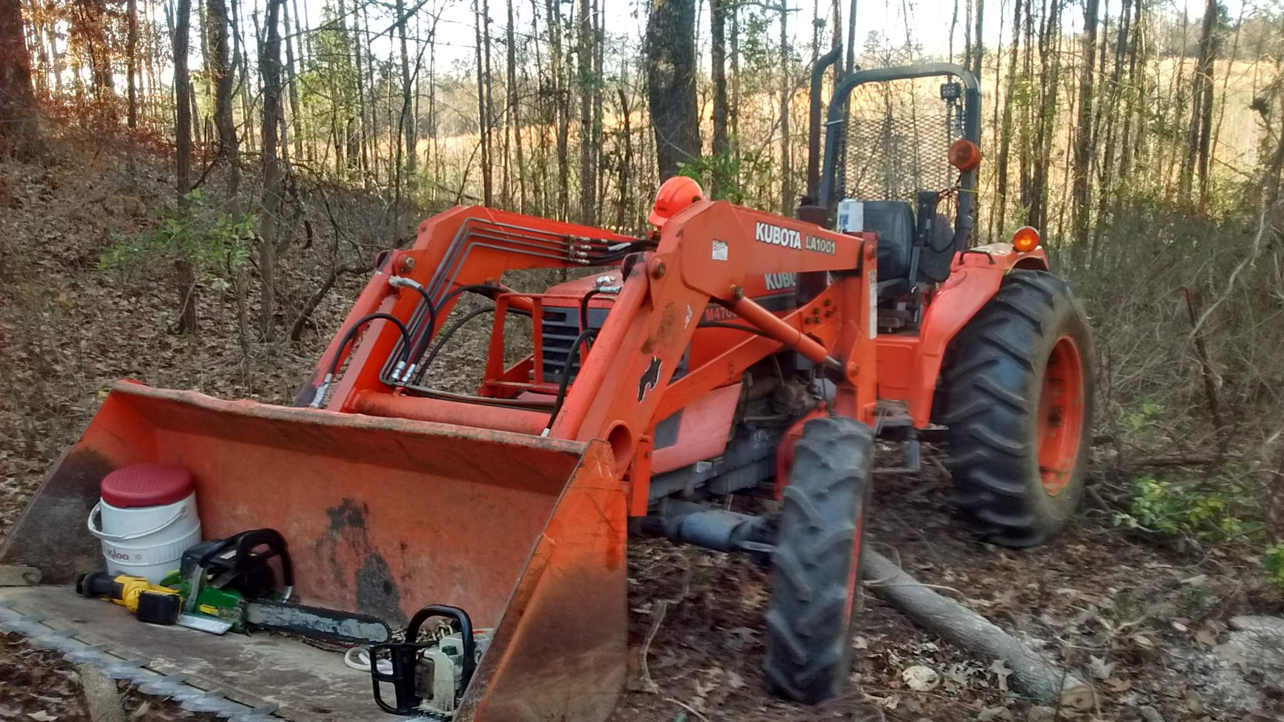

I've a Kubota B7610 w/ FEL and a Woods BH70x backhoe and a Kubota M4700 w/ FEL plus a lot of other attachments.
My B7610 is on the small side for serious wood processing, the M4700, pictured below, is just right.
The B2301 and perhaps the 2601 would be a bit small.
/edit - that's the M4700 in my woods about 180 miles NW of Munford.
