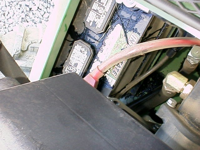

Fan fuse blow, battery leaking: This is a more serious problem. When I first got the tractor, I was surprised at how quickly the cooling fan for the hydraulic fluid came on. However, today, I hooked the mower up and mowed my entire lawn and the fan didn’t come on once. Also, the hydraulic fluid reservoir got very hot. I got suspicious and started looking under the hood. Right away I noticed the battery leak (see attachment). I also found that the fuse to the fan was blown. Now I have a real problem. What caused the battery to leak, overcharging or overheating? How do I clean up the battery acid before it eats my paint away? I didn’t want to spray water on it because the engine was still hot. It there anything I can put on the acid to neutralize it (baking soda?)?

It is a good idea to neutralize battery acid with baking soda and a lot of water. You're certainly right, however, that you need to track down what happened. If you have a voltmeter, it would be a good first step to start the engine and check the charging voltage. I think it would have to be really high to cause the acid to come out through the caps, but a quick check would eliminate that possibility. (The only time I have seen charging put the acid out the top was on a bad battery.)
It's possible, of course, that you just had a bad fuse in the fan circuit. If the replacement blows, however, There's a problem that has to be tracked down.
If the problem isn't easily resolved, don't hesitate to call Power Trac. As I recall, someone else a while back reported a fuse blown in the fan circuit. I don't remember what was reported later. You might try a search.

The hydraulic res does get hot, but probably even hotter without the cooler working. I'd change the fuse and get the battery tested at a garage or battery place.

Sorry about your problems. I would just clean the fluid out, change the fuse and just use the tractor. If it happens again maybe check something but I would'nt worry about it. I blew my fuse, a branch fell into the fan I did not see. I just changed it and kept checking for a while. Power Trac uses a quality battery, if it overflows again you should have no problem getting it replaced.

Well, unfortunately, it’s not going to an easy “hose it off, throw in a new fuse, and keep on truckin’” Take a look at the attachment. I was worried about the acid eating away my paint and with good reason as it turns out. I decided to remove the muffler so I could remove the battery and have a look. I hosed off the acid, after applying baking soda first, and the paint came right off. So now, I have to paint this area before I put a new battery in. Also, my PT came with an Interstate battery. There are other folks on this site who have had problems with Interstate batteries leaking. So, I’m going to switch to another brand since the battery is too hard to take in and out and I don’t want to go through this again. Anyone have recommendations? Anyone familiar with Optima batteries? If so, will they take the heat of the engine compartment? Also, does any company make an enclosure for the battery so, if one ever leaked again, the spill would be contained? Also, any comments on the best way to prepare the surface for painting? Just sand the rust off and throw some paint on or are there certain primers I should use?
Since I have the battery out and can’t start the engine, I haven’t had a chance to check for any electrical problems. Whether the battery was overcharging or not (and whether there is a connection between the battery leaking and the blow fuse), I think the battery would leak because of overheating (from ambient temperatures or overcharging) or from loose caps. Sticking with the overheating scenario for a moment, I wonder if this may have been the problem. At one point, I removed the rear hitch pin to hook up my trailer. The pin was so hot, even on the outside on the tractor, that I couldn’t hold it in my hand for more than a second. Has anyone else noticed this level of heat? Since the battery is close to this pin, I’m sure it must have been just as hot. I’m now worried that I may have damaged more than the battery. I wonder if I also overheated the entire hydraulic system? If so, what are the ramifications?

You should be able to get a battery box at any marine store. If it will fit in the PT, it will completely enclose the battery.
I am certainly no hydraulic expert, but I can't imagine you could damage the hydraulic system with heat. The hoses should be designed to withstand the maximum heat the oil can take. If it got hot enough, the oil would boil and come out somewhere. The process of boiling would absorb heat very fast, so unless flow stopped and you got some kind of local hot spot, nothing should have gotten over the boiling point of the oil, which certainly shouldn't hurt any metal. If no seals blew out, I'd bet nothing was affected at all, but you certainly want to talk to Power Trac, and I would suggest writing a letter to them candidly stating that it is to put them on notice of the incident in case it did cause some problem that will become a warranty claim.

Incidentally, PT Rich's experience is the one I was thinking of. If a motor is stopped, of course, it becomes a near short circuit, and will blow the fuse. If someting got yemporarily caught in your fan, it certainly could explain what happened.

I'm guessing they will replace the battery and send you the paint. They sent me some touch up paint without even asking. I just told them it got scuffed up during shipping and they offered before I could ask.
I doubt that you damaged the hydraulics with the heat. The old PT418 didn't even offer a hydraulic cooler and was rated at the same flows and capacities as the PT425. I hope that puts your mind to ease on that issue. /w3tcompact/icons/smile.gif
I've never seen a battery boil over except from overcharging or a bad battery. If it is a problem with the charging system, your Kohler warranty should cover that. Do you have any Kohler authorized shops near you? You might want to start checking before Monday to get your ducks lined up, so to speak.
