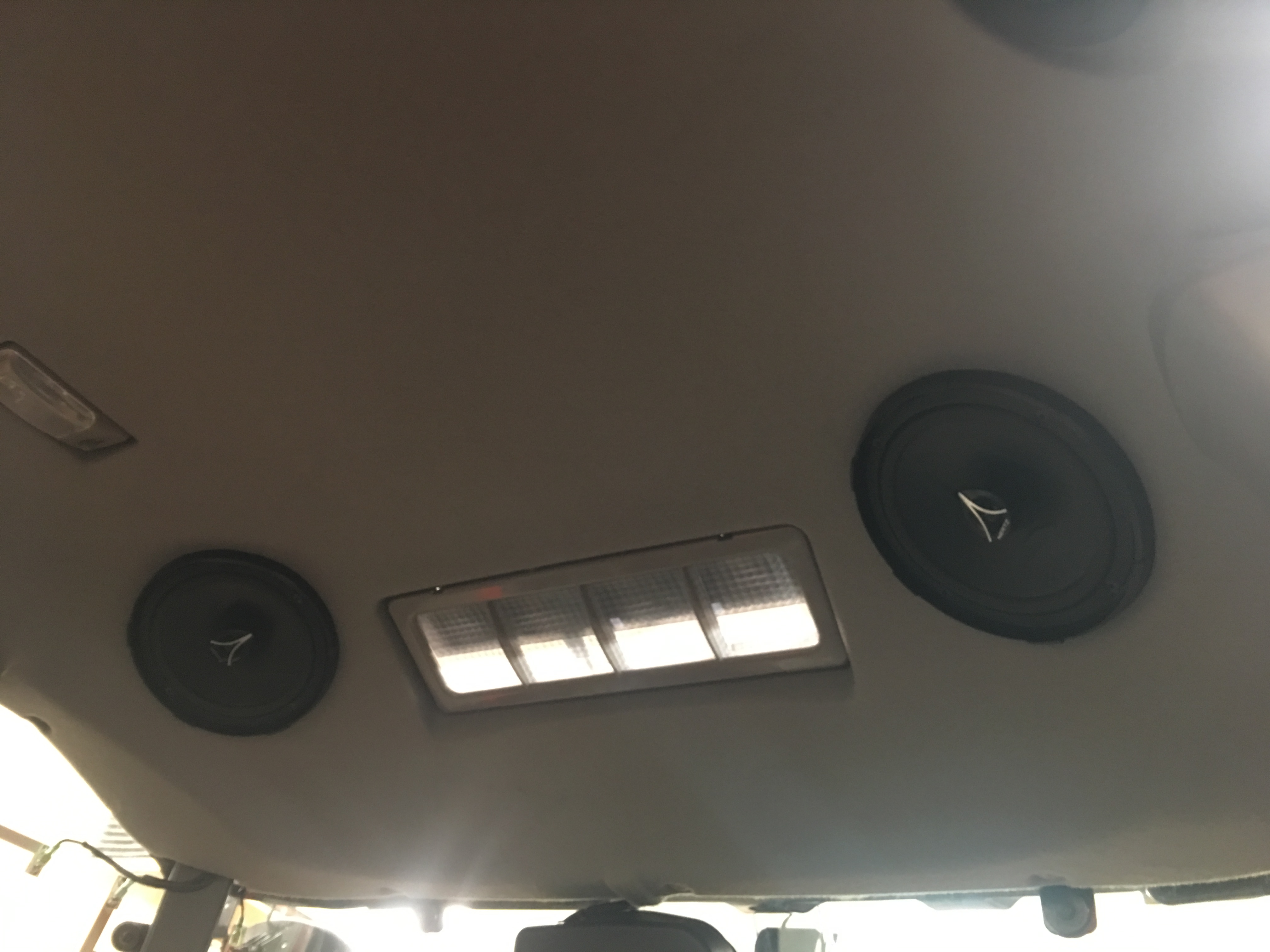

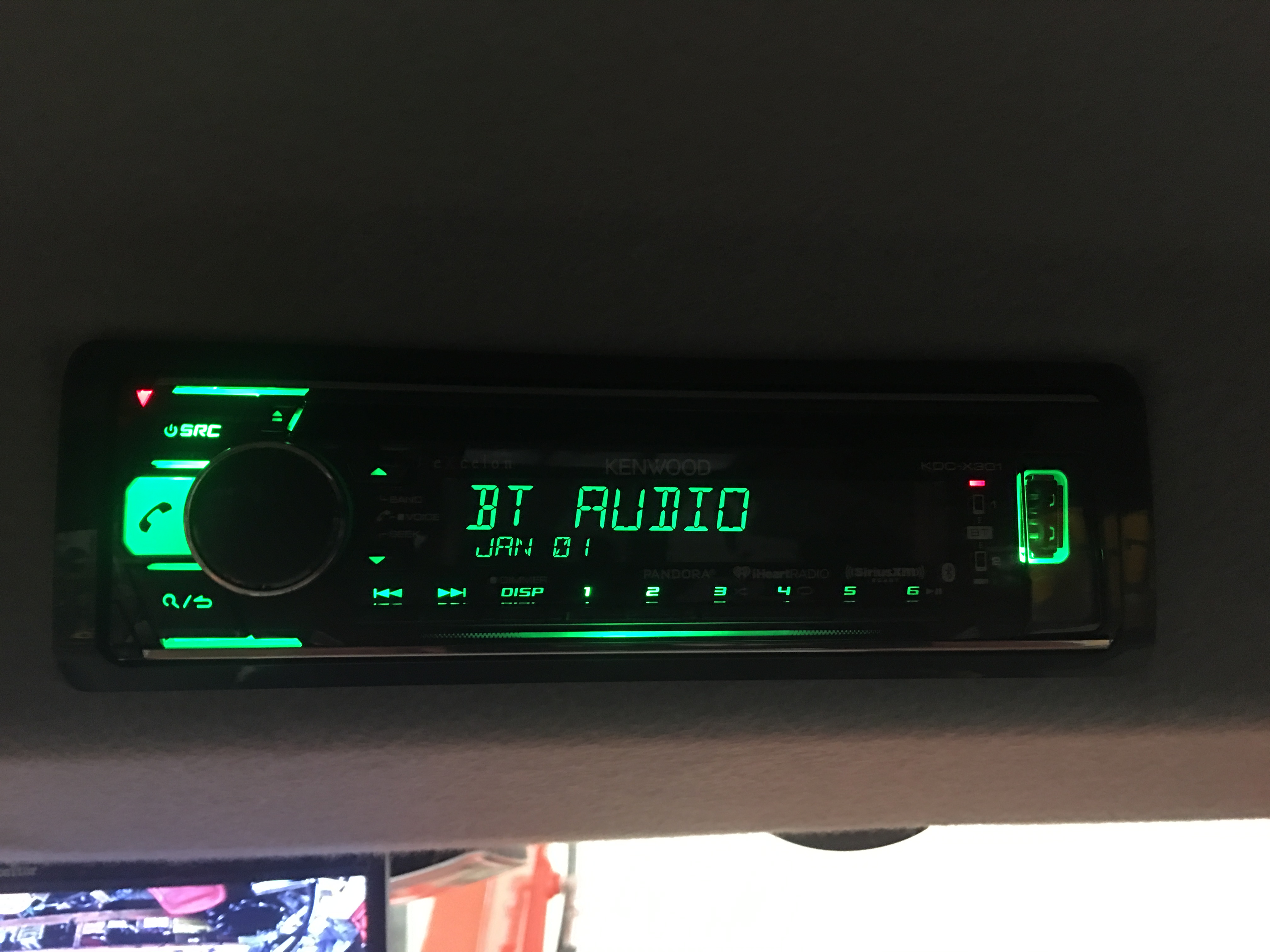

I traded my 3940 last week for a new L6060 Cab Tractor with Loader, I've been making it my own and started installing a radio and upgrading the factory speakers this weekend...

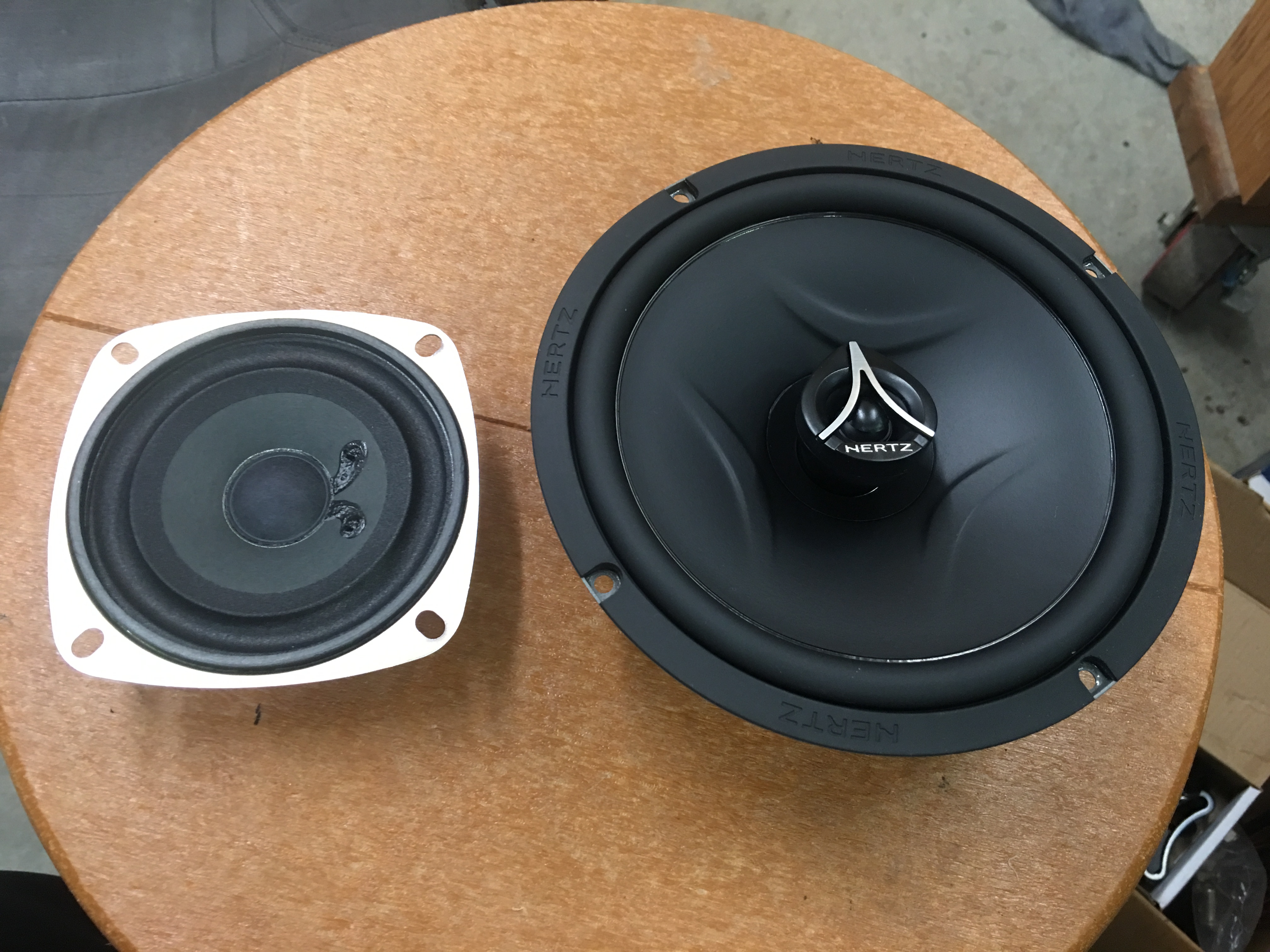

I installed a Kenwood Bluetooth Radio and Hertz 6.5" Speakers.
The factory speakers are tiny compared to the new 6.5", had to cut out the opening in the headliner and make some rings to bolt the speakers into on the back side.
A few years ago I posted information on a wiring harness for the RTV 1100, the tractor has the same harness but the colors have changed a bit so I included a PDF of the updated wiring colors for the All Electronics connector.
here are a few pics of the speakers.....

You should actually hear some bass out of those speakers which you sure don't get with the oem 4 inch speakers. I replaced mine with Polks, but stayed with same size, worried about cutting holes in tractor under warranty. Much cleaner sound but still no bass, not to be expected in a four inch speaker hanging in the ceiling without a sound enclosure. That looks like a 5 1/4 or a 6 1/2 speaker, and with a plastic/rubber cone, not paper as the oem.
It's funny, when mowing, I put my ear protectors on, crank up the radio, and it sounds just fine. No treble of course but just the smoother midrange comes through. I suppose one could put a subwoofer behind the seat.
Enjoy your tunes.

I'm really impressed with the sound so far... LOTS of base you can feel and it digs pretty low, hopefully it retains the base when I put the roof back on..

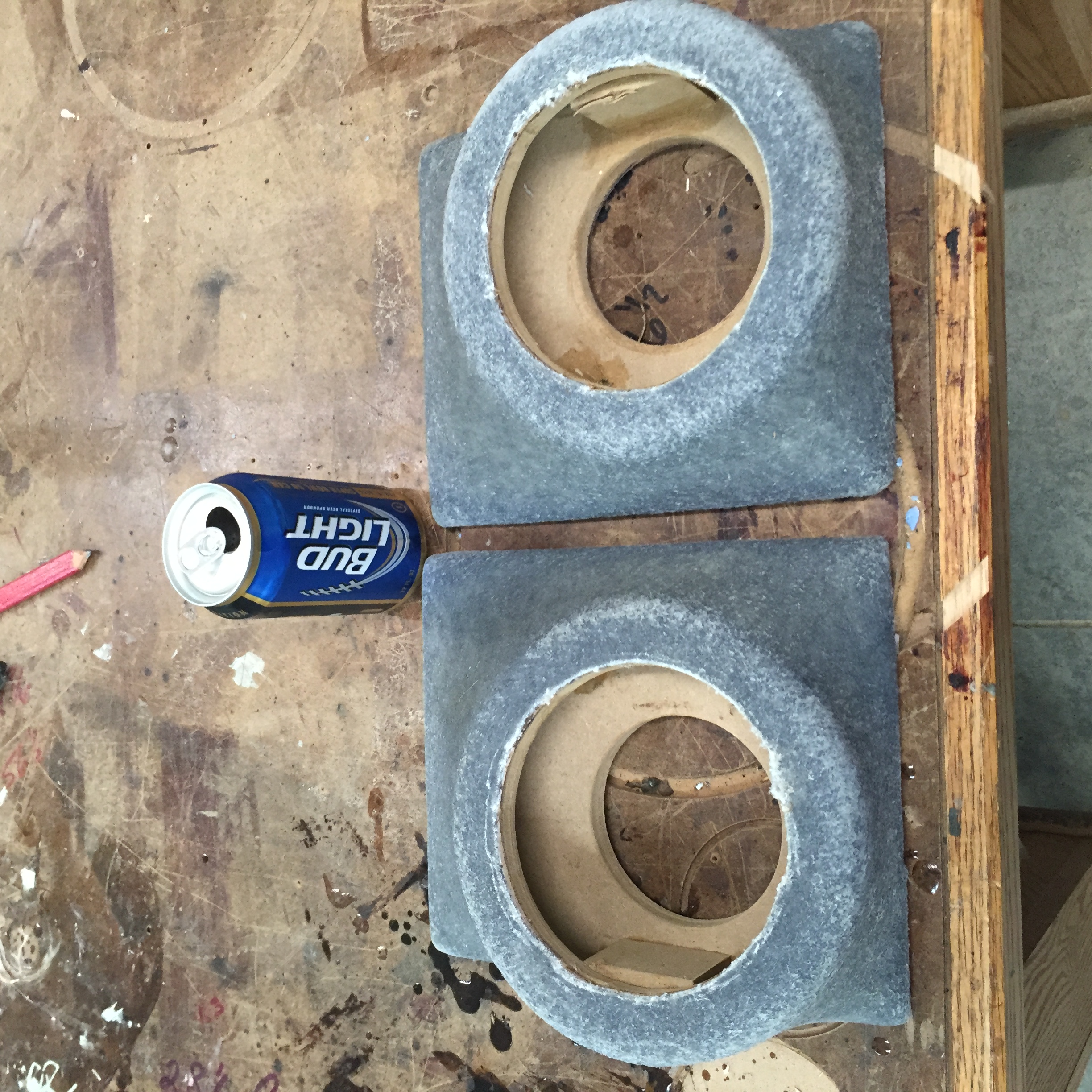

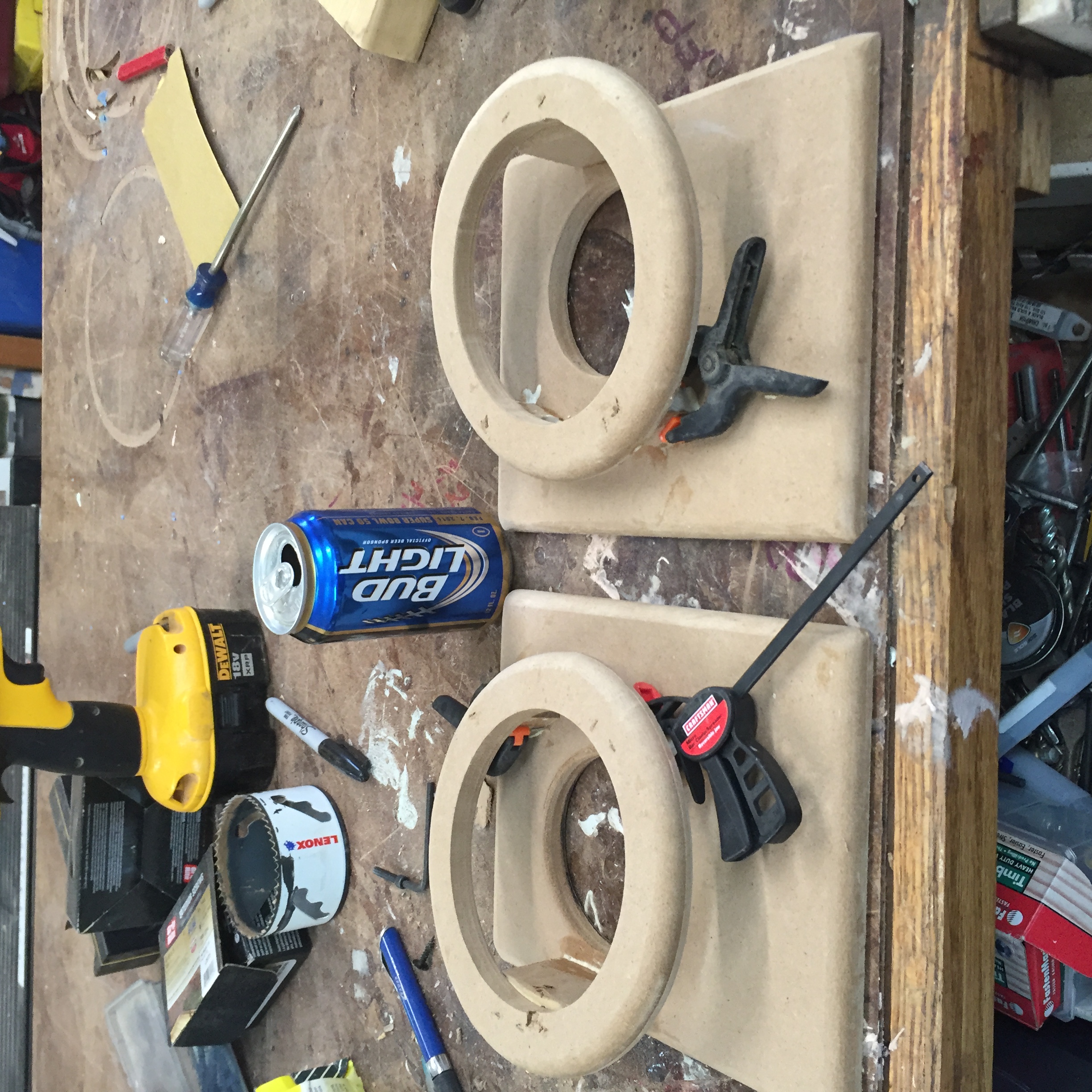

They are the same as the tractor.. tiny 4.5" and nothing larger will fit, , I made fiberglass enclosures for 6.5" speaker on my RTV that vent into the roof. see pics.......
