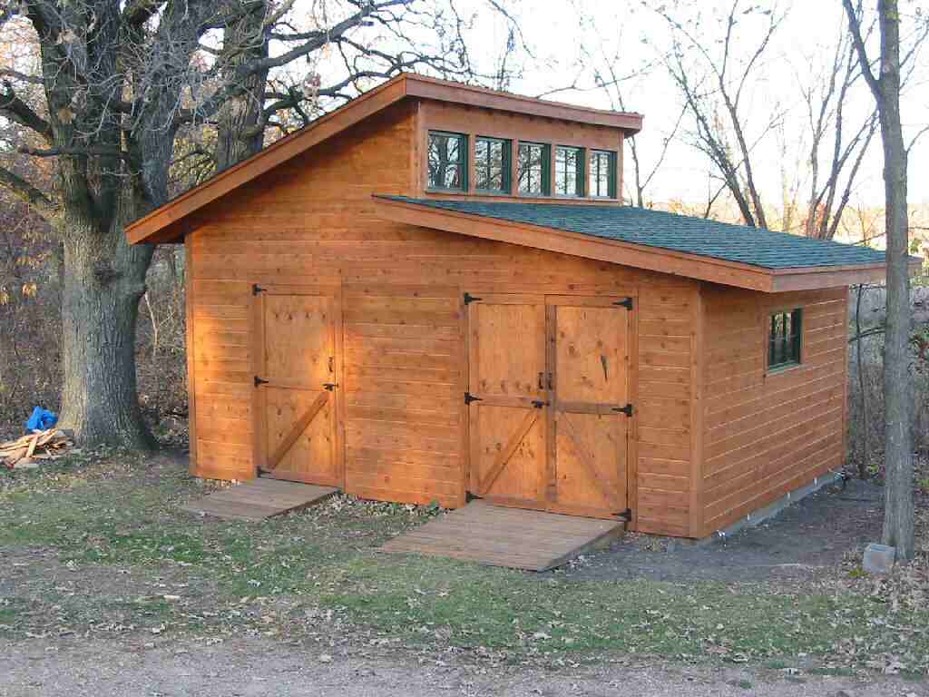

Thought I'd share this photo w/the group, since it's just so darn pretty. This is a shed that I designed/built last year--18'x12'. Style is based on old 1940s-era chicken coop that we had on the property at a previous house. A bit small for most CUT's--the rightside doorway is 5'+ wide x 6' high. The shed is currently just housing a lawn tractor and attachments, but was good practice for building my dream barn, which I'll be able to justify once I've purchased my orange tractor. /forums/images/graemlins/laugh.gif
Lots more photos on our web site: www.seans.com, browse to "Photos", then look for Shed.

Nice looking building.
I like the row of windows on the top level.
Natural lighting is always bad in out-buildings and work shops.

Very nice shed. I like how you did the foundation. Is there mortar between the blocks or are they just butted together?
   / New shed
Thanks for the comments.. The block foundation is mortar-less--just concrete blocks sitting on a bed of sand, so it floats. I was originally going to do beams on piers, but didn't want to risk damaging Oak tree roots while digging holes for the piers. So I opted for beams sitting on a row of concrete blocks. Shouldn't be any settling, because the load is spread out over the row of blocks. Works well for a wooden floor deck. The next step up would have been to do a slab for the floor, but I didn't want the expense/hassle.

Hey, why just build it, when you can OVER-build it? /forums/images/graemlins/wink.gif The project definitely did take on a creeping elegance aspect as I went along. E.g. I just couldn't resist doing everything in Cedar. Ended up being prettier than a stupid shed ought to look, but I couldn't help myself. I DO know that I could never do work like this as a living, though--instead of just building the darn thing, I'd still be obsessing over the details..

I checked out the building sequence on your website. Very nice. Question . . . how did you fasten the building to the ground or did you? I am far from an expert, so far crafting (in the loosest sense of the word) only two small buildings, but it seems to me that you'd want to make sure wind didn't carry off your building and I didn't see any provisions for that in your plans.
