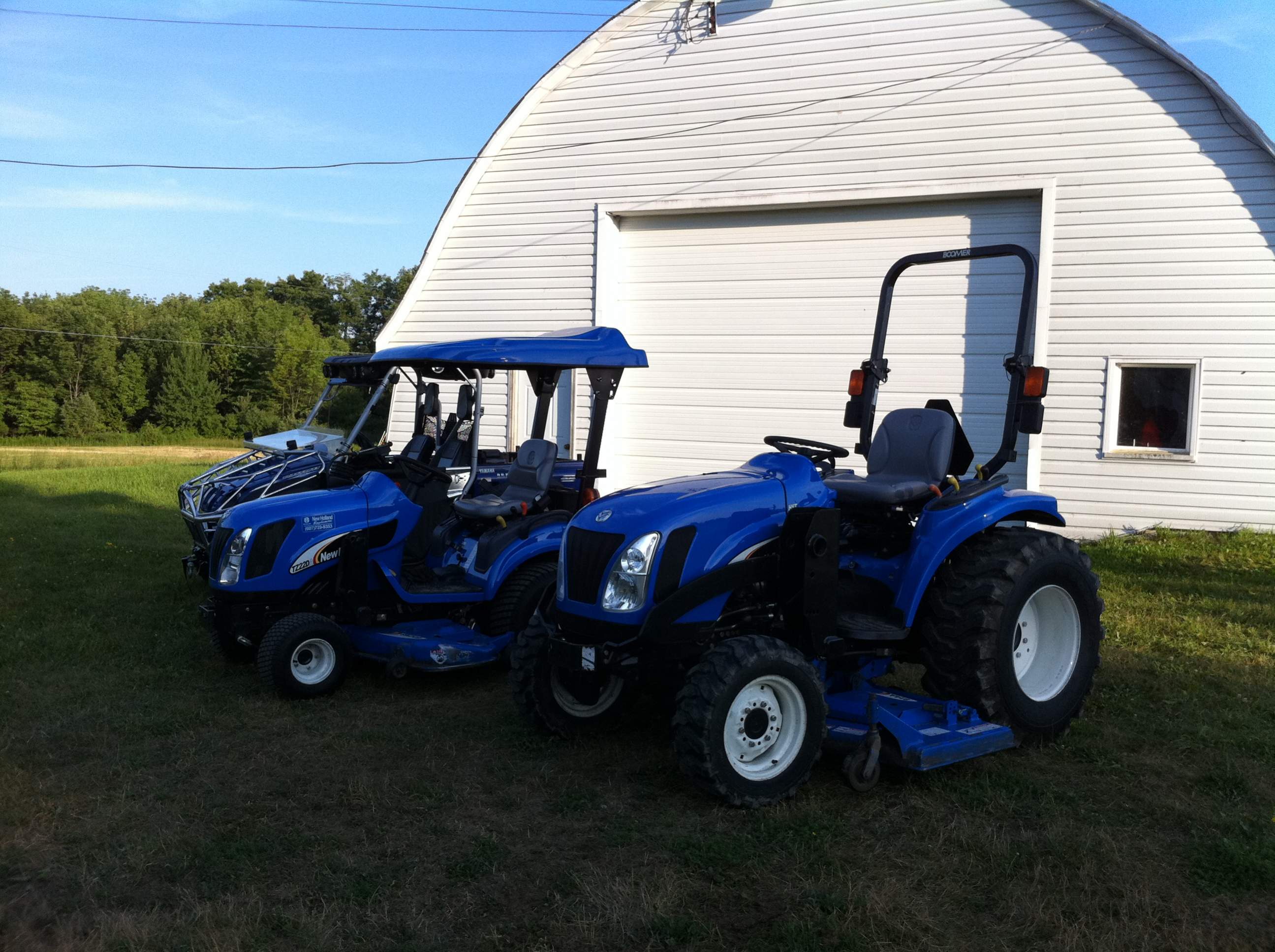

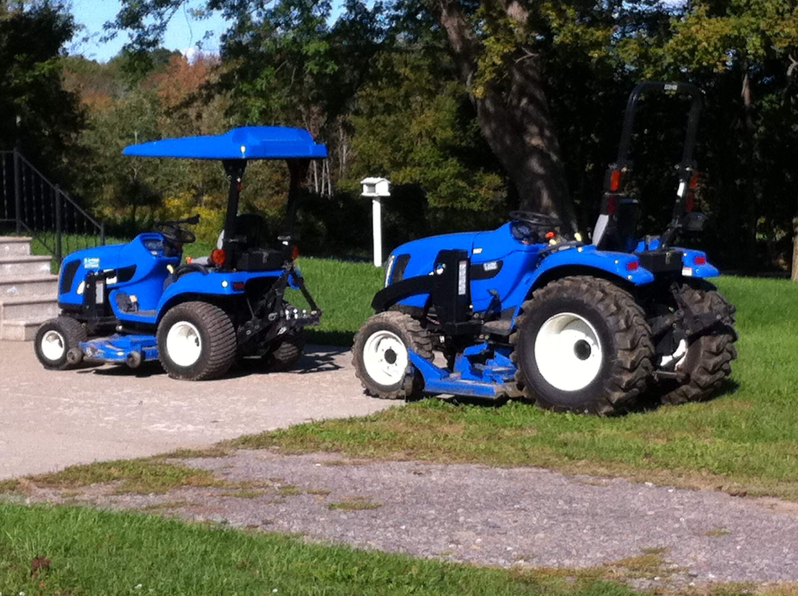

bugs, I am considering the same for my TZ22da New Holland Boomer. I have already a firebird fiberglass top on my ROPS. Have you had any issue with visability.. My only concern is trying to see through the windshield and snow or then melted ice from the heat of the tractor inside the cover.

Do not know if the blowback snow will stick, but the others that I copied from say the snow does not stick and it is quite cozy inside. The sides of the golf cart cab are only 58" long so if you use the fiberglass top the sides may come up short. I made the height of mine about two inches above my head when I am sitting on the seat. Works fine for getting in & out.
