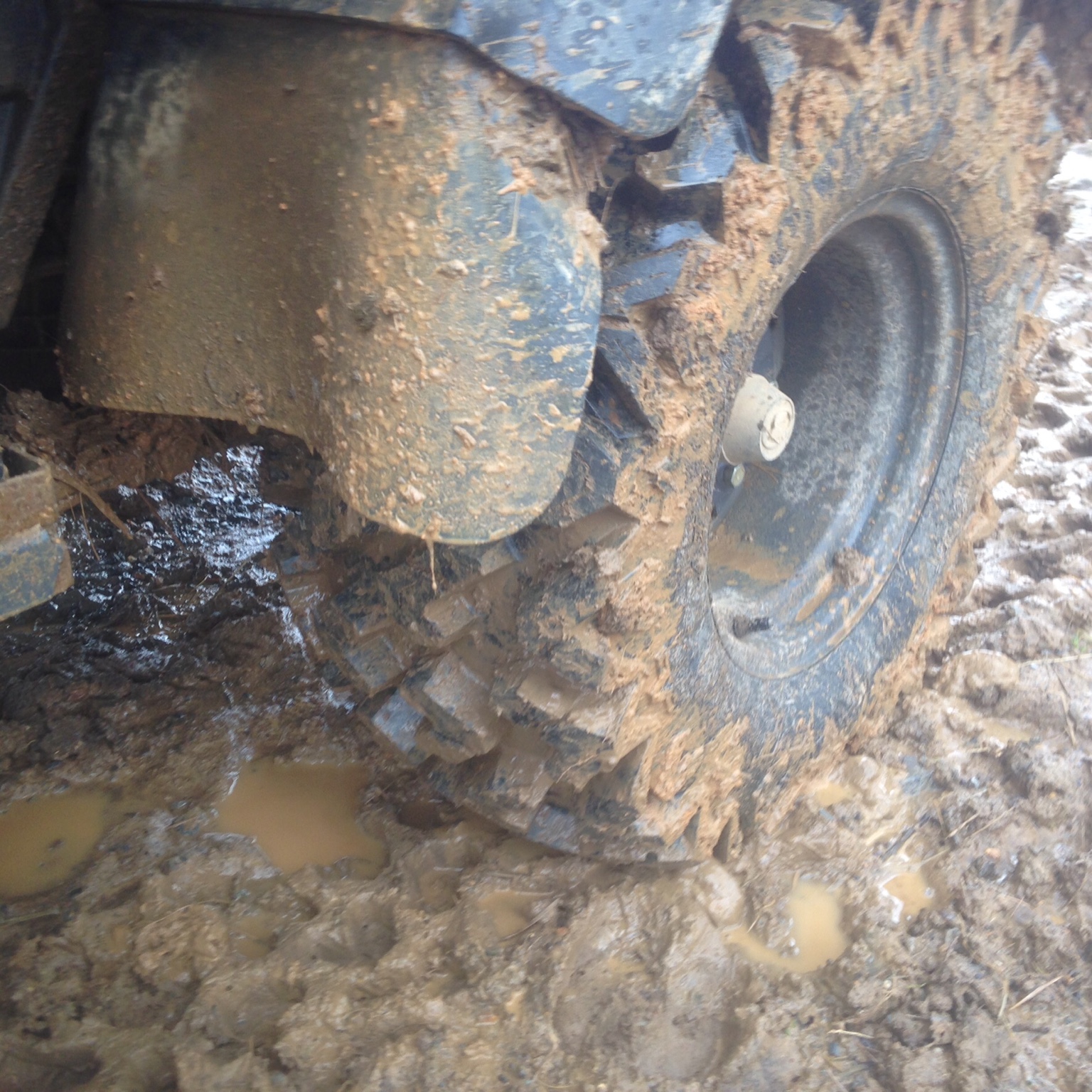

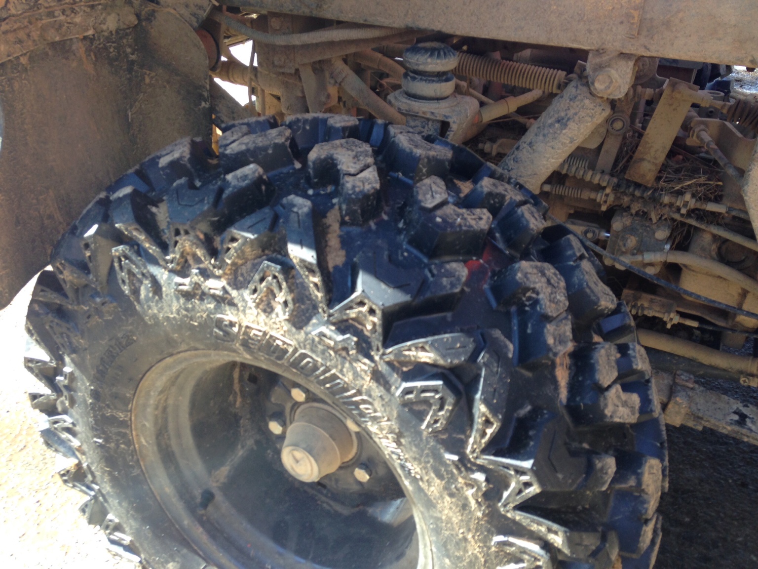

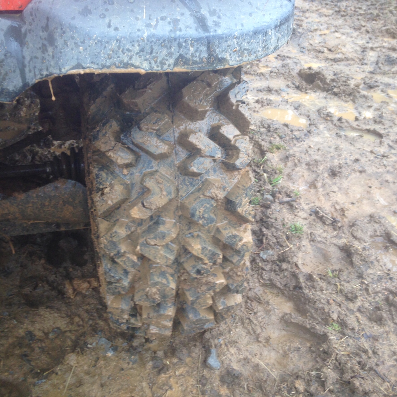

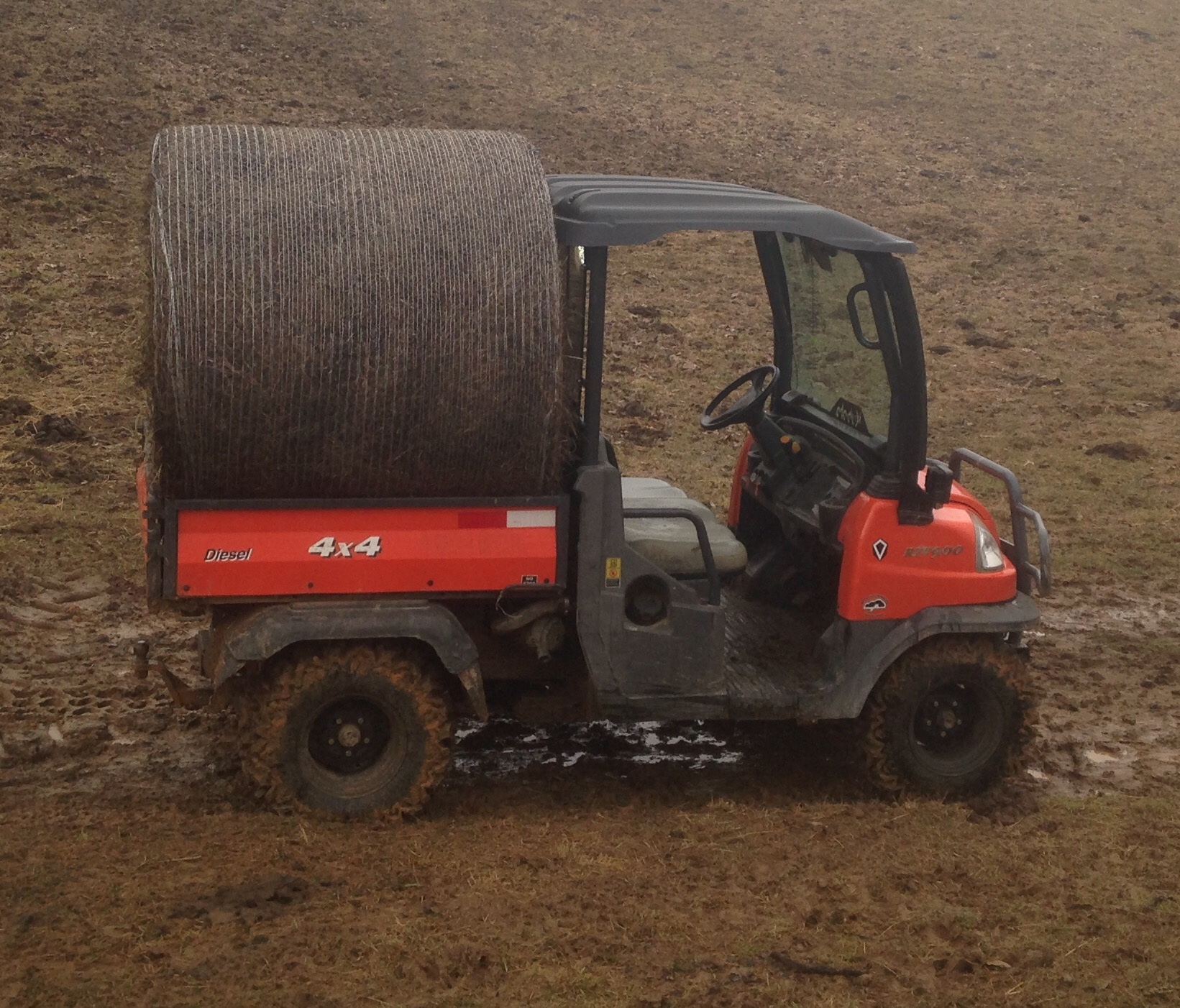

After my worksite tires wore out on my 900 I bought Sedona Rip-Saw 26x9x12 front and 26x11x12 rear tires. A buddy had these on his 900 on his mountain farm in winter and I was very impressed with them so I ordered the exact same as his.
They have a 1 1/8" of tread, I run them in mud, snow, pasture, gravel and on the paved county road between farms (every day in winter and often in summer) I can't tell they've worn at all over a year later.
They are a bit heavy and I lost some acceleration but the added traction is well worth the trade. They go better in 2 wheel drive than the worksite tires do in four wheel drive. They ride well even on the road and I've regularly hauled more weight than the RTV is rated for with no problems. They are taller than stock but there are no clearance issues, when turning or otherwise.
I realize you said you didn't need a aggressive tire but these wear so well I think you'd like them. I bought a used set of rims and was going to buy a less aggressive tire for summer use but these wear, ride, haul and handle so well I never got any.
If these ever wear out or I trade machines (more likely), I will buy another set.
Edit...

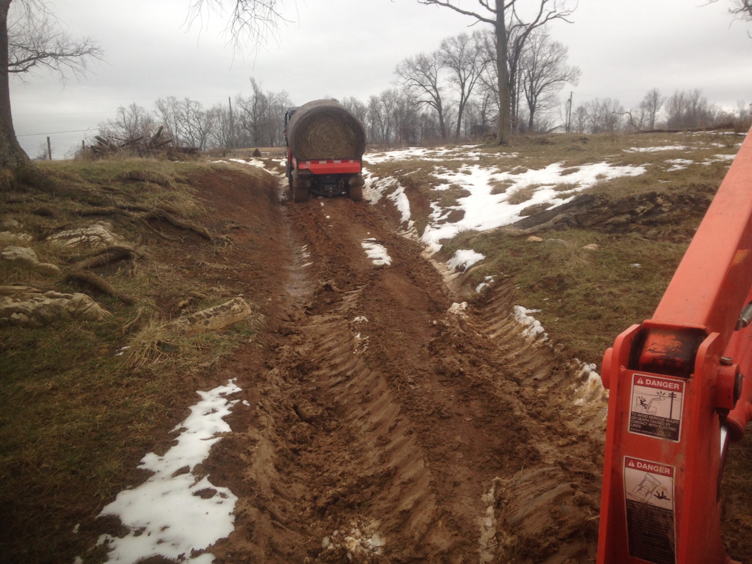

Dug up some pics.
In this last one I had followed her up part of the hill with the tractor expecting to need to push her through these ruts. Nope, she just kept going. I backed up and grabbed my phone to take a pic because I couldn't believe it!

Thanks DT86, I will take a look at the Rip-Saws. Great review and photos--thank you!
