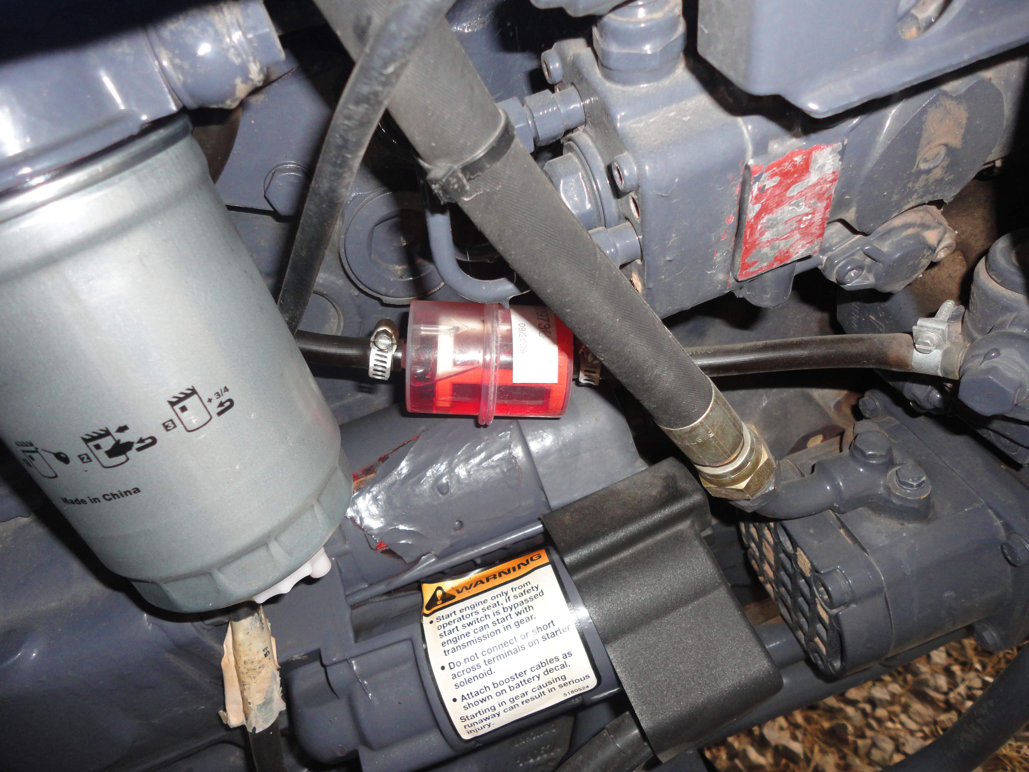

one other thing you might consider putting a extra fuel filter in the line going to pump i took a pic of mine. these pumps are very expensive to fix or replace. DSC00483.jpg

one other thing you might consider putting a extra fuel filter in the line going to pump i took a pic of mine. these pumps are very expensive to fix or replace.<img src="http://www.tractorbynet.com/forums/attachment.php?attachmentid=317097"/>
What happened with your pump? I've not heard of anyone else having pump issues from bad fuel.
