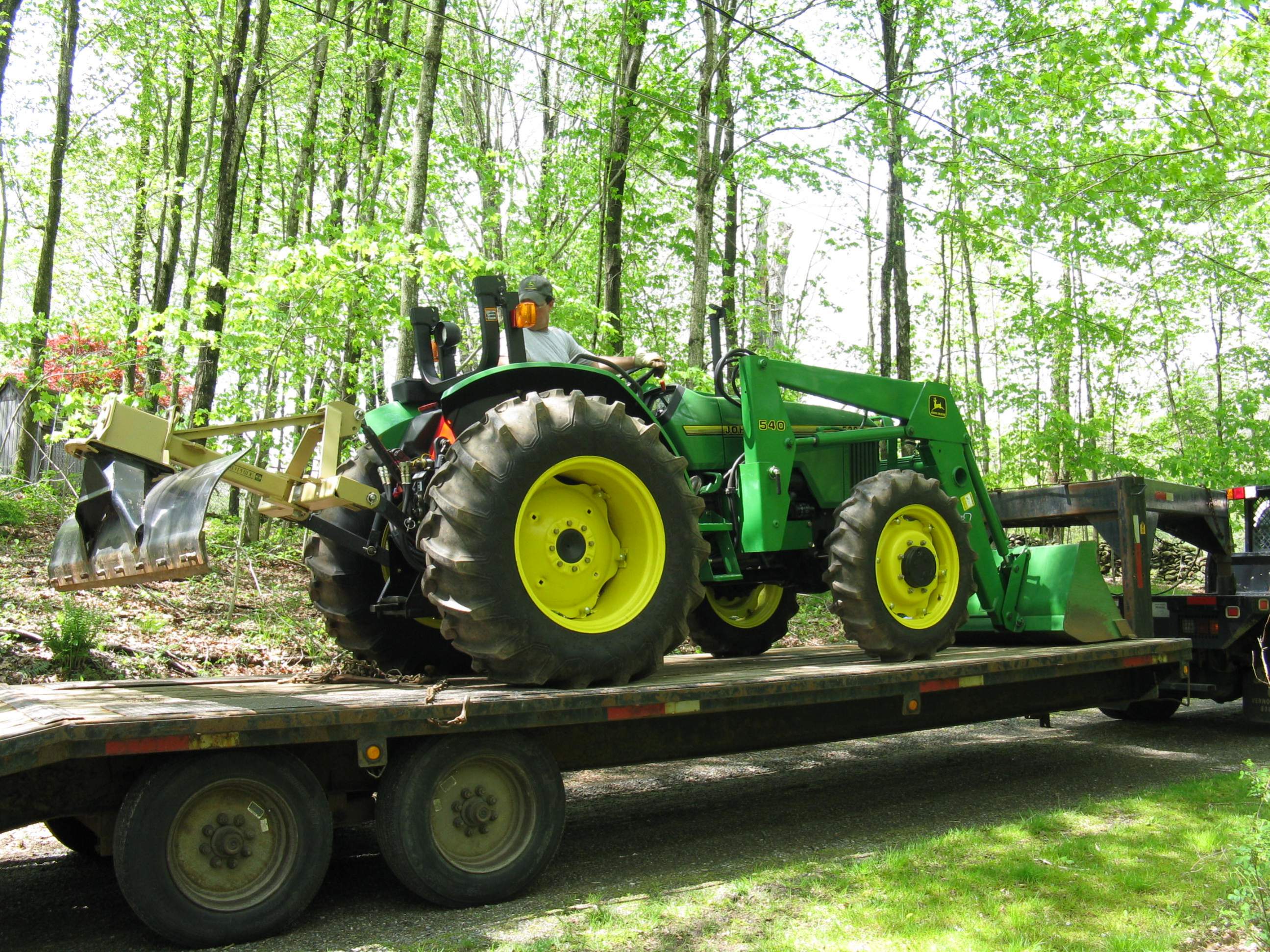

I started out similar to you as far as type of projects are concerned in 1992. Bought a JD5200/MFWD with 16.9-28 rears, 9.5-24 fronts and a 540 loader, loaded rears, box blade, rear blade and 6 tooth scarifier. That combo had a scale weight of 8900 lbs. Never had a problem with it for the 17 years I used it. For the rough ground work you're planning I think the 5055 will do everything you want.
Not familiar with 553 loader, but be sure to get attach bucket feature. Although JD is OK, if they offer a skid steer mount get it instead for greater choice of implement options...forks, grapple etc.
