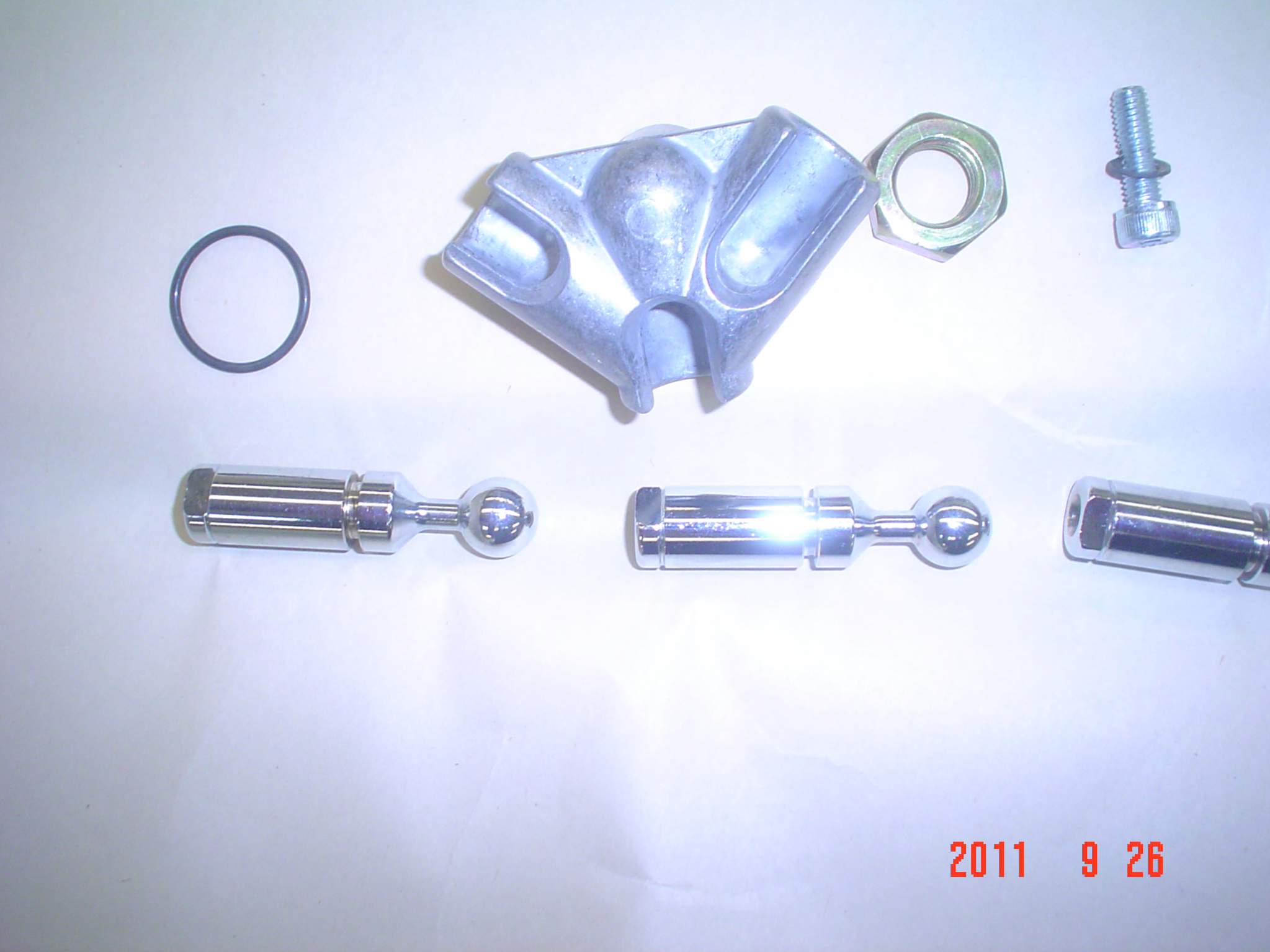

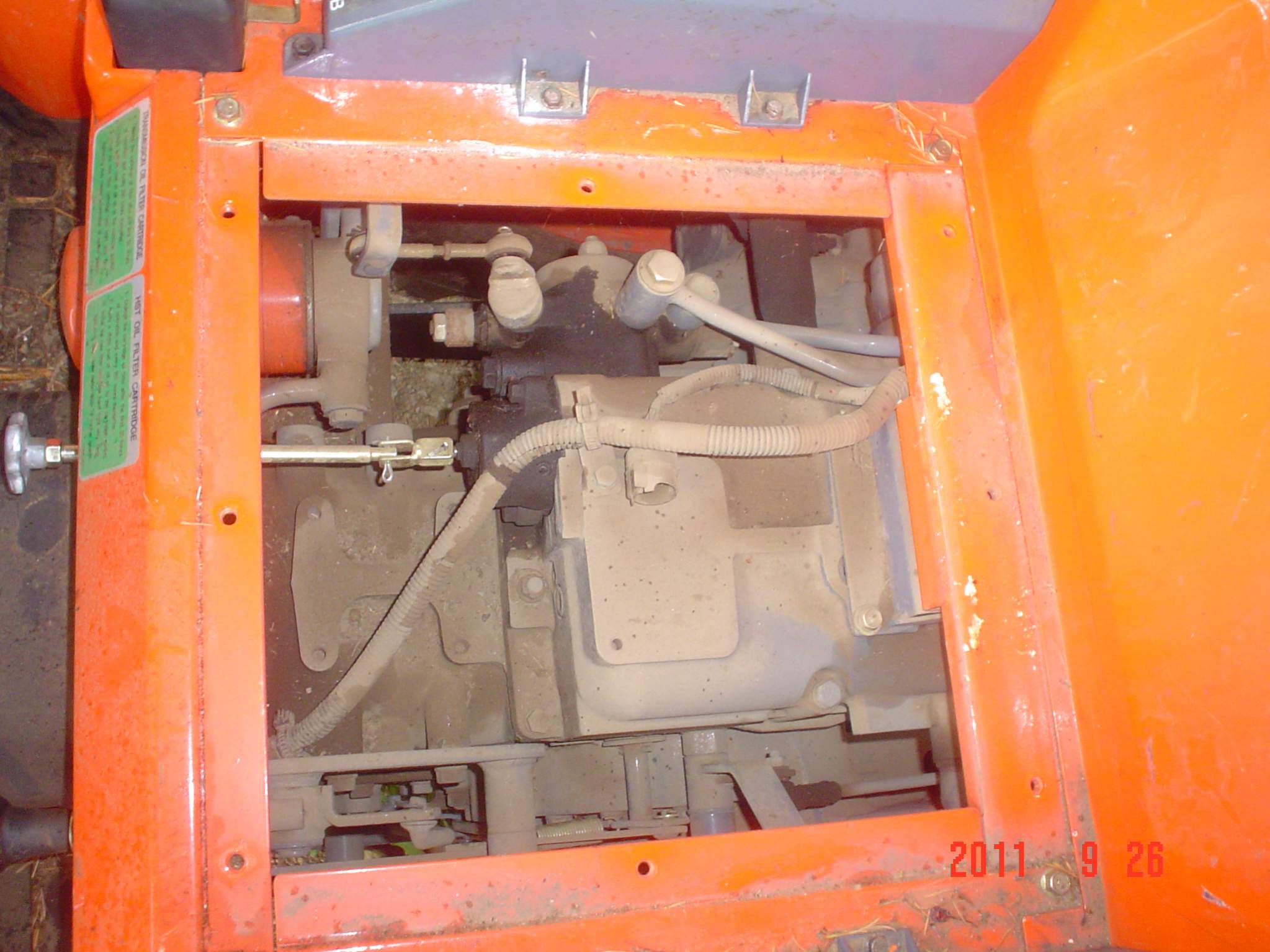

Hello I have been an occasional visitor here for several years. I have found it helpful to look over your posts in the past.
I have a Kioti CK30. The joystick for the bucket is broken. I have the replacement package. I cannot figure out how to install it. Here is what I found on another thread posted by 1wheeler 1:
Part Number is Daedong 26001-0090 Cinematic Kit. Since I didn't have a manual installing it the first time was a learning experience. Here's the overview of how I would do it again with what I know now.
1. Removed the seat for easy access
2. Removed the two bolts that attach the joystick assembly to the body.
3. Once the joystick it detached from the body the rubber boot can be removed.
4. Remove the joystick lever and boot.
5. Remove the allen bolt under the assembly that holds the fixed pivot point.
6. Loosen the lock nuts on the cables attached to the assembly.
7. Screw the cable adjustment threads on the cables into the assembly until the fixed joystick pivot part that attaches to the joystick assembly with the allen bolt is raised enough for the fixed post to be removed from the main assembly and removed from joystick pivot altogether.
8. Remove the pivot part from the other two pivot balls attached to the cables.
9. Pull the cables down through the entire assembly and remove the old ball/posts.
10. Install the new ball/posts on the cables and reinsert back through the whole assembly.
11. Then pretty much reassemble in the reverse order.
I am stuck on #7. Does the fixed post come up out of the top of the assembly? Then the other two posts slide down through the bottom of the assembly?

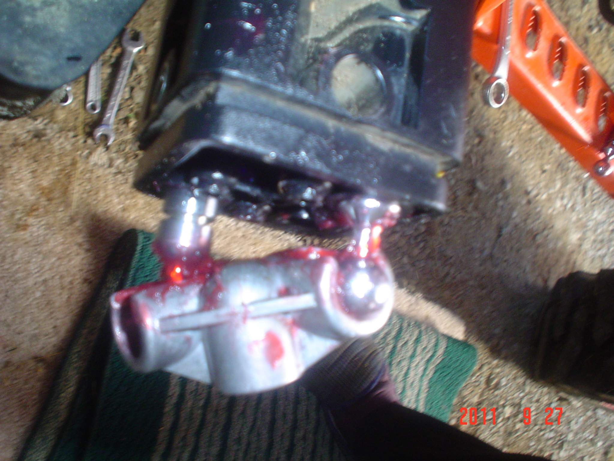

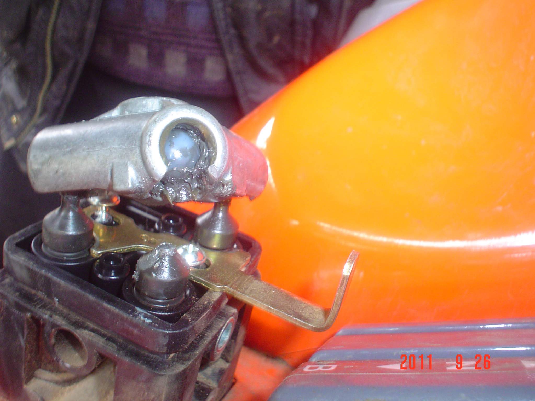

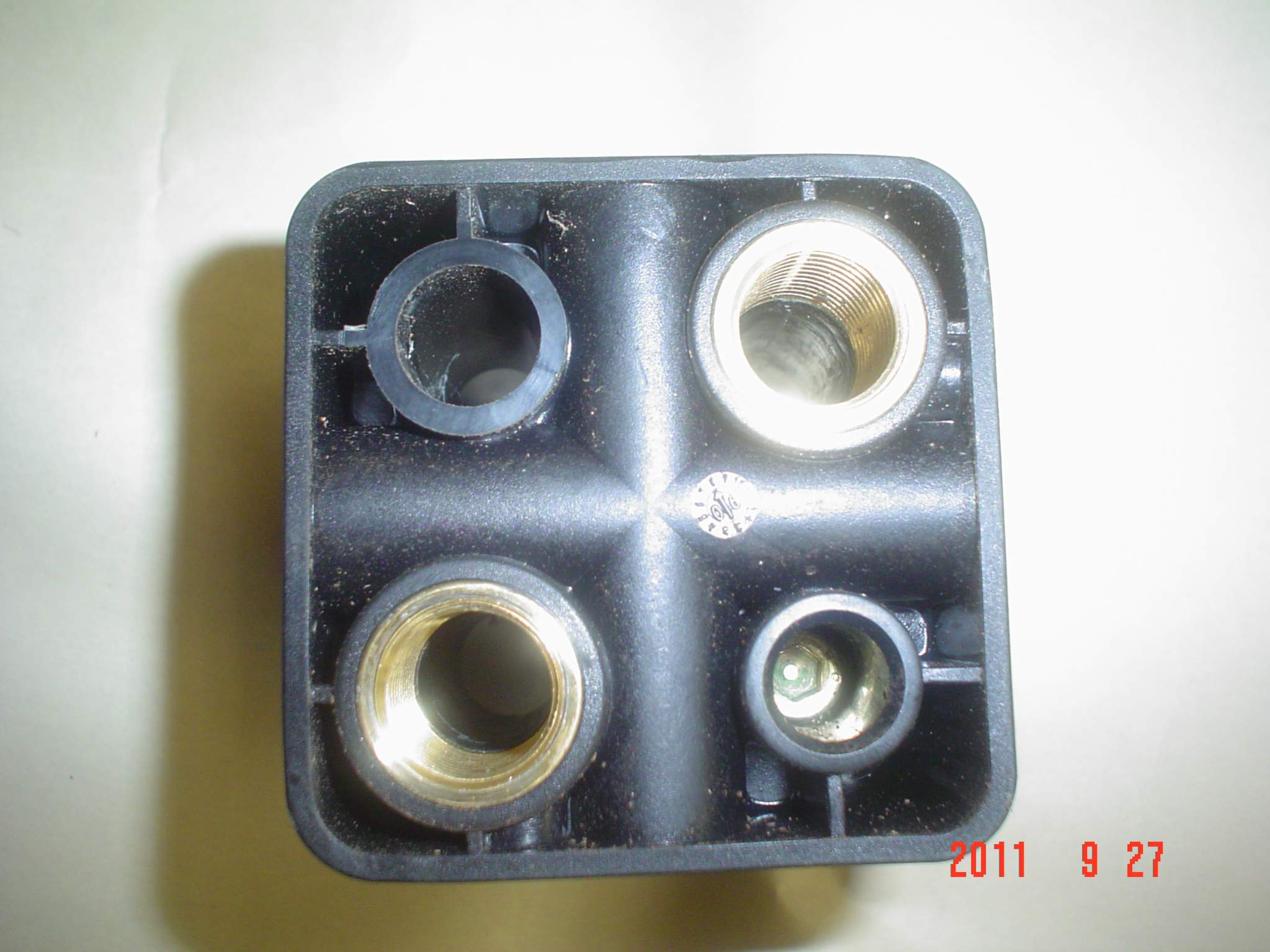

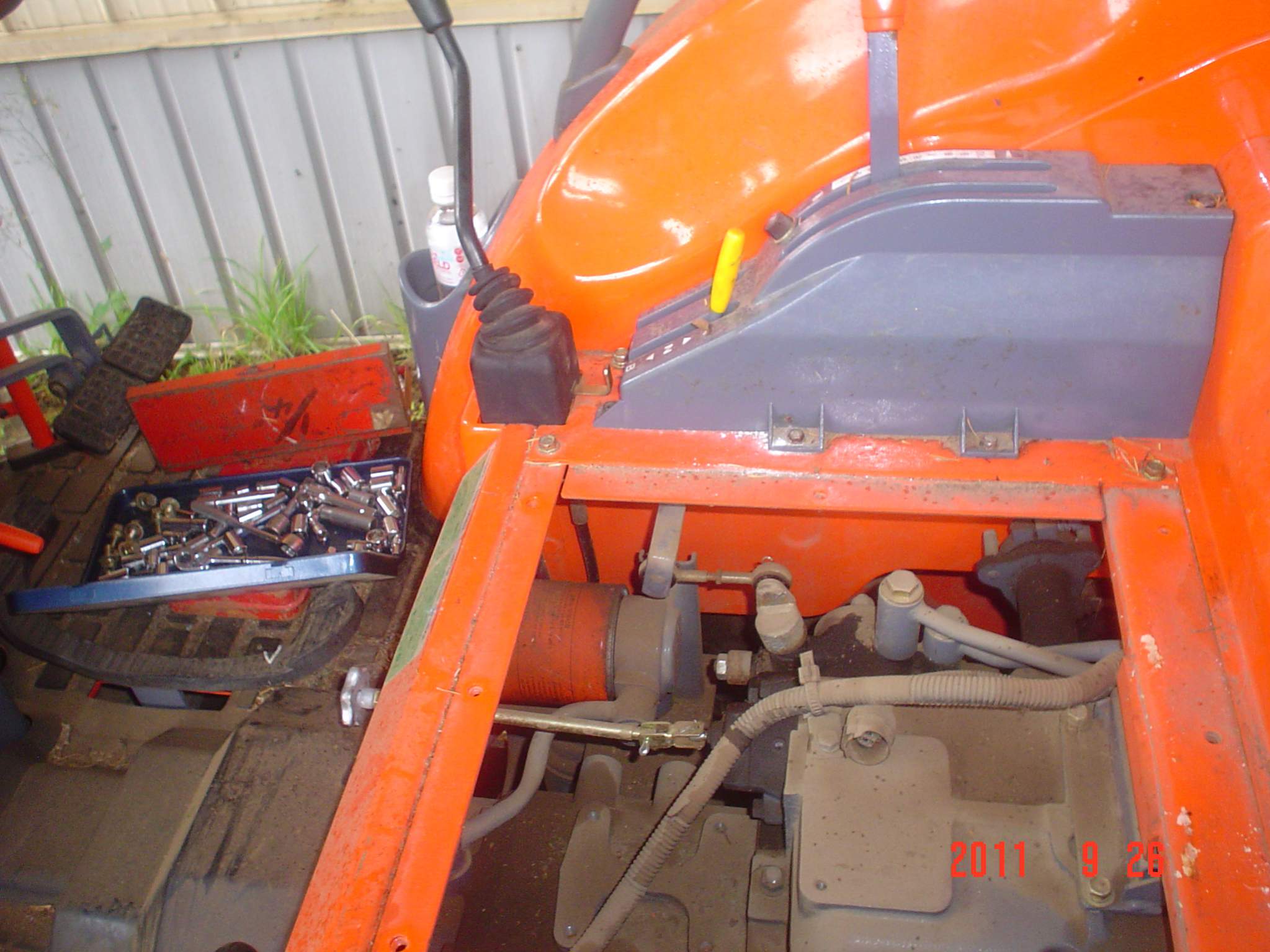

Thanks for the welcome. I have mine torn apart in the driveway, so I don't think that I will be taking it to the dealer.

Mousefield, I was able to get the stationary post out. I still do not know exactly how to remove the other two. How do I disconnect the cables? I turned them in quite a ways. There is still 1/2 inch or so of threads showing. Do I need to turn them in more?
   / New to forum, need help please
I got them off lat last night. Thank you for the help. In looking for the answers here on some other posts I ran into some discussions about the float. Mine has never worked. Once I get this put back together, I might start looking into the float. It would sure be nice to get it to work.
