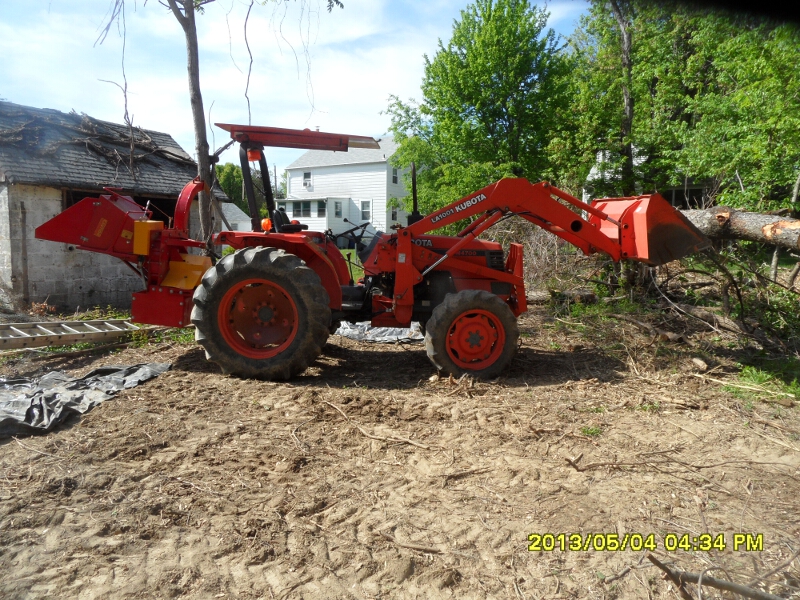

I've got 2 tractors, my CUT is a Kubota M4700 (~50HP, FEL lifts a ton, 3pt 2 ton) which is probably the size of what you need. My SCUT is a B7610 (23HP, FEL lifts about 700 lb, 3pt about 1300). My sawmill is a Woodmizer LT10. I cut lumber because I need trees cleared and shelving.
If $$ are tight look for a tractor that will carry your 16' log with the 3pt (about 3,000 lbs Timber and Lumber Calculators at WOODWEB )
Get 4WD.
Look at used.
My M4700 w/ ~1400 hrs cost me about $12K last year in January.
The chipper cost $1.7K new.
Good luck and where in Mississippi?
