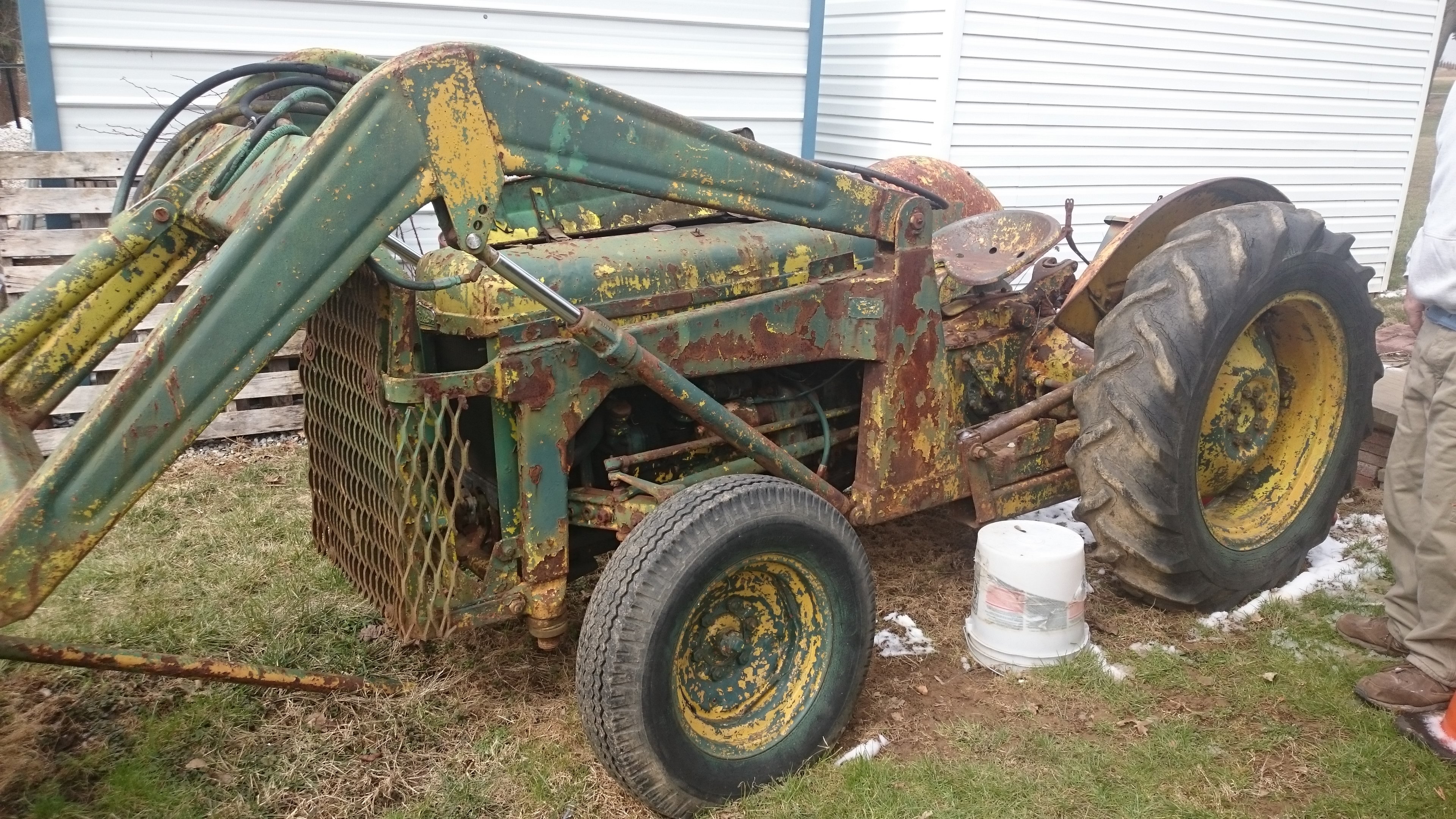

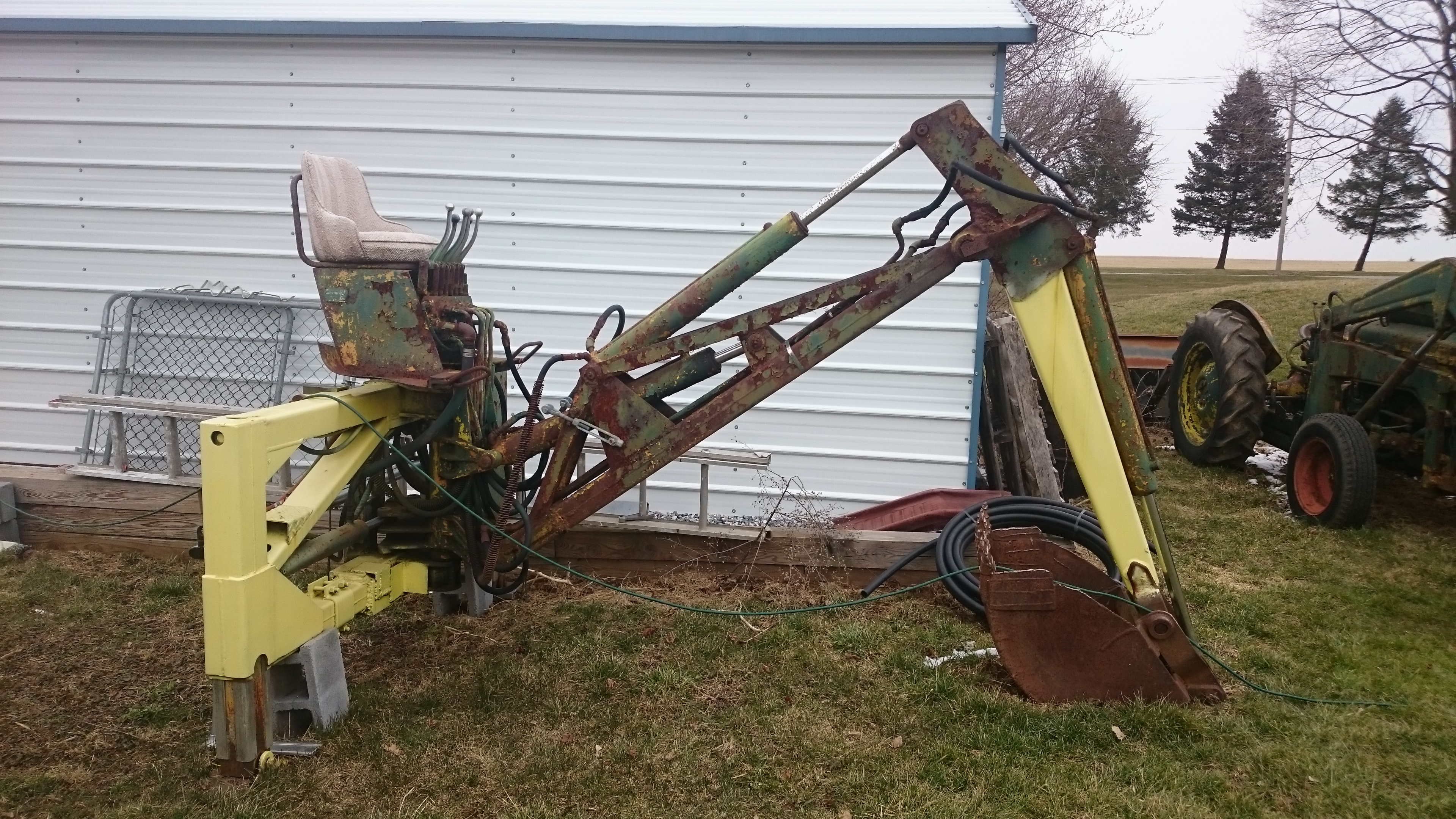

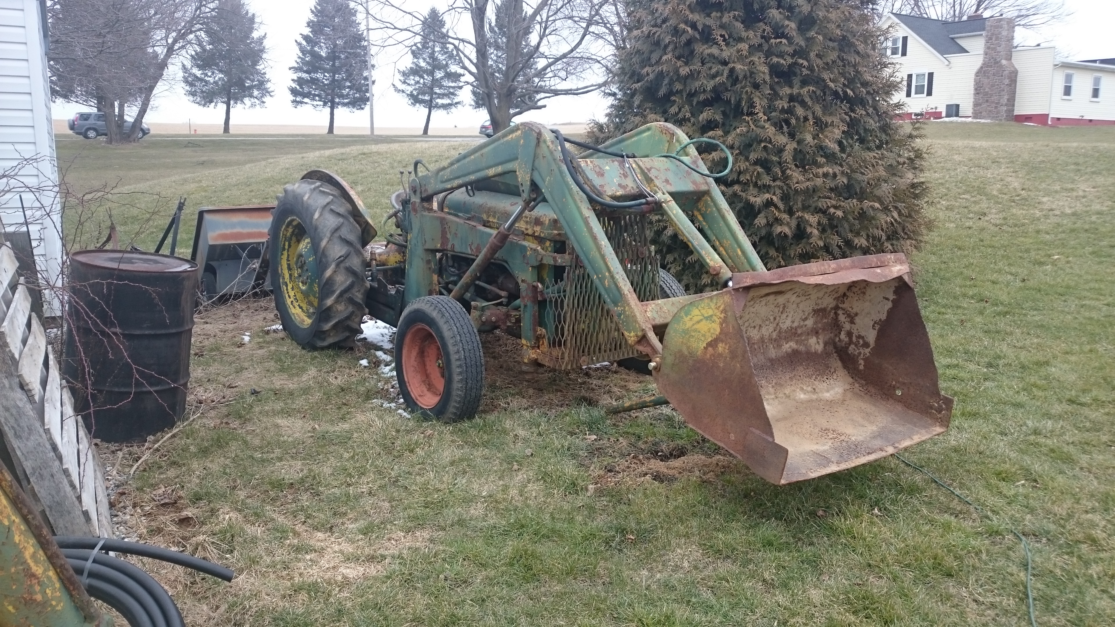

A fellow I work with is getting his place cleaned up ready to move. One of the things sitting around his property is this I think a Ferguson TO35. It starts right up and the hydraulics work. I am new to a tractor like this and am wondering what I am getting into? Serial number is 169381.

G'day looks like a good ol jigger if you do buy it then before you move the backhoe get some 400 wet and dry, wet it with some diesel or kero and rub the rust off that top cyl before you retract it you might just save the seals the rust will cut them out in a couple of strokes.

And keep an eye on that bottom cross member of the backhoe, it looks to have been poorly welded at some point in time, check it for cracks. May not be a bad idea to grind it down and put a fresh, good penetrating bead down all those joints. Looks a bit sketchy. Otherwise, I love the setup! It has lots of character! :)

Nice looking old tractor.
If it's running, don't fix it. Just do the normal maintenance (fluids, battery, etc).
Take a good look at the wiring. Rodents may have been busy chewing the insulation.
Serial number says it's a 1956 Ferguson.
This would be a good find for restoration, if I were still in that business.
Don't often find a tractor in this good shape with both a FEL and a BH.
Enjoy your tractor.
Good luck
