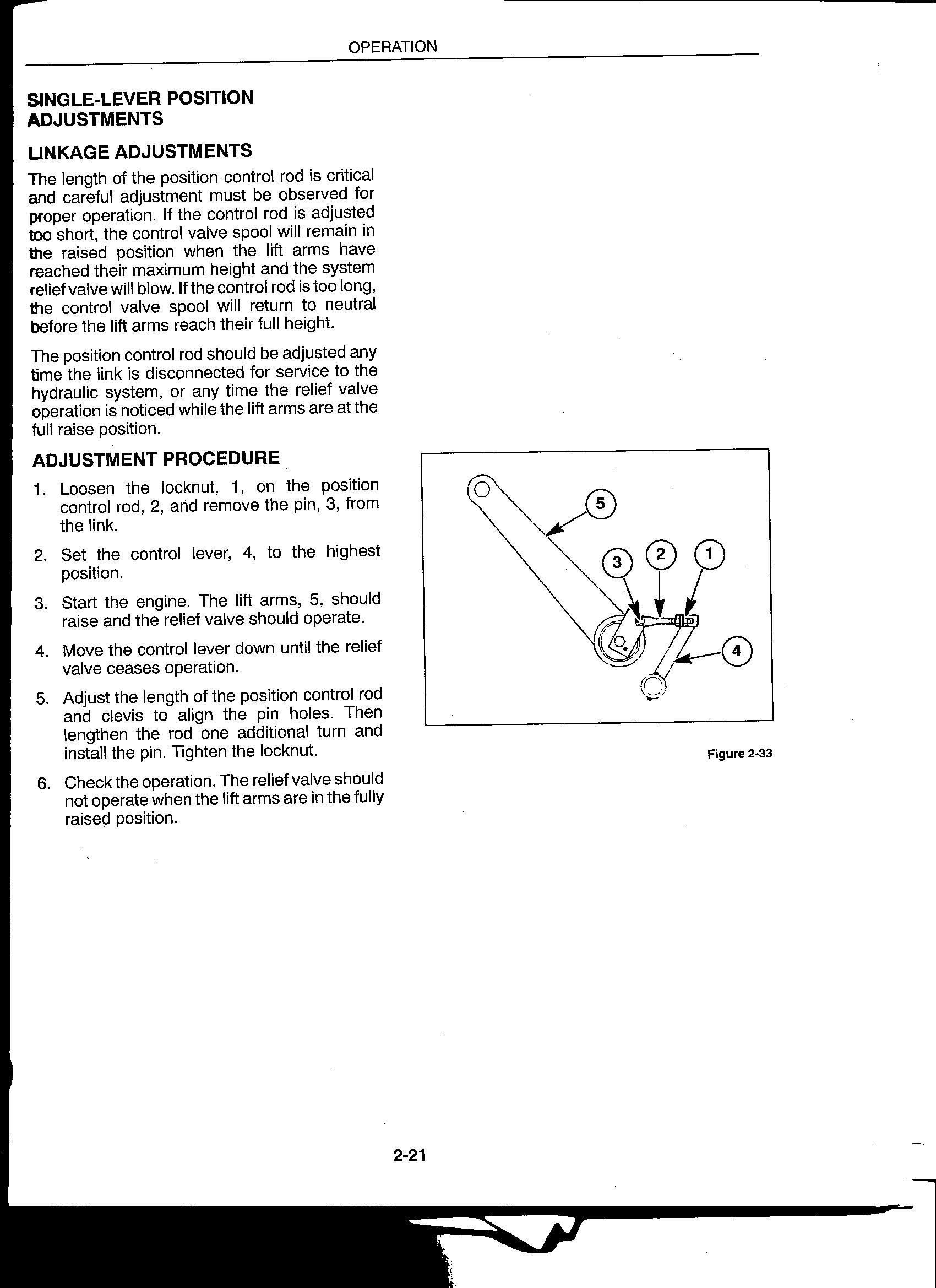

Only issue I had when hogging, was the 3 point lift was touchy. Jumped right up but wanted to drop all the way when I tried to adjust to the mowing height. Real twitchy when I tried to dial it in. Just a bump and it would jump up or drop to low. Once I got it set where I wanted it, it stayed at the right height. Any ideas?

There is a control valve just beneath the seat. Rabbit/turtle symbols. This adjusts the flow rate of the TPH.
Mine is still pretty tight however, small movements get the results I need.

I have a 2001 TC29D it does not have the turn signals. I just the dealer adjust my 3 point hitch. I tried and failed. No matter what I did I couldn't get it to stop moving around.

Here is a copy of the page from the manual concerning the adjustment of the 3 pt hitch linkage. I have posted it before but it has been a while. Hope it helps.

Thanks, I'm not the most mechanical person so plan on inviting a friend who is to stop over and between the two of us will take a swing at it.
