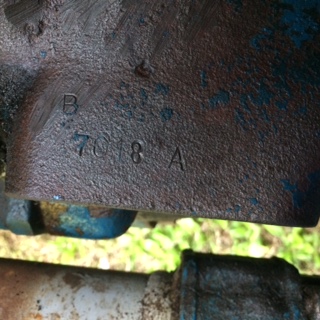

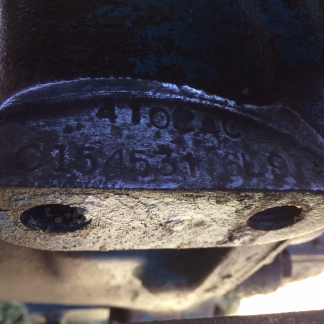

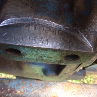

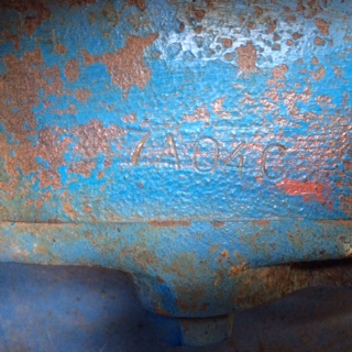

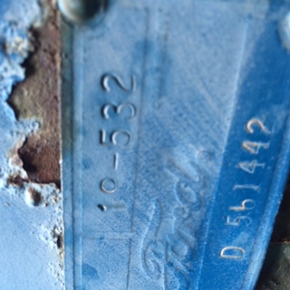

Recently purchased what is suppose to be a 1967 4000, it has some issues, but I do as well so hopefully we'll get along. The pad near the starter shows IMG_1946.JPG which seems correct but is a diesel manual says should be gas. On the left it shows IMG_1948.JPG not sure what that means. on the center of the rear I found IMG_1950.JPG which I also have no idea about. It also has a 19-532 IMG_1956.JPG loader scabbed on it which is fine me but needs work as wel.
1) What do I have best anyone can tell?

John, it's a 4100 (4000 series), originally with gas engine, but obviously swapped for diesel. The PTO is independent, wet clutch in the rear end. PTO brake is worn out or the whole PTO clutch has worn causing it to turn constantly and possible source of the whine.
19-532 loader is a 730 series loader.
Engine serial number and date code located on the RH horizontal middle of oil pan or on the front RH vertical of the engine block where it bolts to the front bolster.
Also, the year code 6L... indicates that the basic tractor is a 1966 (6), November build (L)
The rear axle housing number is the date code, 1967 (7), January (A). It doesn't mean much and is not normally used for parts or anything.
