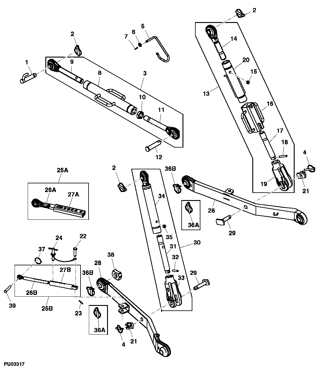

I recently purchased a 2004 4710 Deere with a 48 backhoe and need to know what parts/links/bars I will need to purchase in order to attach my brush hog. I did not get any other parts with the tractor and wanted to see if someone on here could share their tractor expertise with me. All I know is that its a Cat I. Would anyone also know the part #'s to any of these?

Go to John*Deere Parts Search your model number 4710. Do a selectional search. You should be able to find pictures and part numbers of everything you need.
   / new to me Deere 4710 need 3 pt parts #3
Several 3pt hitch parts, depends on your serial number. Attached is one example from JDParts

Thanks, the website is as detailed as you can get. What I'm looking for are the names/general part numbers of what assembled bars I need to connect my back blade and brush hog. I believe they are called sway bar, lift link and center link? Also, what could I expect to pay for those parts? I dont know if I am missing something, I'm quite ignorant when it comes to these details about my CUT!
