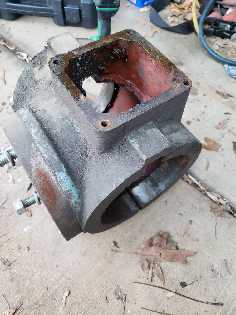

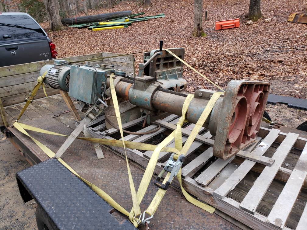

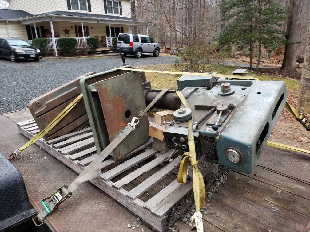

Picked up a large drill press the other day, wasnt really looking for another one but this one showed up on Craigslist cheap and nearby so I figured it was worth looking at.
The ad had a couple pictures but not much info, could it really tell what make/model but it looked to be a decent size.

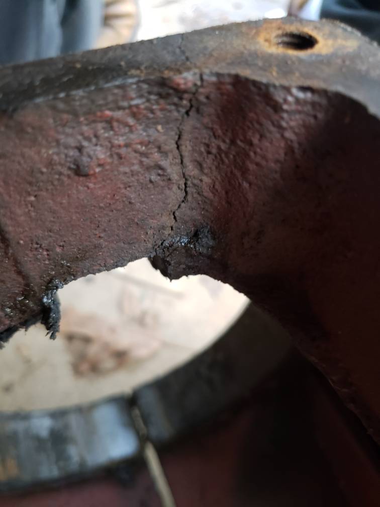

Turned out to be an older Enco branded Taiwanese unit bit its built pretty well, it's a 27.5" swing, power feed and 5hp. It's quite the beast, but needs a repair in the table to column mount casting.

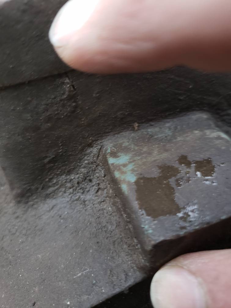

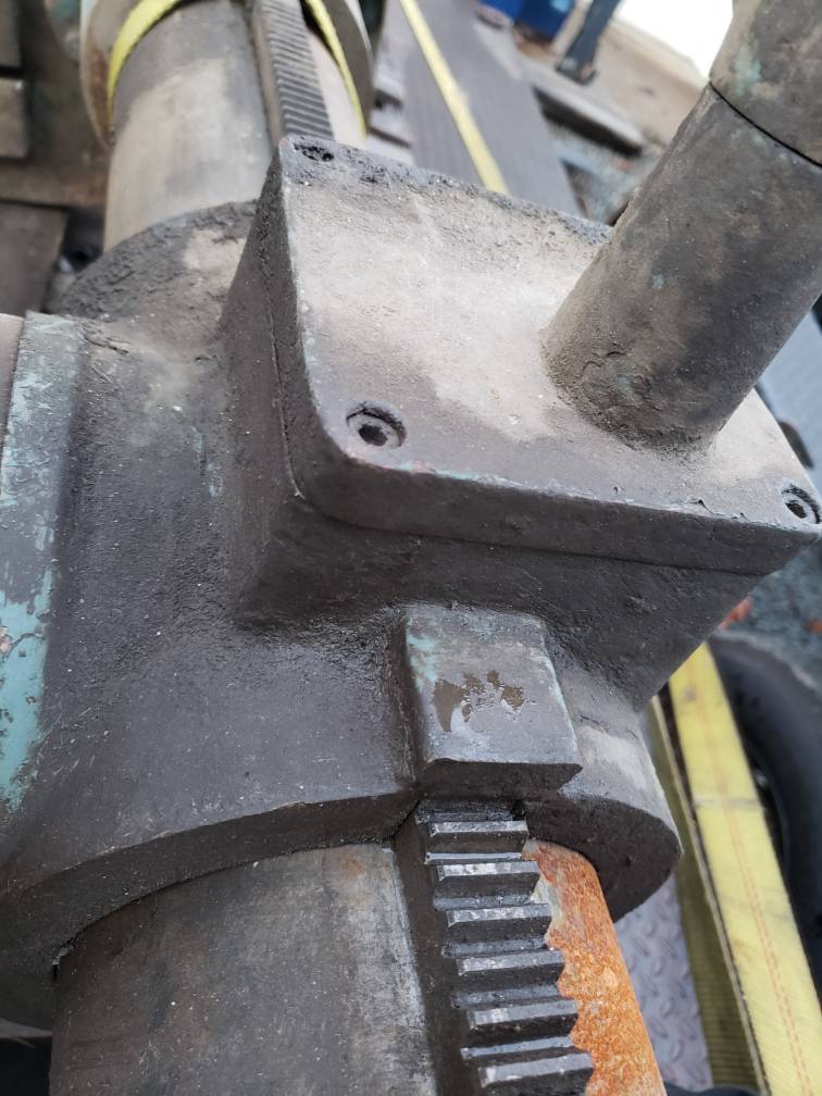

Apparently the collar was put on upside down from the beginning and eventually cracked, nothing major. I have it appart and will be repairing it once I get it cleaned up.
Torn between using 55ni rod or brazing, I think once the collar is flipped over it qont be putting as much stress on the joint so hopefully it shouldn't break again.
Couple pictures of the press when I brought it home and the cracked area.

I would drill small holes at each of the very ends of the crack. Be certain to completely ensure that none of the crack exists outside the hole radius. Doing so will stop the crack from propagating further. Then attempt the braze. For that matter, can you just drill the whole crack completely out with one large bit and not worry about it?

Crack goes from edge to edge so nothing to drill, it will get beveled. Going back and forth on brazing or using nickel rod. Based on my buddy that does this type of work all the time I'm leaning towards using ni55 rod, plus he already has some I can use :)
Got it appart, now it's time to clean it up and grove it out with a carbide burr.20190115_170230.jpeg20190115_170238.jpeg

I'd go Ni-Rod as well, you won't have to get the whole piece hot just take the chill of it. Wondering if some sort of clamp around the piece when you're done due to the shape and the way the stress will be. I know you had said it was initially installed wrong is why it broke but additional strength wouldn't hurt.
Watch the burrs that come off the bitt, one of those suckers put me in the hospital for a week years ago due to blood poisoning from a piece I got in my finger...........Mike
   / New to me drill press repairs
Yeah I hate carbide burr splinters, nice part about cast is it usually breaks up enough that you dont have splinters like with steel or aluminum.
I dont see a good way to clamp it but once its flipped over the cracked area will be in compression instead of tension and the heavier part of the casting will take the weight of the table.
