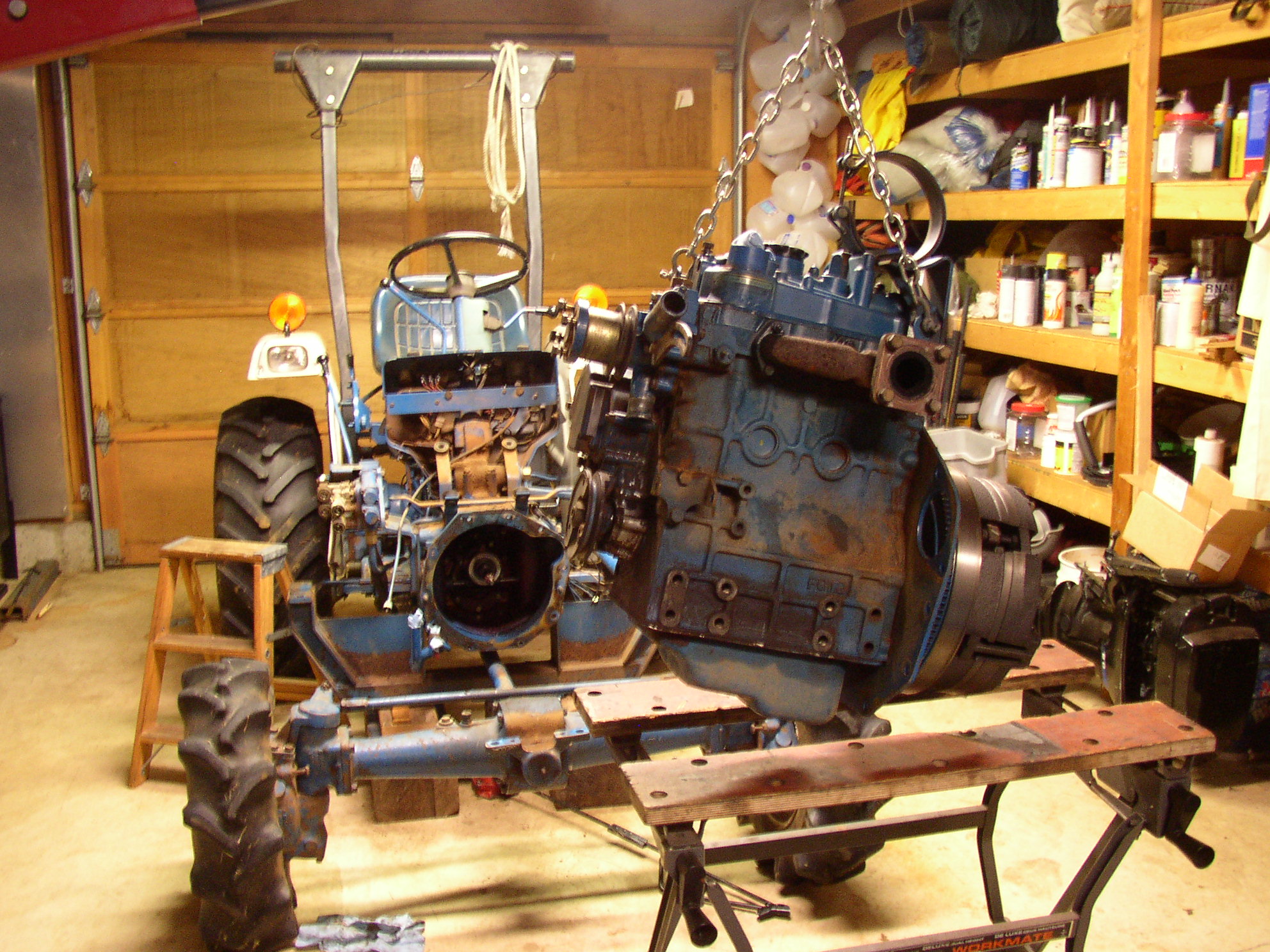

Was spraying weeds today with a belton 3 point sprayer and noticed a leak around the bell housing. Think my rear main seal is shot. Not looking forward to that one.
   / New to me Ford 1210 - Issues/Advice #9
I had the engine out of my year 1986 Ford 1310 back in 2006 and it was not really that big of a job.
Hopefully you already have the shop manual.
   / New to me Ford 1210 - Issues/Advice #10

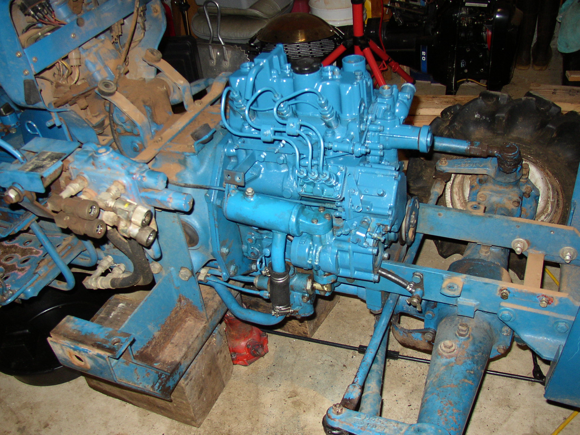

Yes, I have a shop manual. The problem is corrosion inside the bell housing. Mice set up camp in there for a few decades and severely corroded everything inside. Not sure if it will ever come apart at this point.
Here is a before and after from a few years ago when the resto was done.
