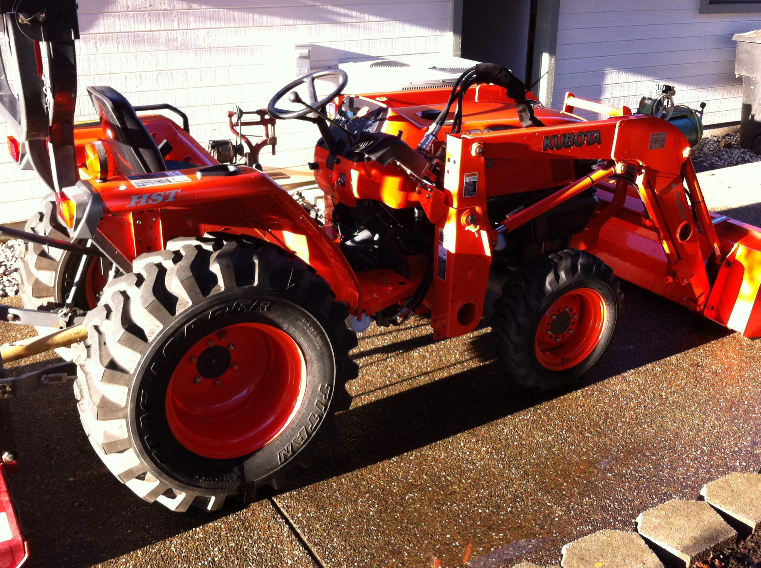

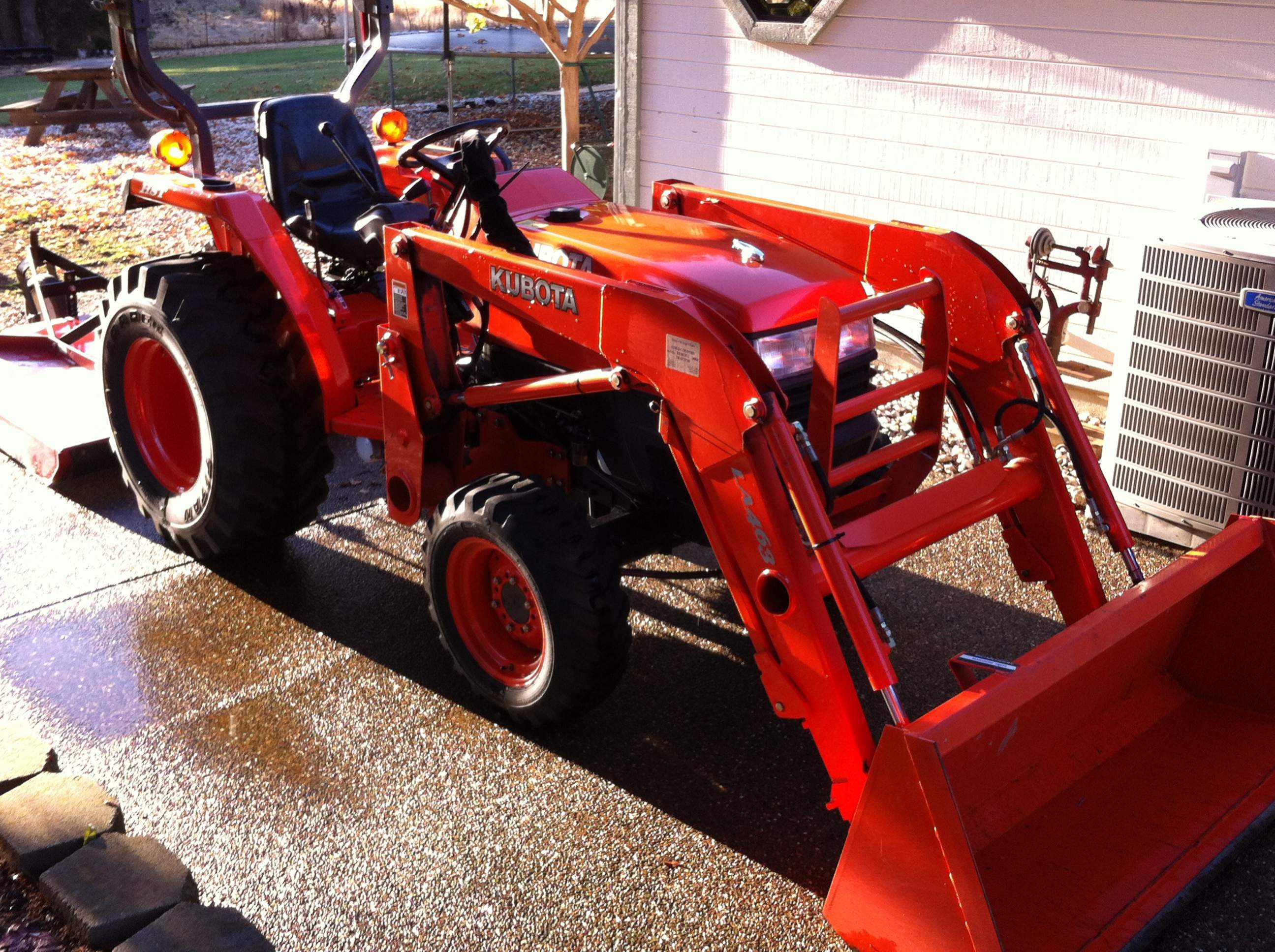

All good advice - I'll move it into the garage when I get home that has very flat level concrete and put a level on it, take some picuters, measure tow-in, make some not so crude measuerments and report back.
Added a few pics of new toy!
Thanks for the help.
Paul
   / New to me L-2800 and maybe a camber issue. #9
I wouldn't worry about it unless you think you are going racing in the morning. I would check the wheel bearings and the toe though.
Just a followup - found he left front tire was only at 12 psi and the right i presume at 40psi as it was standing quite a bit higher. Airing up the left tire seams to have corrected the problem.
Previous owner only used it about 15 hrs in the last 2 years so it makes sense the tires were low and he did air the right side up.
No issues on the axle - good:)
