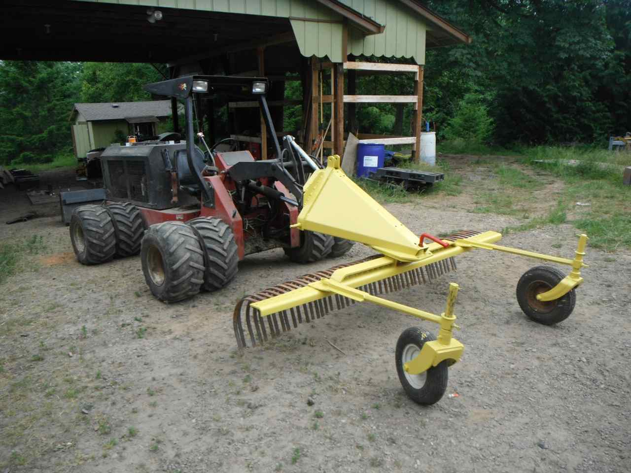

Got a very rusty John Deer Rake for $300. Not in great shape but it is a friggin rake so I got over the rust and gave the guy some coin.
Works like a charm. Drilled some additional angle holes and bobs your uncle.

You will get your moneys worth out of it. I use mine all the time....believe it or not, I even use it on an angle for plowing snow and it works pretty well. I like it better than my box blade for dressing my driveway. Its excellent for finish work on dirt and gravel. I built a rack to hold cinder blocks so I can have some down pressure on mine which really lets it dig into hard surfaces....you have the advantage of having it mounted on your FEL so you can control all the down pressure you want easily and even the ability to "curl" the tines which after all the way's I've used mine, can already imagine seeing that to be a great advantage. You'll be surprised at what all you can do with it. The only thing I would do personally is see if I could modify it so I could make the gauge wheel assemblies easily attach/detach. The only reason I say that is because I could see using it in ways where the wheels might possibly interfer. Great buy!
BTW...Your PT's got to be a brute. Every time I see a pic of it I realive that thing's a monster!
