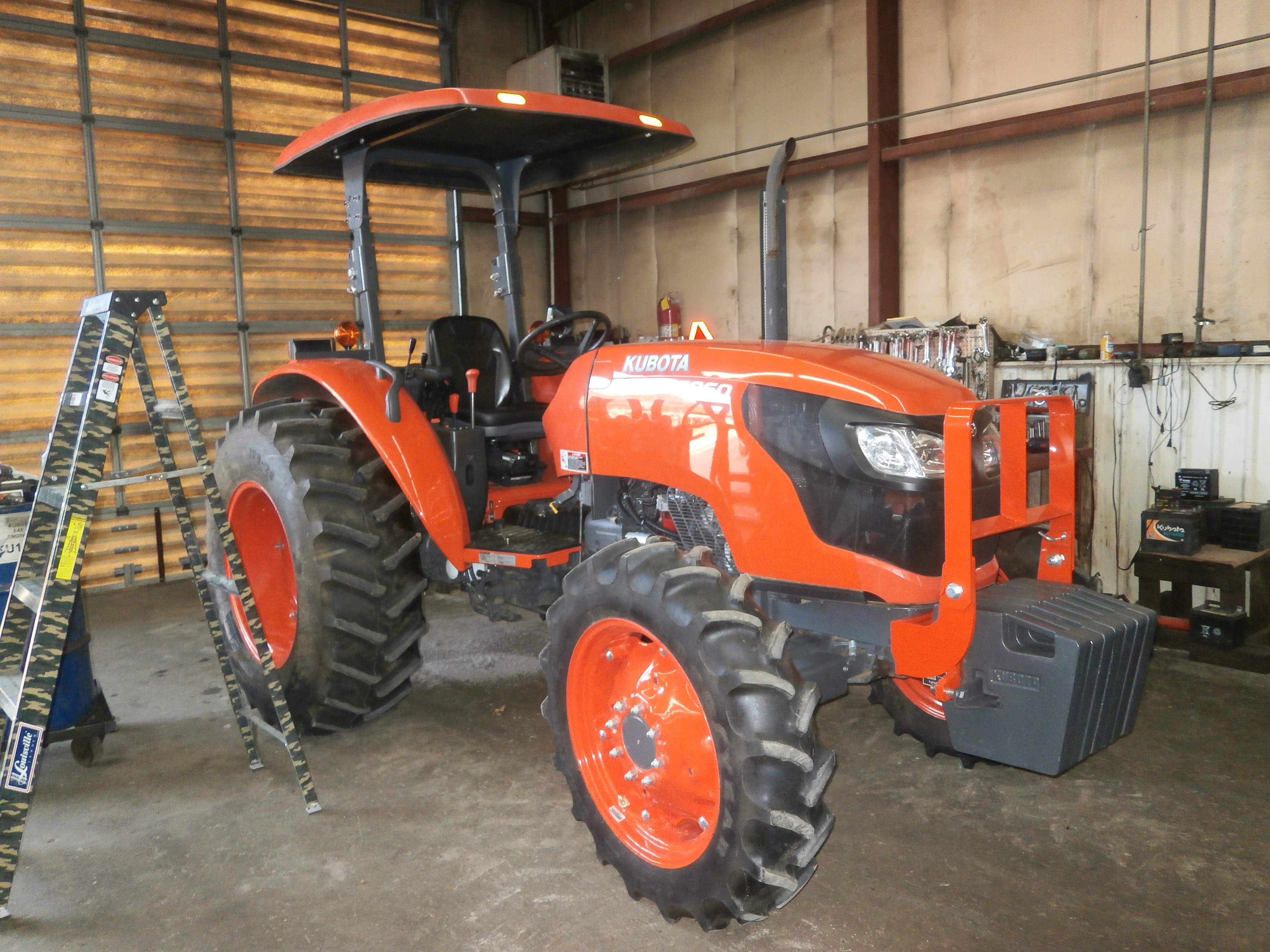

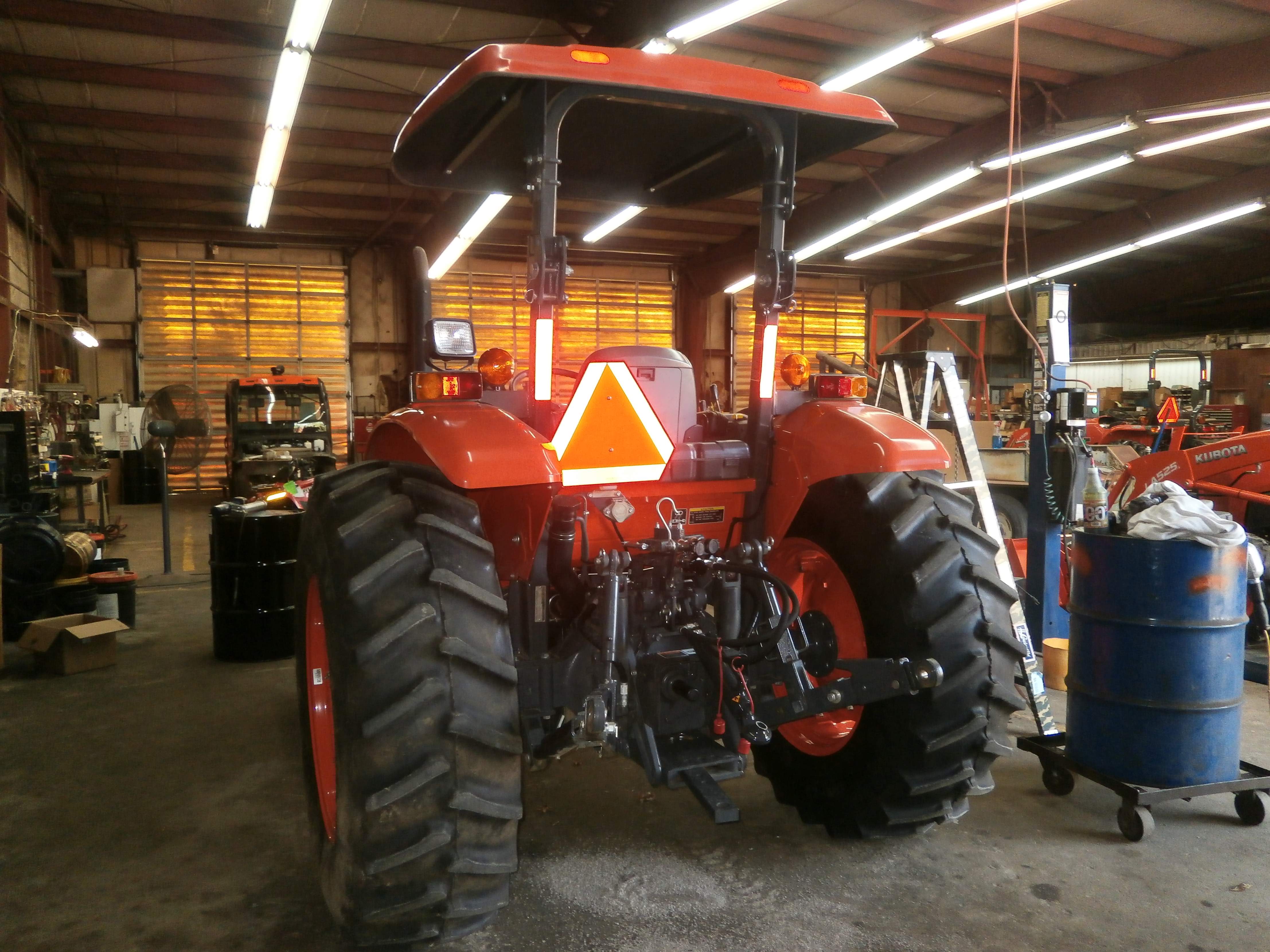

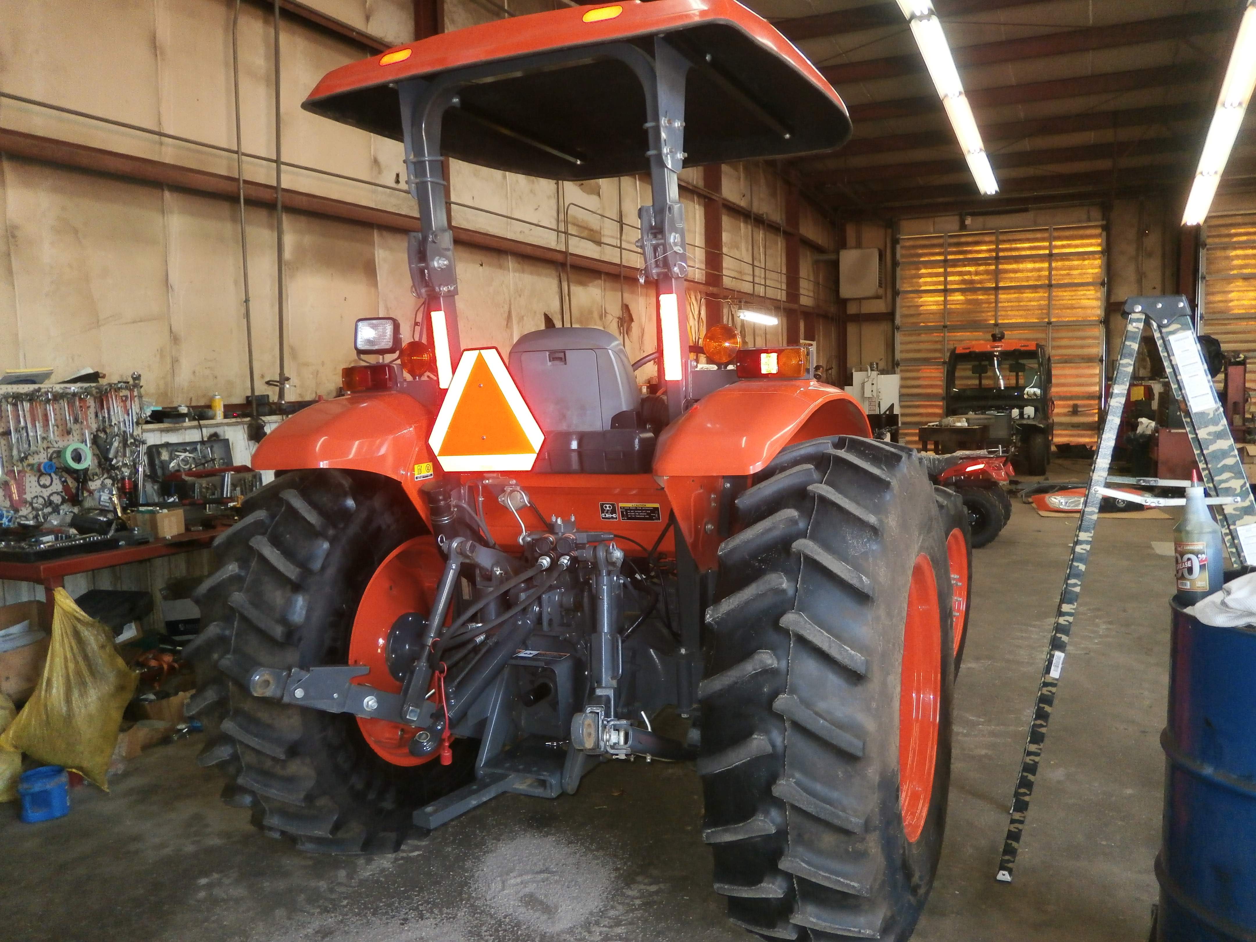

Here are some updated pics of my New to Me M6060.
My dealership has widednd the rears to 64", added a new Grill Guard and weights, and added my HYD Top Link.
Still waiting for my Landpride 8' Cutter to arrive.... hopefully it will come in next week.

Nice! Just out of curiosity, why widen the track? Row crop spacing? I assume hills are not an issue in Florida.

Wider spacing will give you a better ride plus stability.
By the pics it looks like your rears are set somewhere near the setting on my M9540. I like my fronts to be running the same width measured from inside of tire to inside of tire as the rears.

If your wheels are 50" apart and one rides up on a curb for example, you will lean further than if your wheels are 64" apart. Same thing with wheelbase. The longer your wheelbase, the more comfortable the tractor, all other things being equal.

Primarily used to bushog some large property areas we have, and to maintain roads, trails and food plot areas. We actually have alot of hilly areas in the area of Florida we live in. Our county is in the Panhandle, and we are the only county in Florida which borders both Georgia and Alabama.... lots of hills in this county.

The rears are set at 64" center to center which is the 3rd widest position, and the fronts are set at 60" center to center which is the widest for the fronts. This tractor will be used primarily for bushogging and maintianing our large property areas.
