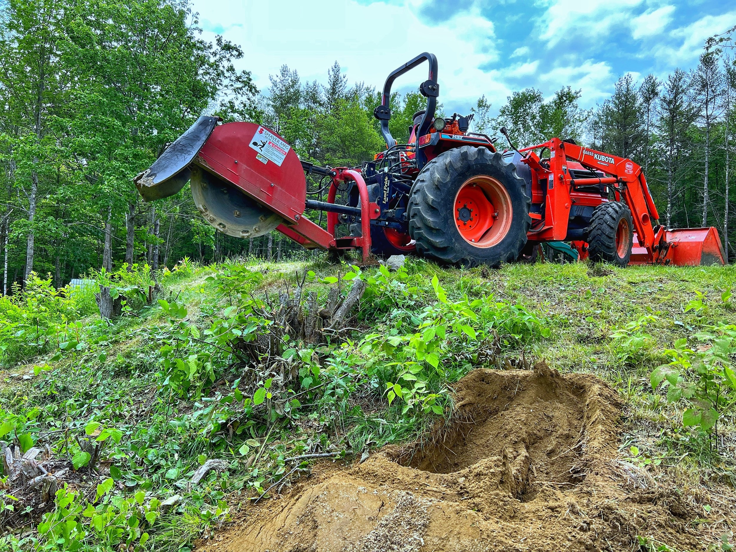

I'm willing to bet the shaver had the wrong teeth on it. I don't believe they ever came with the green teeth stock. Shaver has been making stump grinders for quite a bit longer than landpride and erskine. I do believe however, it's the same as the Wood's TSG-100.
These are the style teeth the Shaver uses Carbide Thumbnail Bit | Long Head | 2-7/8" Long | Fits Shaver SC50 / SC50-H Stump Grinders | Replaces OEM Part# SC-50-15
They are carbide tipped and although pricey from Shaver, they are found pretty cheap aftermarket. I bought some many years ago but I can't find where I bought them from, which is why I was asking on here. I think they were $8 per tooth when I bought them. I've had the Shaver Stumpgrinder for over 10 years now, and highly, highly recommend it.

Looks just like the Landpride I bought recently. One thing I did to mine was I punched a hole in the rubber deflector flap at the end and added a threaded screw eye so I can keep the flap up with a rubber tarp strap. I don't care if it flings stuff out the back because no one is behind it anyway and the flap tends to get into the cutter wheel. With Greenteeth you have to also have the the tooth mounts attached to the wheel. I could have sworn the one I bought at auction had Greenteeth and the mounts but that was a while ago so you may be right.
It certainly gobbles up stumps. My issue is, neither of my tractors are HST so what I do is, I rotate the bucket down with the cutting lip on the ground, put the tractor in neutral and use the bucket curl to advance the stump cutter, always being mindful that I'm way overpowering it. The LP is rated for 60 horses but I have just under 100 pto. Only thing I don't like is on a really big stump, I have to cut it in 2 passes and I have some big ones. At least I have no rocks to deal with, it's all sandy loam here.
Did 20 or so, so far plus another 15 for a customer up town. Hers was mostly pine so it was quick. Mine are mostly hardwood with some maple.
I'd really would have to purchased a Rayco self propelled unit but they are just way beyond my where with all, even used and beat.
Set the slip clutch pretty loose, just in case.
A new Shaver is around 10 grand. The LP was 5 grand new.
Don't know about yours but with the LP you need 2 sets of remotes. One set for the swing and one set for the elevation and both sets have flow control valves to modulate the movement.
35 grinds so far and no wear at all on the Greenteeth plus you can index them to 3 positions before they need ground or replacement. Done some really big stumps too.
I will say one thing and that is 'spectators' are not allowed. That thing is wicked.
