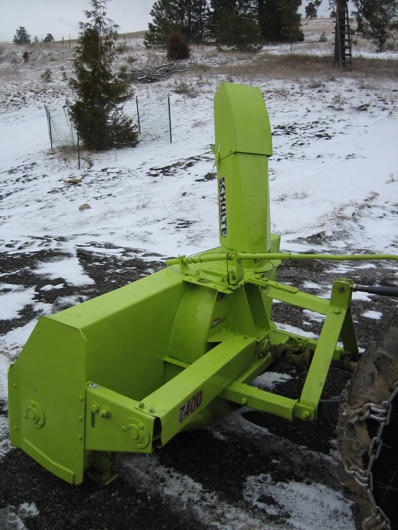

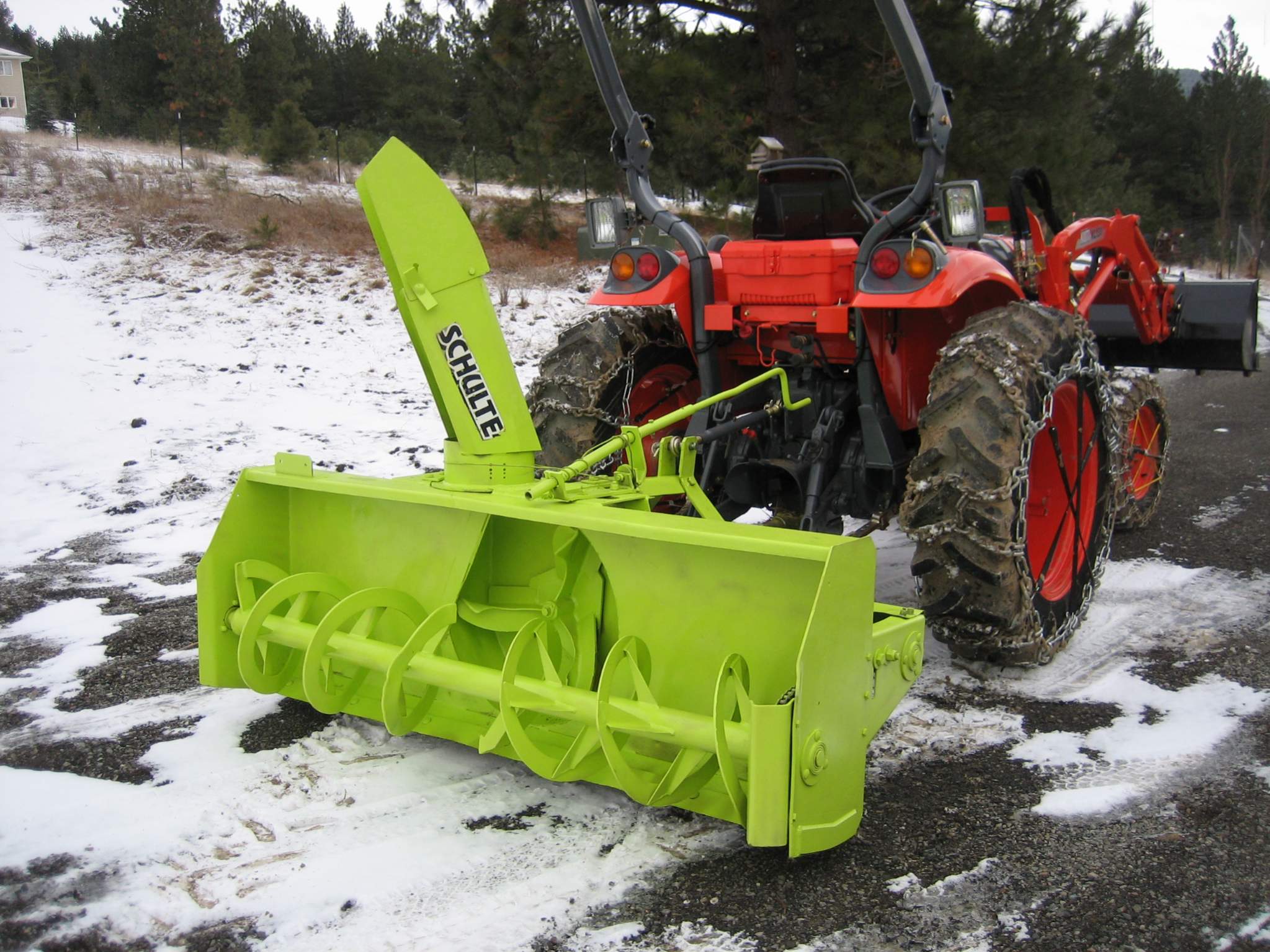

I just picked up a Schulte 7400 (74") blower. :D It is very heavy and seems strong. It was made in 2002.
It was in good shape and I just cleaned it up and painted. Do you guys think the blower blades look OK? They are a little bent. Should I straighten or replace them? Also I think that these are $5000 new so did I overpay ($1900)?
I'm not sure why blowers are so expensive. Volume? They seem about as complicated as a Bush Hog.

"...Did I over pay?..." I think that depends on how much snow you get :D less then 24" yes... anything above that, no... of course that is just IMHO.
How does it run? Is it balanced? If it is and does not rattle and it works, I would leave it alone.
If you would do the work yourself (doesn't cost, too much) and it feels like it's out of balance, I would work on it. At least see if you can replace the blades and how much it would be. I would love to have a reason to "need" one of those...

Thanks. It runs smoothly.
It's actually a bit of overkill for Spokane but the last two years we've had 4' drifts. The five neighbors and I had to pay a guy with a large cat over $2000 each year to get us out.

Since it runs smoothly, and the shape of the impeller blades are not so different from each other, leave well enough alone. Like teg says, its good insurance.

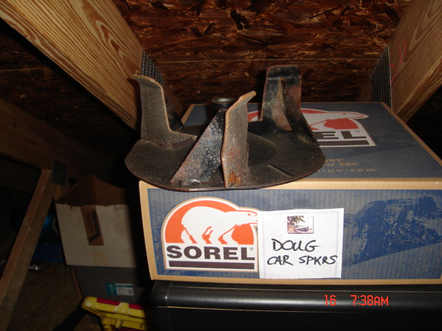

Those bent impeller blades (good ol' rocks) will reduce the efficiency & throwing distance, especially if the clearance from blade to inner fan housing is increased. It may also lead to chute/fan clogging with wet snow. The difference can be significant depending on how far "out" they are, but perhaps in your situation reducing the throw won't be that much of an issue?
On my old 8HP walk-behind, bent blades reduced throw from 8-12' to about 4-6'. I straightened them twice, which helped a lot, then finally replaced impeller altogether. Big improvement!
So-- try it & see how it works... tractor-mounted blowers are pretty amazing!:D You can always attack the blades later....

$1900 is a good deal for a 74" Shulte blower if it is in good shape and yours looks like it's brand new. They make top quality blowers. Be Happy!
