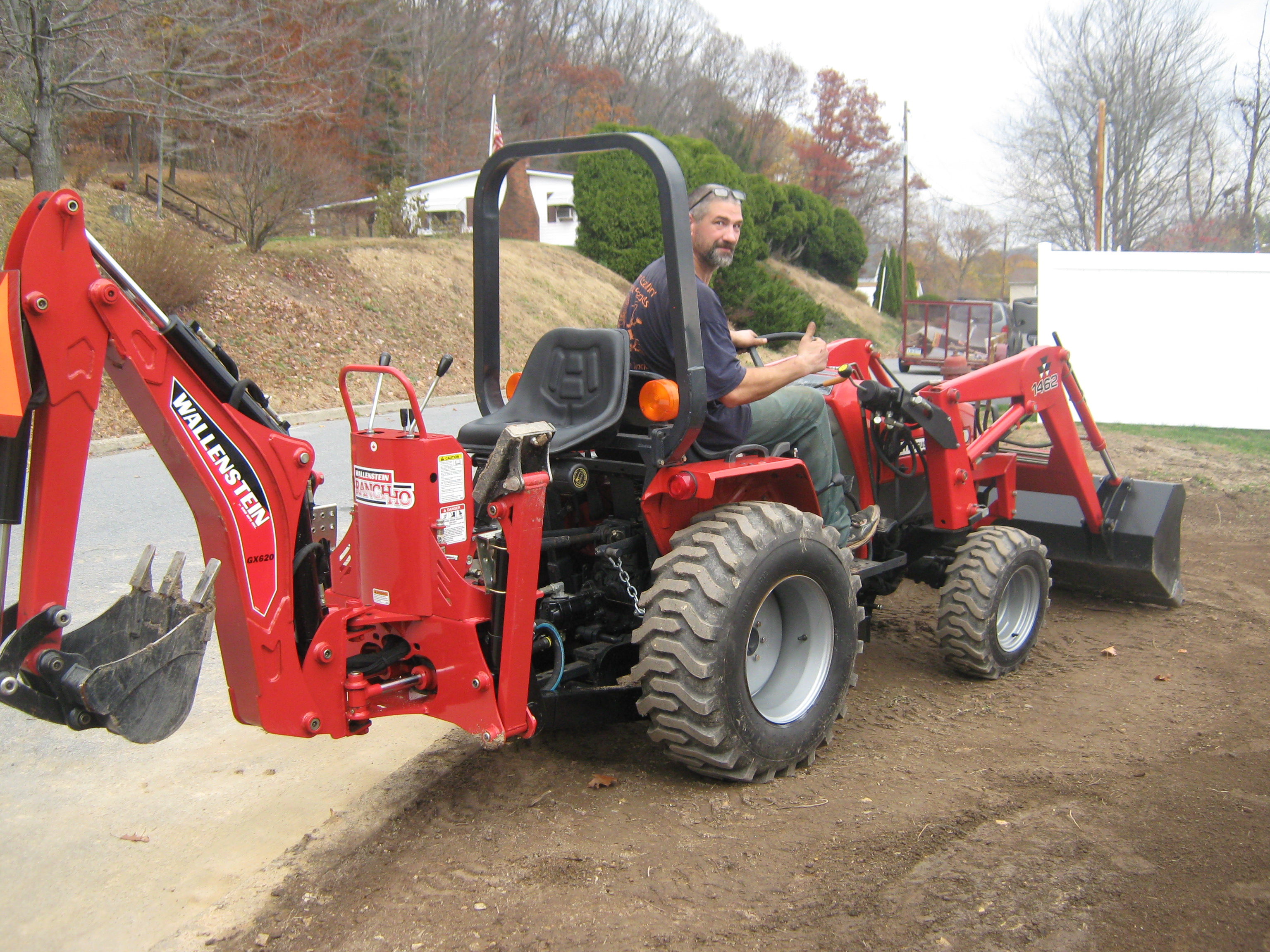

I have a pto pump like yours as well, they work great. had to get a walllenstein for mine. IMG_1366.JPG
