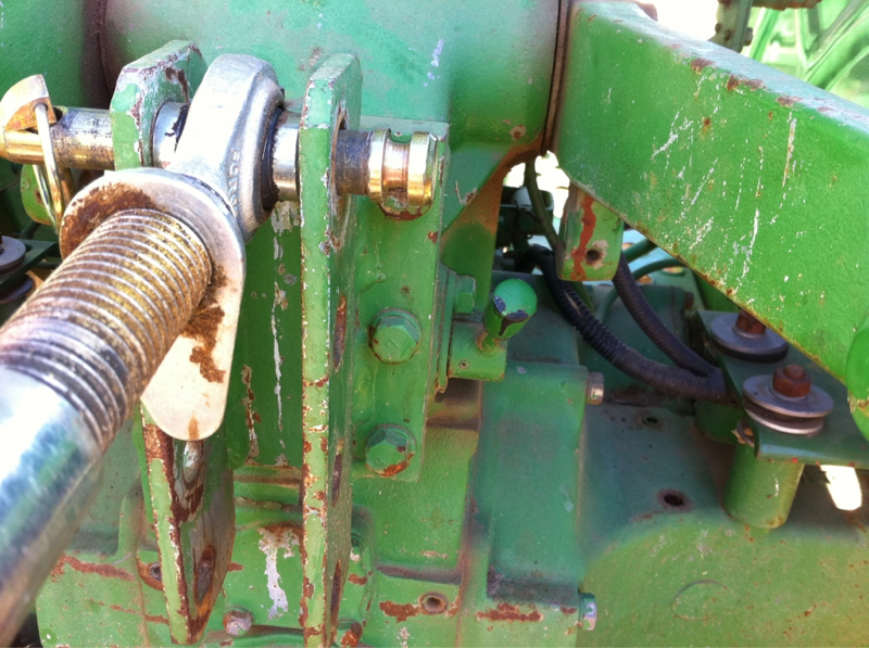

It apparently has power steering, which I've read from a couple places is rare. I have figured out what all of the knobs and switches do except for one. Its on the back of the 3pt housing. I'll take a picture of it tomorrow when its light.

Here's a photo of that lever, does anyone know what it does?

Is that part of the hydraulic module that sits on top of the transmission? Maybe it switches the position control (constant implement height) to draft control? (3-point raises when a plow meets extreme resistance). I think Draft Control was part of the original Ferguson 3-point design rather than the position control we have on the small Yanmars.

It shuts off the 3pt hyd flow why I don't know they had some reason I am sure but if you were to lift it up and flip that lever it would stay put regardless where the draft lever was put.
I have a YM3810D the turbo charged sister to that tractor and I can say it is a hoss you wont be ever out of power it will just spin the tires if you load it too much and the powershift is the best feature of all besides p/s, congrats nice buy there!
Btw your tractor does not have the optional auto draft which doesn't mean anything anyway you wouldn't ever need or use it anyway just thought Id throw that out I can tell by the pic fwtw.

I thought that the knob under the seat shut off the hydro to the 3pt. At least that's what the manual states and I do have a knob (rotating) under my seat.

3110D is a good tractor. That lever locks the 3 point in place. The power steering is nice as well:thumbsup:
