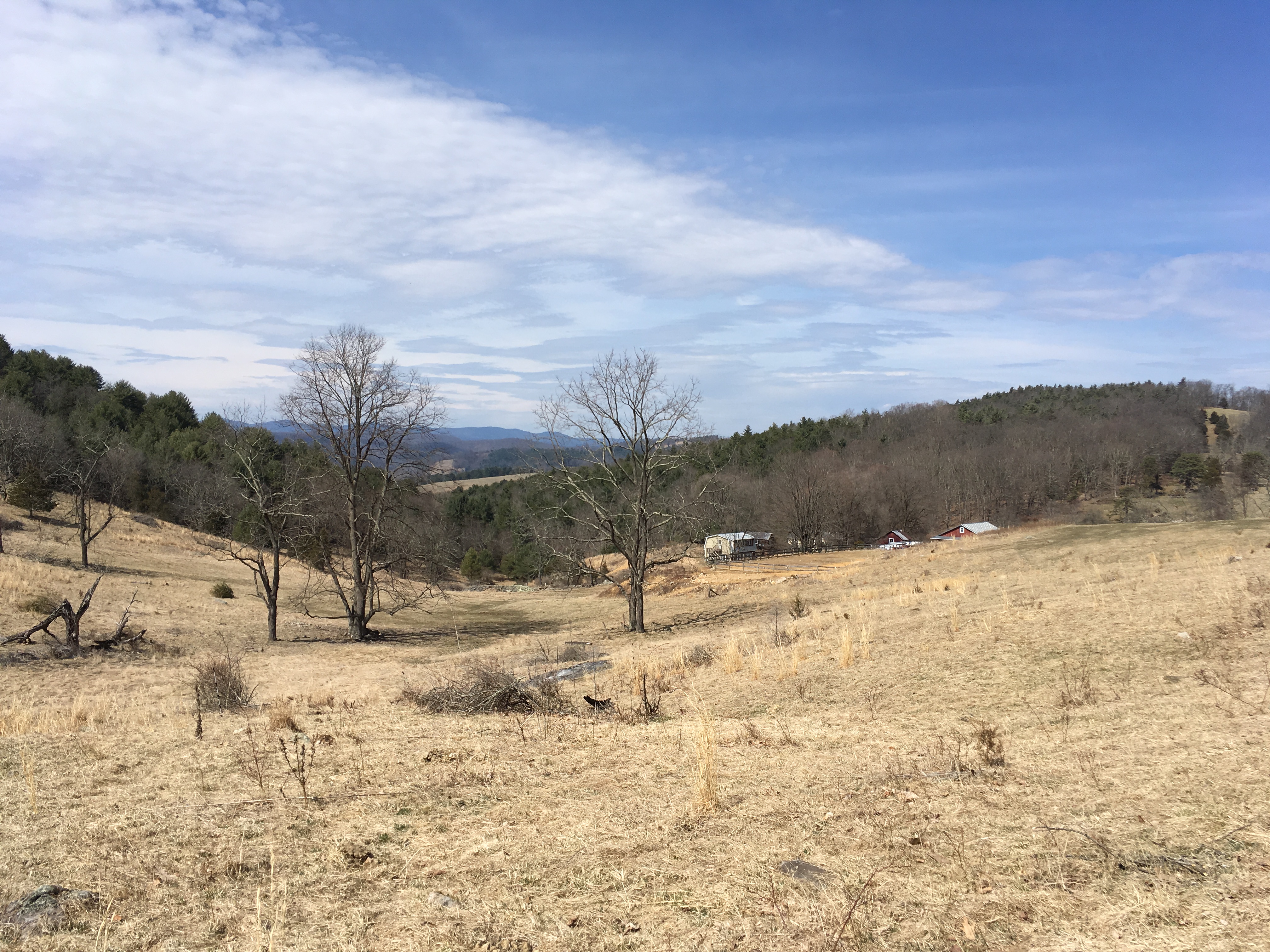

It is hard to put patterns into words, but I have all hilly land on my WV mountain farm, and I am going to start mowing it for the first time next week in my new Yanmar YT235. (It will have the wheels spaced wide and filled by the dealer. We did not opt for Ag1 tires because we also run this on areas that are more our lawn than our fields.
So, trying to refine my question: if a hill is uncomfortable to mow sideways to the length of the tractor, do you go up, rotate (sound scary) and then down? Or do you go up, transverse (seems like you would just transverse the whole hill if this were right), and then down? Or do you mow up and then back down?
(I hope this makes sense.)

Don't look very steep on the picture, but the picture might be lying a bit. Are you new to the land and the tractor?

Pictures don't always show slopes well.
This is what I do:
Basically straight up and down, never across the slope (side hill) except at the very top and bottom where the slope is less severe. I say 'basically' because I can use a slight angle of a few degrees off straight up and down. That helps to reduce the effect of gravity pulling me straight down without increasing the possibility of rollover. In most places, I have enough room at the top to turn safely, travel a bit, then turn back down. There are a few places that I have to turn at the top and take a different route to be able to start down again.
It's hard to describe in type, but it's a pattern I've developed over 15 years of mowing. You'll have to do the same, experiment a bit and figure out which ways feel safe and which don't.

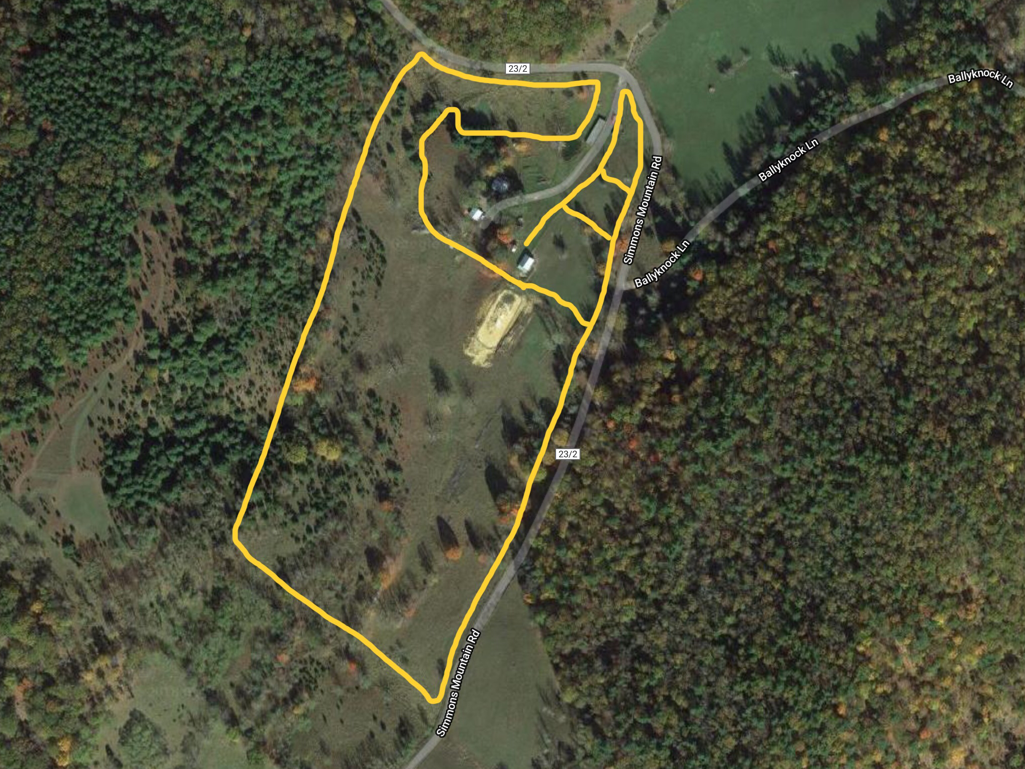

I am not new to the land, but to driving a modern tractor on these slopes, yes. I don’t know how to calculate, but basically, our land that’s mowable is one long swale (we call it the bowl). The outer, upper edges of the bowl can get pretty steep, but a lot of it will be quite tame. I am NOT seeking mow ALL of it, just as much as can be safely done in this tractor.

That’s helpful. It’s the turning at the top part that I was scratching my head about... so, you can do that only if it levels out at the top. Makes sense, thanks!
