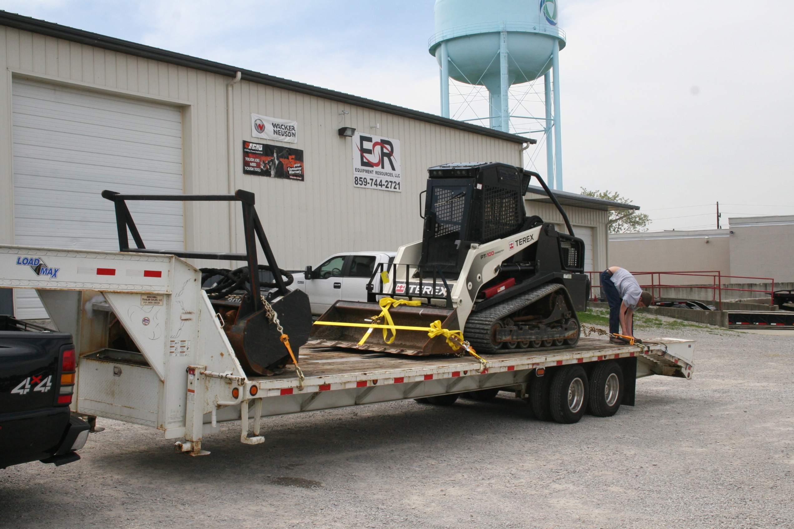

Fast forward to last week, I put our John Deere tractor on CL thinking it wouldnt sell. Needless to it sold within 3 days for more than we paid for it. As this was happening I stumbled upon a 2009 Terex PT100F with only 400 hours and a Fecon head. To my surprise, with the funds from the tractor sale as well as some money I had saved we got it!! Btw Im pretty mechanically inclined and we have a lot of tools to get started. All the equipment is paid off at this point.
Now I have a few questions,
First, will our truck and trailer set up handle that machine? Based on the ratings and what Ive read it will but Im looking for some firsthand experience. Also I know I need a CDL to be legal. Is it true I need the class A CDL? Any tips on getting it? I got the study book from the DMV and have been reading it religiously. :confused2:

They are lots of guys that pull CTL size mulchers with a pickup. I pulled our Bobcat T320 mulcher for a year or so. It will do it, but it hurts your feelings. You are over the GVWR in most cases and will need to be tagged for around 30K lbs which requires a CDL. Not a walk in the park to get your CDL. Study a lot before you take the test.
I would suggest looking for a single axle semi truck with a short wheel base. You can find them for around $10K. It will pull the load a lot easier and you will be able to haul extra attachments, etc without worry. You can tag a single axle for up to 65K lbs if memory serves. You could also get an adapter to hook your goose neck trailer to the fith wheel hitch.

Fishfactor- Thank you for the wealth of knowledge. I do realize pulling a Terex PT100F with a one ton truck is a bit extreme I don稚 think a single axle semi is in our budget right now. Luckily my dad has some trucking experience and should be able to get his CDL relatively easily.
