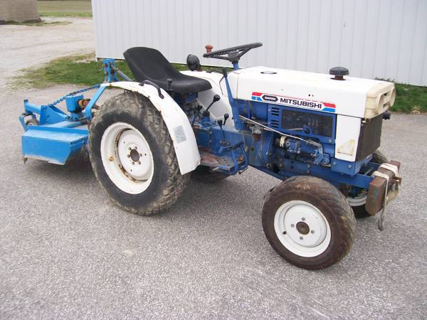

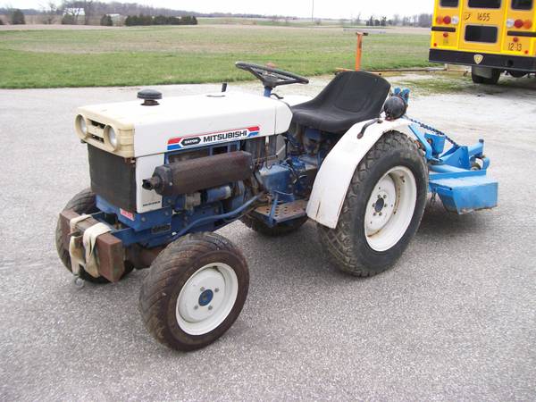

I purchased this about a month ago:
So far it has been great! the only problems so far is a sticky clutch, and a leak on the front drive.

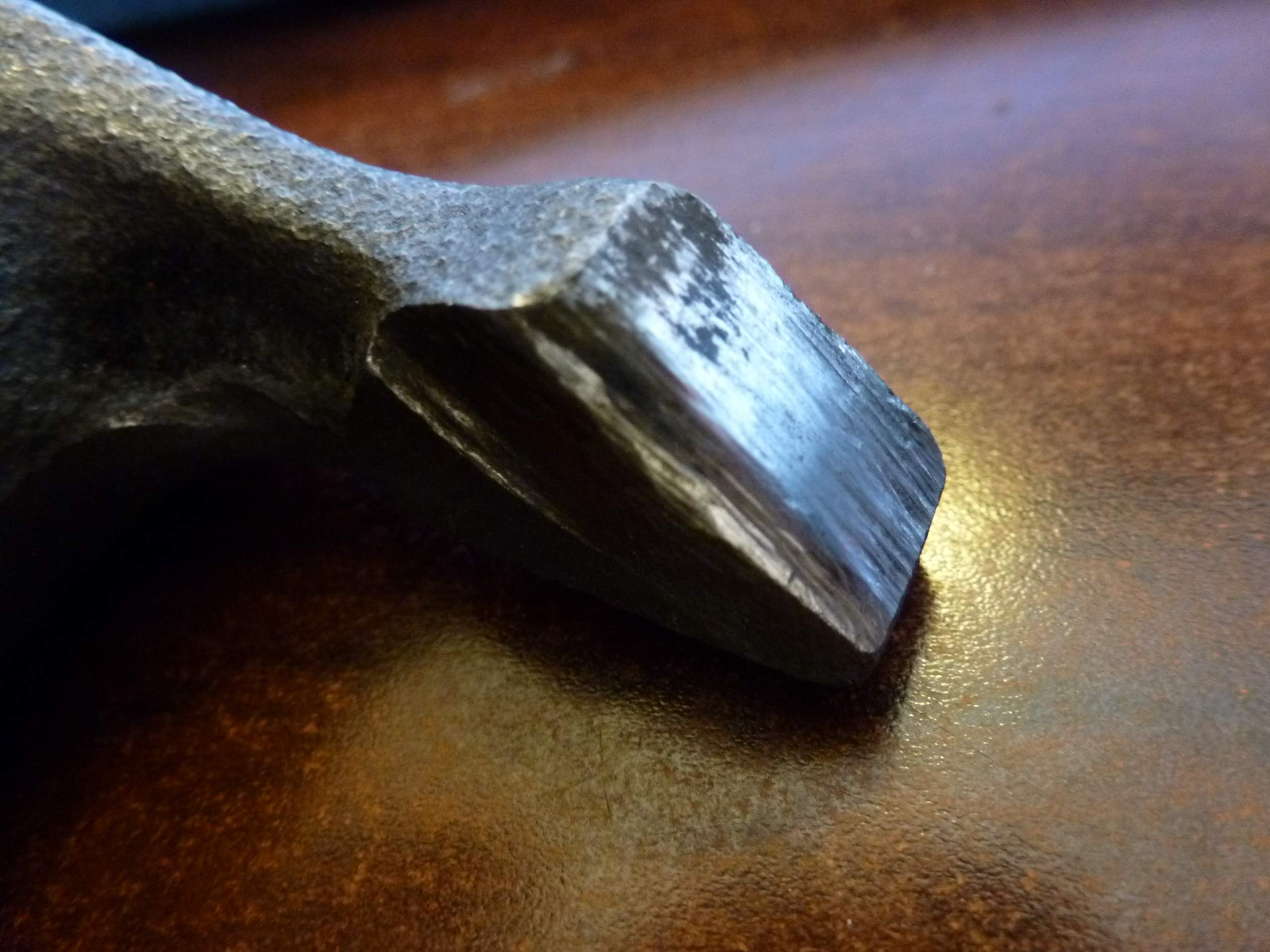

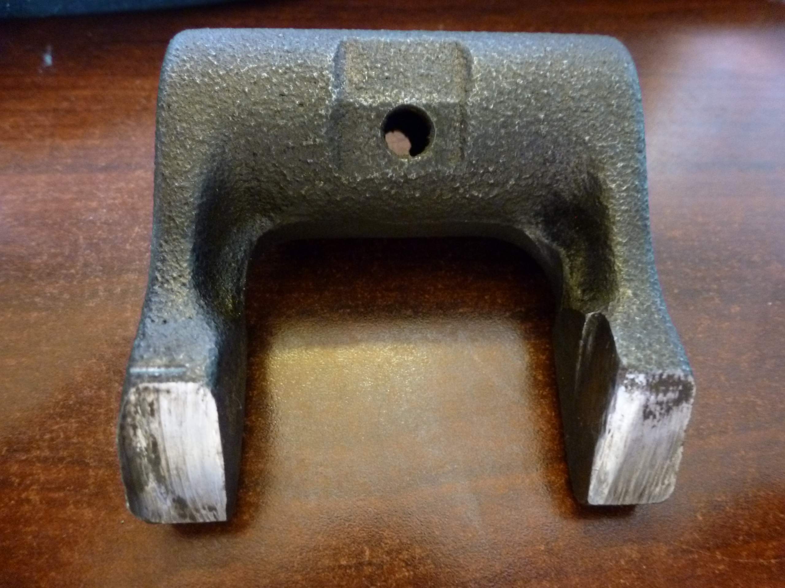

My Case IH is a bigger version of your Mitsu, and the sticking clutch problem turned out to be a worn shifter fork. Problem is to get at it you have to crack the tractor in half, and once I did that, I replaced the clutch just to be sure. Tractor runs great, that engine is just pure smoothness.
