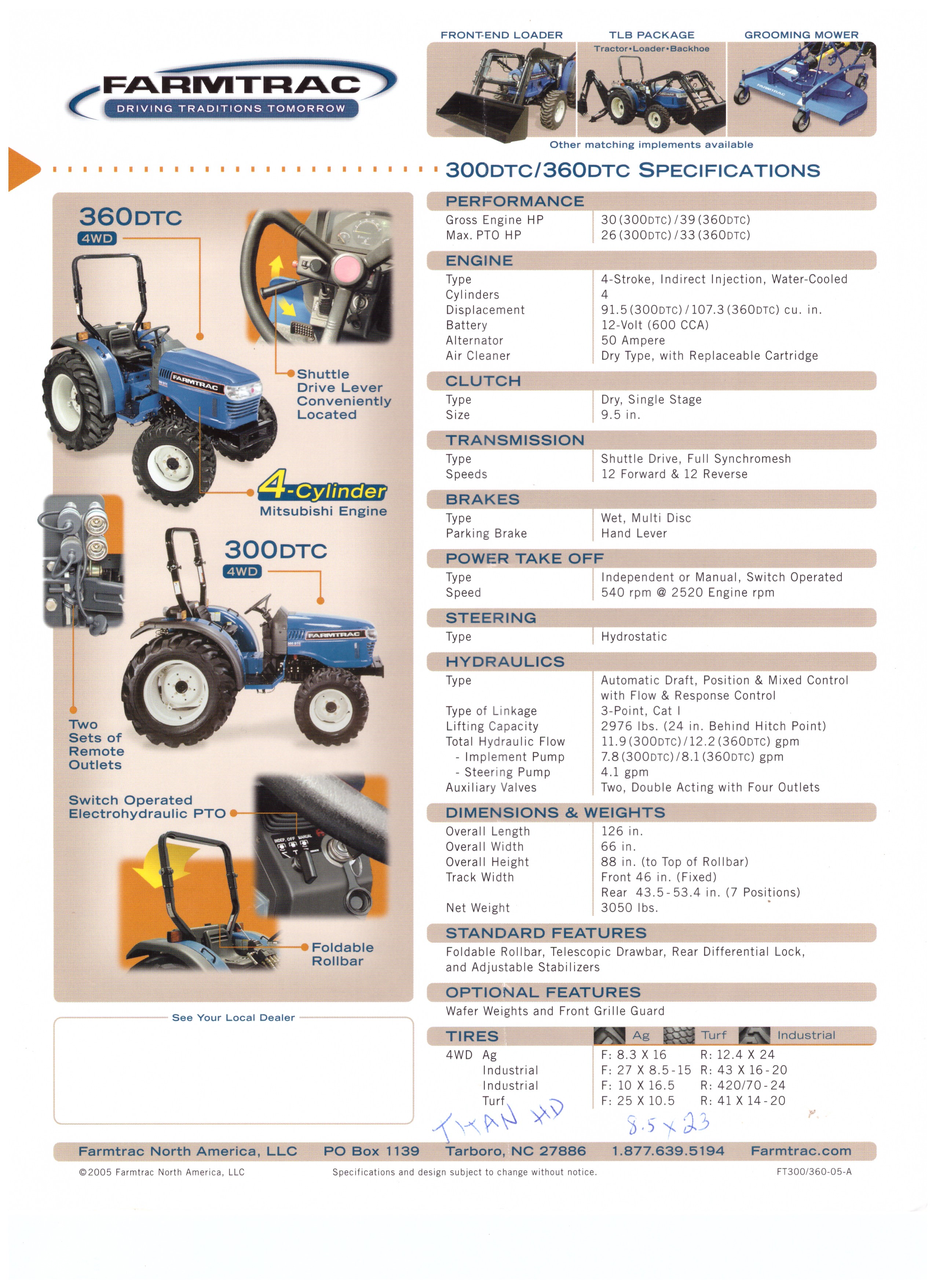

Welcome. I own a Farmtrac 270 that I purchased new. I have more than 300 hours in the seat, most of them happy, other than some minor issues. I came across the attached spec sheet on the 300. You may find it helpful.
Just curious, how many hours on your tractor? Any obvious issues?
Good luck to you.
