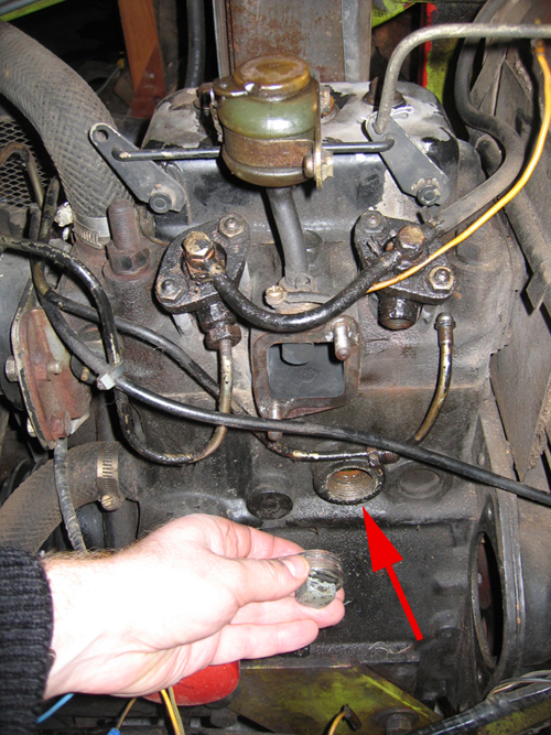

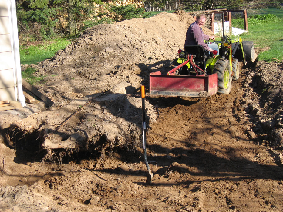

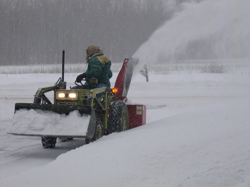

I have a 155D with a loader. I paid $4K for it in upstate NY two years ago with a 42" woods bush hog included with 720 hrs (I think original). Mine starts up no problem in cold weather thanks to the block heater I installed this year. It is a small tractor (15 HP, about 13 HP PTO) but suits me fine. I run a 4' snowblower, 4' box blade, 42" rotary cutter and recently sold my 48" rear finish mower.
One thing to look at carefully is the front end. Is there play in the wheels such that it tows in and tows out? I've replaced my kingpin before and now I think the keyway which times the front wheel to the pitman arm has worn again causing excessive play. This is not one of Yanmars greatest designs. A single key is all that takes the stress in a 1" diameter kingpin shaft. Larger FWD tractors have the pitman arm extend down bolting externaly to the lower gearbox casting within the rim of the front wheel. This is a much more robust design. Aside from that I've been happy with my 155D. It's fun to tinker with.
