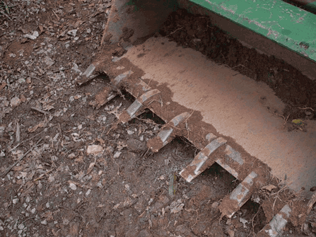

I just finished welding up and installing my new tooth bar. I went down to the South Fourty to try it out. This thing can dig. I was totally unimpressed with the standard bucket, it had difficulty in my clay soil. Well big difference now I put a tooth bar on. I tried it out on a couple of stubborn tree stumps. After a couple of minutes of back and forth digging, pop out they come. I can even pull and push the tractor uphill with the loader something I was not able to do before. One thing that now becomes clear is just how under powered the Jinma loader Hydralics are. I would like to swap out the smaller hydro cyclinders for something with more meat. I can get the bucket up under a large stump but the loader just doesn't have enough umph to lift it out of the soil. I have some pictures if anyone is interested in the construction. It was very simple I bought the teeth from a company called Fabco. I got 7 of them for like $50, I went down to the local scrap yard and got a 5' piece if 1/4" steel for free and a couple of bolts. A few welds later its good to go. I looked at prices from a local dealer, he wanted $350 I thought he was crazy considering he was going to do the same thing I did.

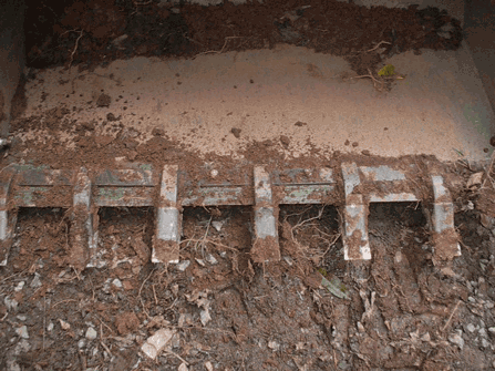

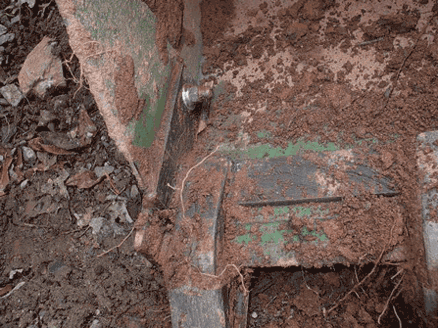

It is a shame, I was really expecting more from my loader than what I get. Hopefully I will get better with practice. Here are a couple of pictures, sorry for the mud. As you can see there is not much too it. I drilled a couple of holes into the sides of the bucket to hold it in place. After I got working I noticed that the middle part of the bar was under extra stress so I drilled 2 holes on the bottom of the bucket and bolted down the front for extra reinforcment it works great.
   / New Tooth Bar Observations
Another shot
Another one
