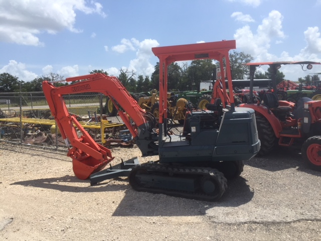

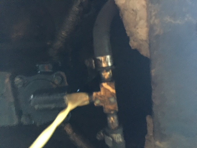

Picked up an ancient Kubota KX71 mini excavator on Friday and spent Saturday morning digging up and pulling down some almost dead persimmon trees. Local tractor dealer took it in on trade and found the motor was toast from a bad ether start (broke most of the rings). They did an overhaul plus a lot of little fixes plus welding and paint (it spent many years down on the coast and some of the sheet metal was toast). Pins are good, tracks still have some life (tensioners need an overhaul) so overall it is in decent shape. I do need to make some shielding for a few places - cracked a brass fitting on a return line on the bottom.
I was really surprised at how much work you can do with just 27HP. This thing digs like mad, rips trees apart, so it should be pretty useful once fully sorted out.

Looks like the fluid has water in it and needs changing. Pretty milky looking in the pic.
   / New Toy and Already Broke It
That was a sacrificial bucket of tractor supply 303 to get it back to the yard and off of the branches that caused the problem in the first place. Looked the same going in as coming out. After changing the cracked fitting I am going to get a manual and put the right stuff and a fresh filter on it.
   / New Toy and Already Broke It #4
Tee fitting and hose clamps look a little "cobbled together" to me, got to be some better solution out there...
Dale
Dale
Looks like those are the return lines for the traction motors but not totally sure yet.
