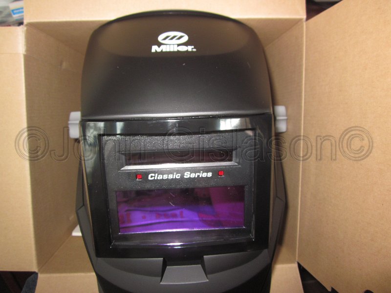

I snapped a few photos for the group, if you are in the market for a GOOD helmet/shield, especially if you would like to stay under $100 the Miller Classic Series would be a good option in my opinion.:2cents:
The first two photos are self explanatory. From there, looking thru the lens, they are:
