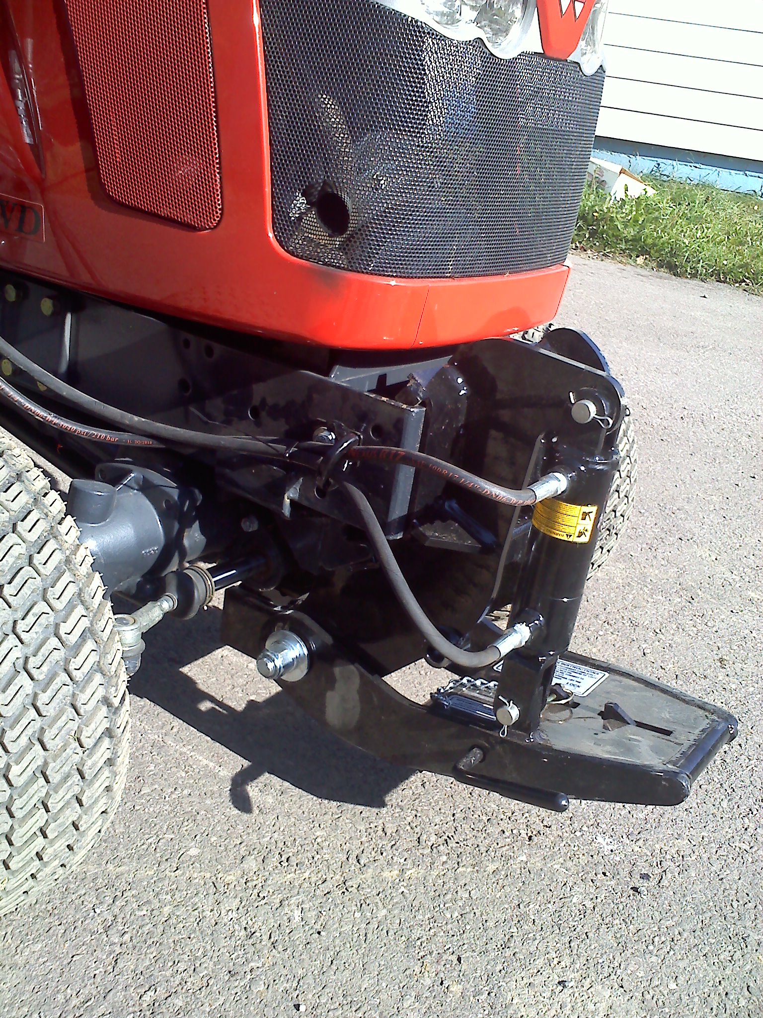

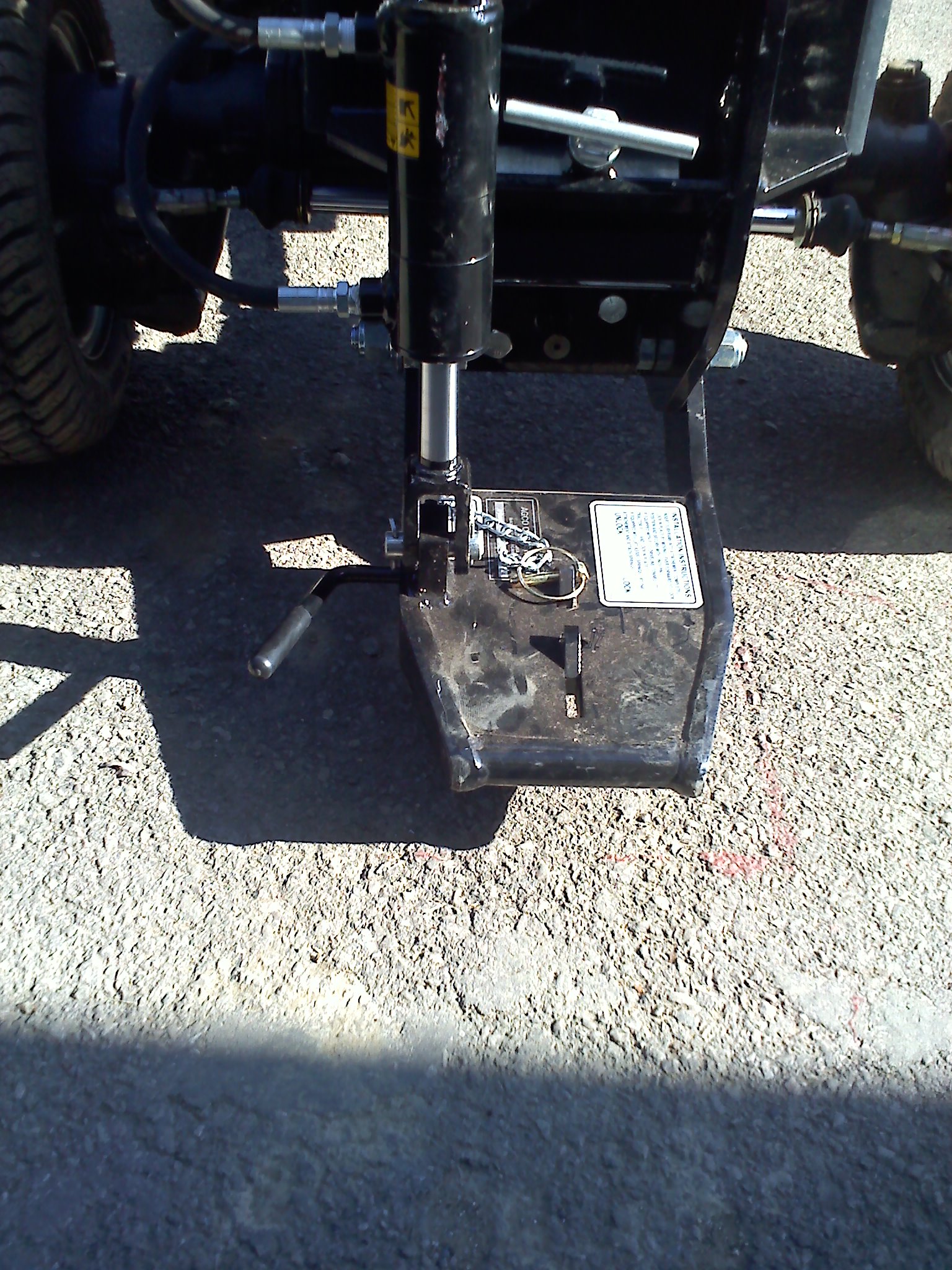

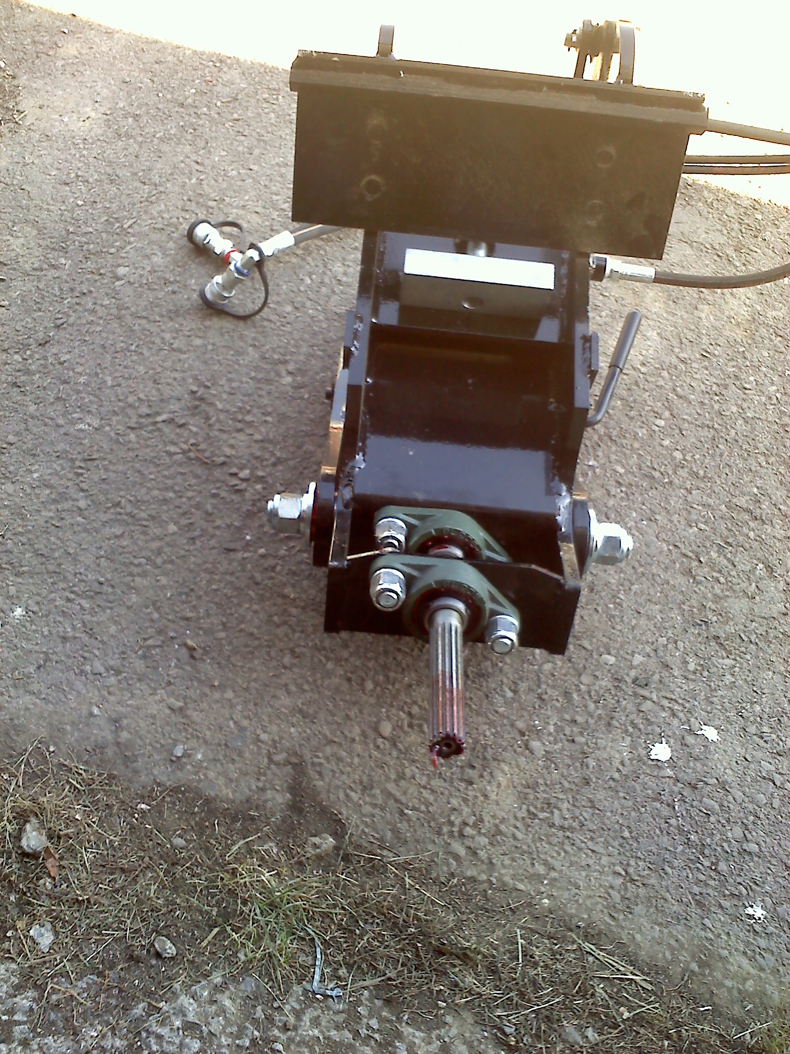

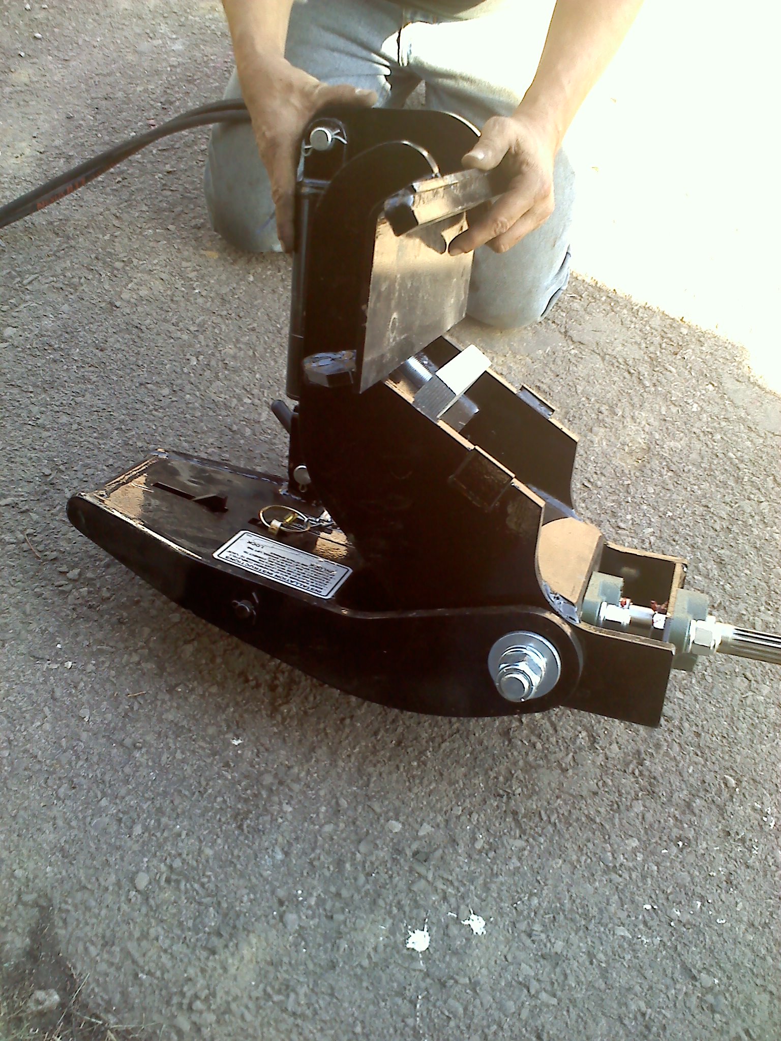

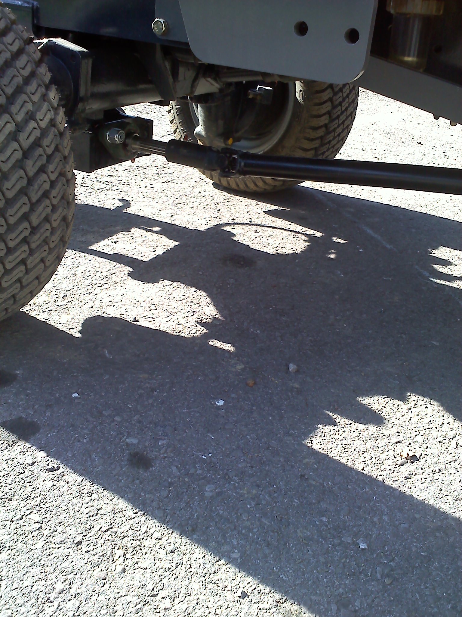

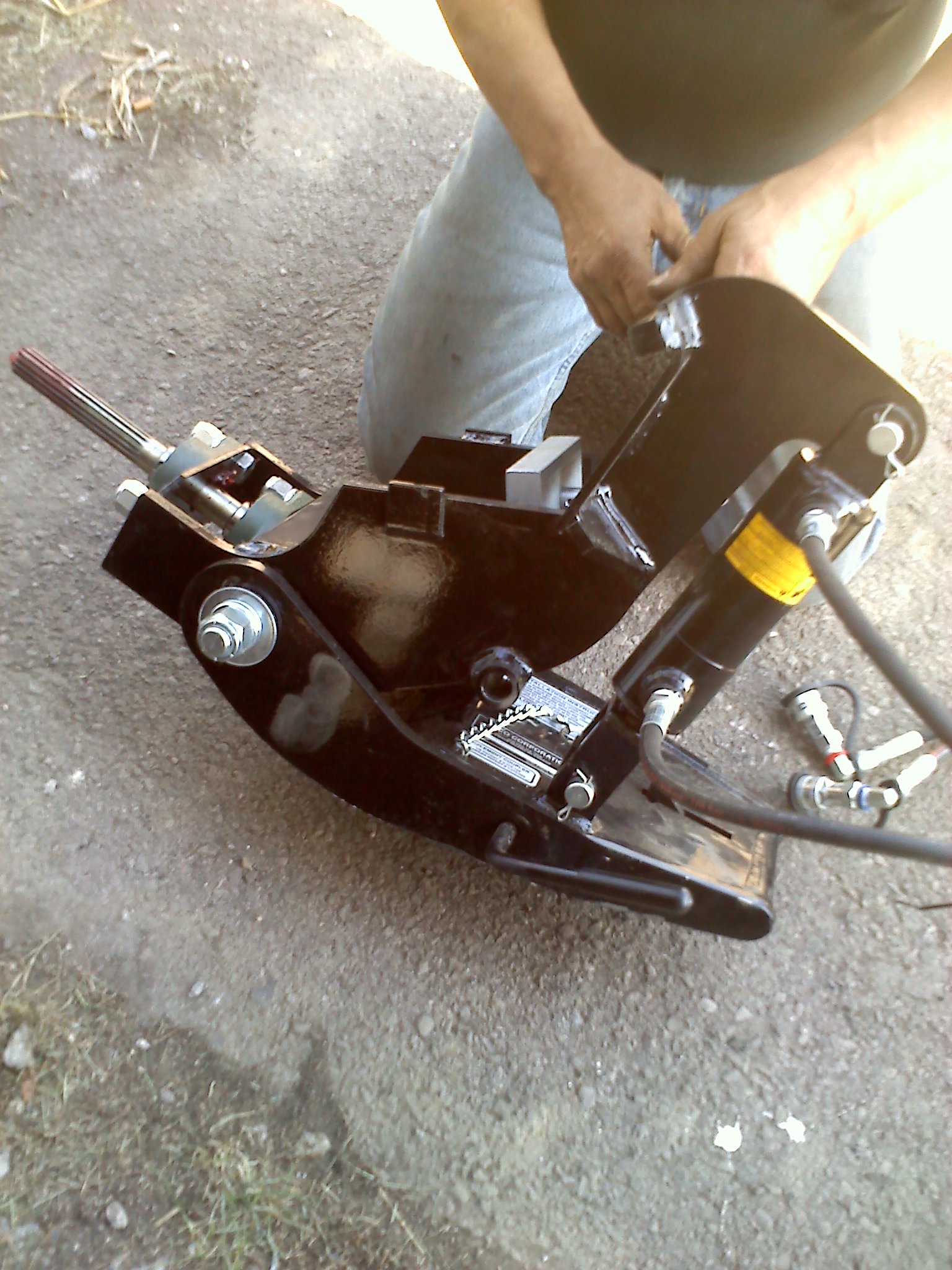

Here ya go: Pic number 1, under the fingers on my left hand......this slides over the top of the frame on the front of the tractor. Directly below that(the shiny piece), is the locking mechanism...........operated by the T-Handle in pic number 4 (quick hitch installed).
Picture number 5, the little thing sticking up in the middle of the hitch......that holds the blower on.

The FEL can be used with the front quick hitch installed, BUT, the quick hitch, and driveshaft is sooooooooooooo close to the ground, that you would need to be extremely careful (I can't emphasize this point enough).

Hey, Paystar-- you're right, it's very easy to slip off the blower and mount the loader --I've done it myself-- but Don's absolutely right: that blower quick-hitch shoe sits very low. I found out when I --uh, contacted-- a low stone wall...:ashamed: Fortunately, no damage, other than some scrapes in my nice shiny black paint.:eek: But really, it only takes a few minutes to accomplish the swap, if you have wheeled dollies on which to set the FEL and blower.
