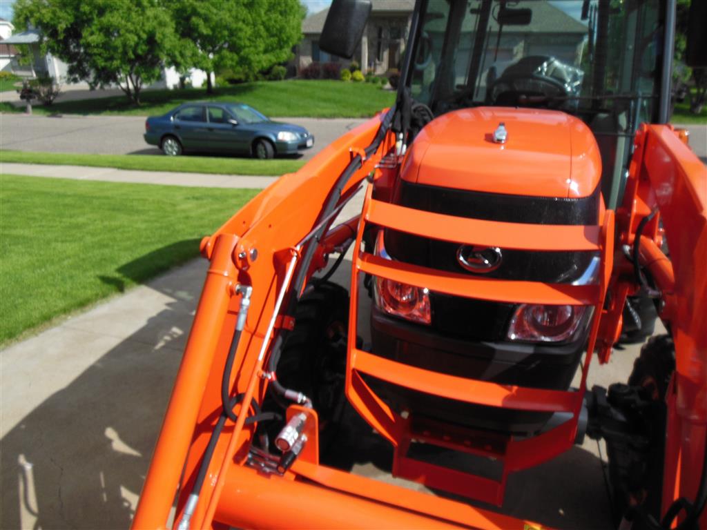

I added a 3rd function to my new tractor. I did it before on my L3130, so I knew what needed to be done, but the new L5240 has a different setup for the hydraulics that made it a bit harder to do. That mostly just meant more expense in the hydraulic lines/fittings. Such is life.

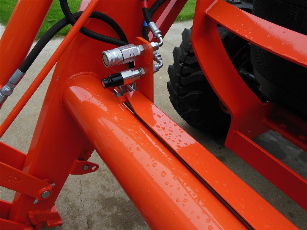

Here are the implement connections. I used 3/8" steel and painted to match, using the same point Kubota does for the factory 3rd function. Also the same basic place it was on my last one. Bulkhead hydraulic fittings attach it to the plate.
I made the brackets to hold the hoses to the existing clamp points on the arm. The brackets come welded on from the factory - I didn't do that. I bent and painted the clamp to fit from 1/8" x 1.25 steel. This shows those and the hose runs. The pic above shows it a bit too.

And buried back in there (above) is the diverter valve. I screwed it to the FEL upright rather than clamping it onto the arm. That was largely due to a suggestion from Brian at Fit Rite Hydraulics (where I got the diverter and joystick switch), plus it was almost necessary to put it there due to the differences I noted above.
That is the hydraulic side.

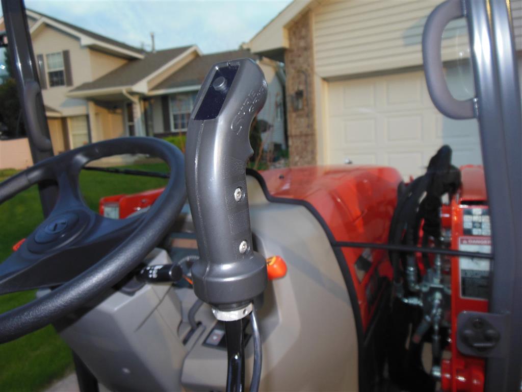

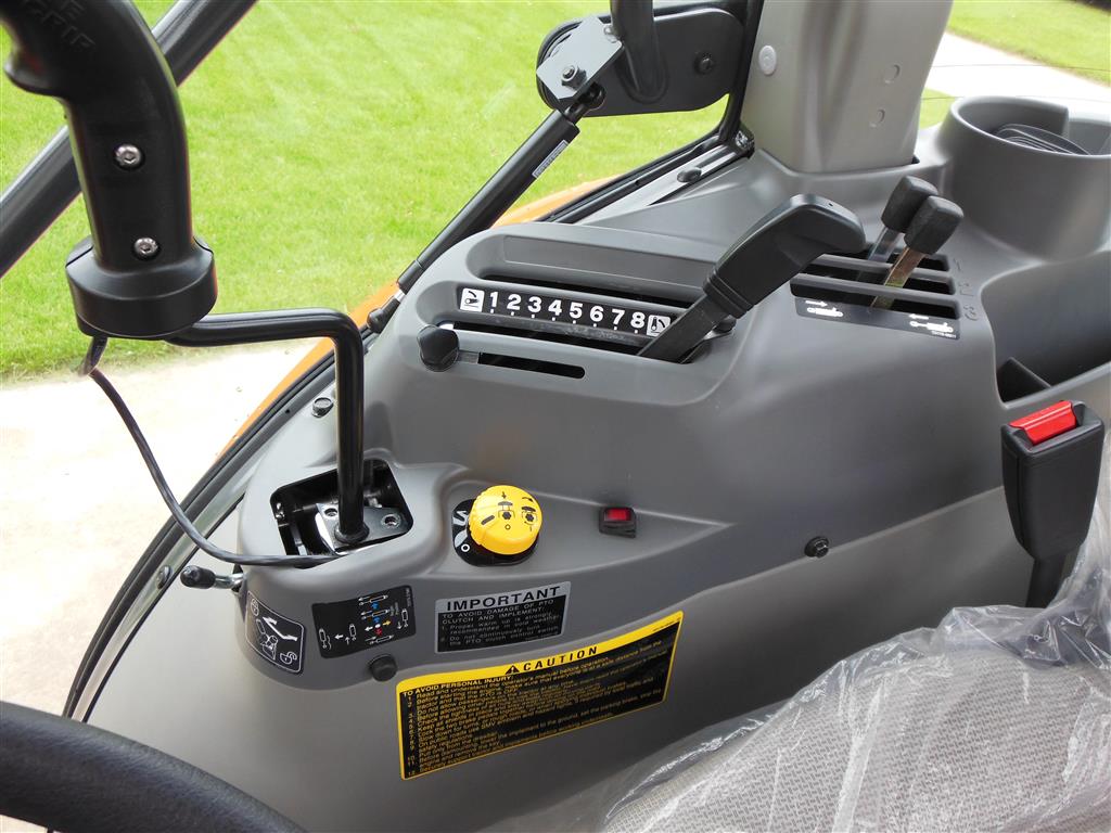

Here is the electircal/control side.
I tapped into the cigarette outlet in the right hand fender trim area. Here you can see it all torn apart for wiring. I used a relay (black cube) that I stuck to the fender with foam tape to drive the diverter so the joystick microswitch doesn't get burned out quick. Joystick drives the relay which drives the valve. i also added a diode at the diverter to help with the backrush current or whatever it is called when the solenoid opens (not shown).
Here is the master switch (red rocker, just below the yellow PTO knob) for the 3rd function, so you can switch it off if desired.

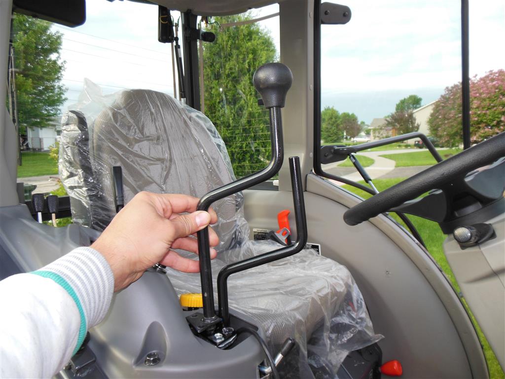

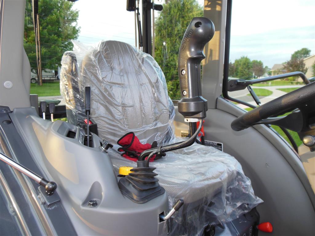

And Then the FEL joystick itself. There is a problem in that the bushing that comes with the joystick needs to be drilled out to fit, but the rod is 14mm - bigger than 1/2" and finding that drill bit was hard and expensive. Anything above 1/2" gets spendy, especially for one lousy hole. I also decided that the handle would sit too high as -is, so I made a new one out of 1/2" rod, so I could bore the bushing to fit and lower the height. Here that is. Call it my short throw shifter, I guess :) I dropped it about 3" vs the old one (with the rubber knob, held up to compare).
You can see the diverter valve in the background on the last pic

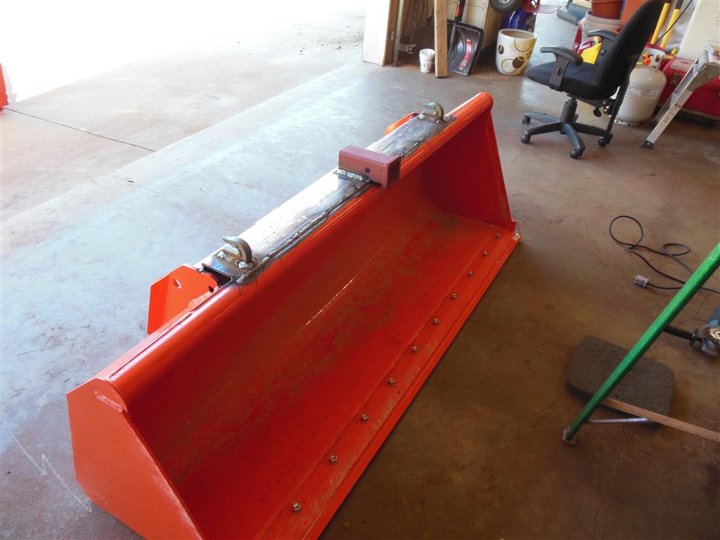

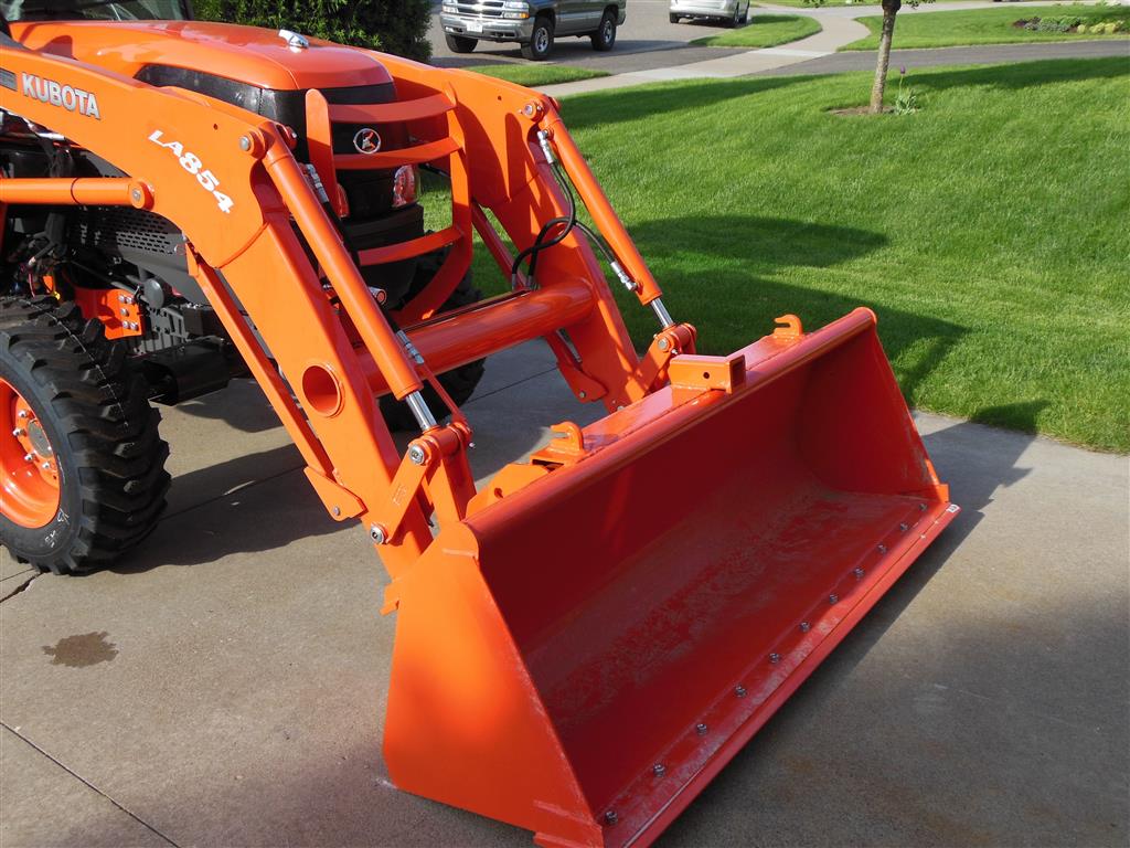

Then what brand new bucket isn't complete without some welding on it? :D
I added 2 chain hooks and a receiver. I used a piec of 1/4" 4x4 angle with one leg cut down to about 1.25" to get a nice flat reinforcement to hold everything in position. This is the heavy duty bucket, so it probably didn't need reinforcing all that much, but it helped these sit better. I am still no better than a so-so weldor, so no close-ups will be shown :D

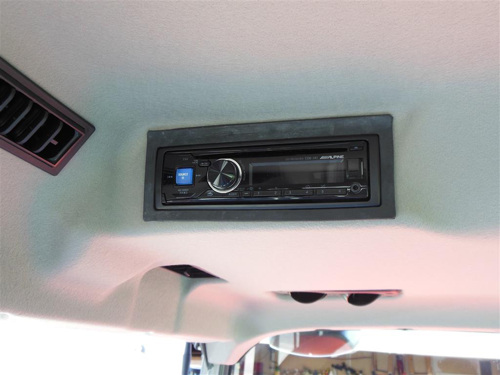

I also put a radio in, but am waiting for the harness to show up so I can power it up. Probably tomorrow.

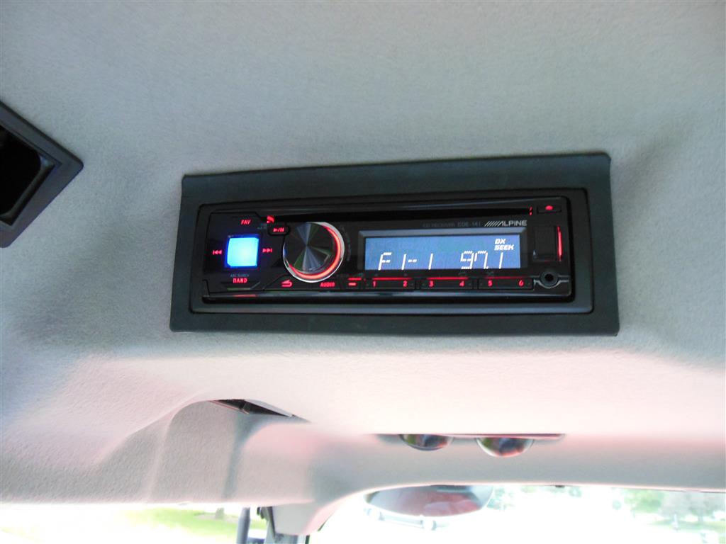

The radio harness came in, so I got that powered up and am rockin' the cab now!!!:cool2:

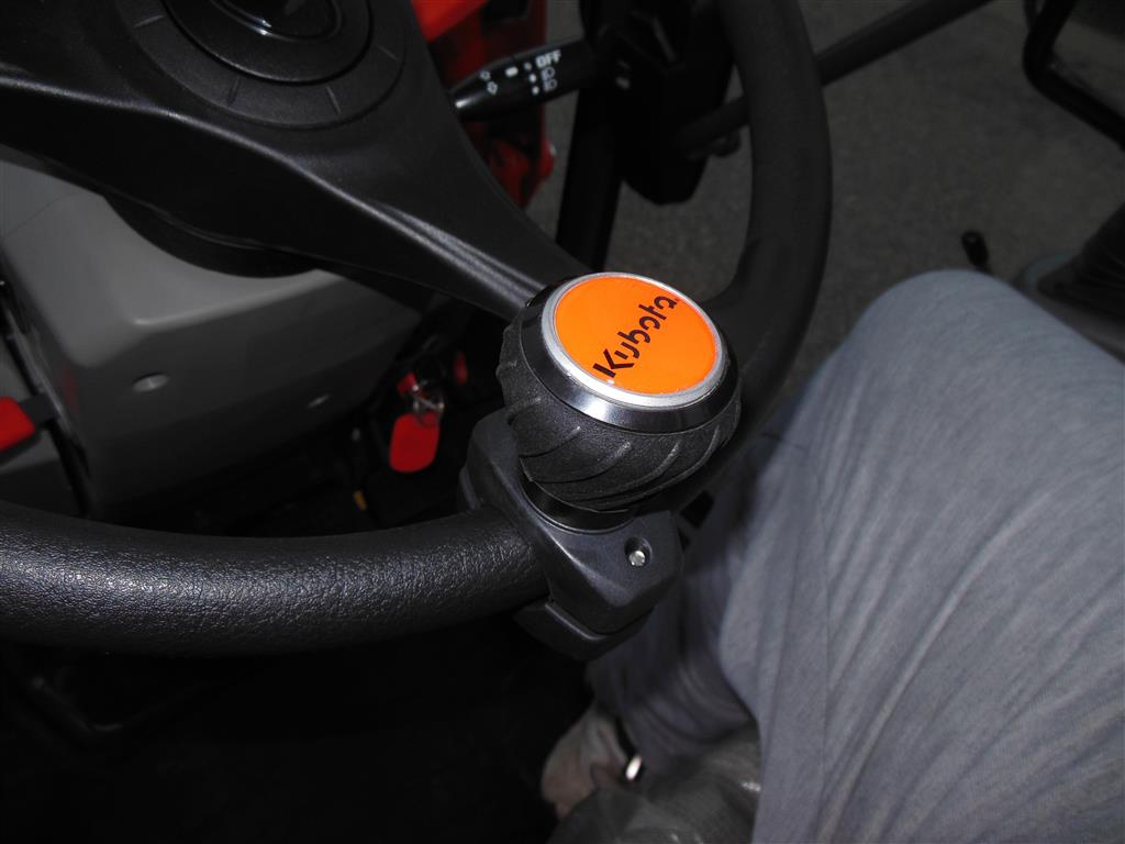

And the wheel spinner came in from Coleman equipment. Now my life, err, tractor is complete.
That should basically do it for the new tractor. Now time to start using it...

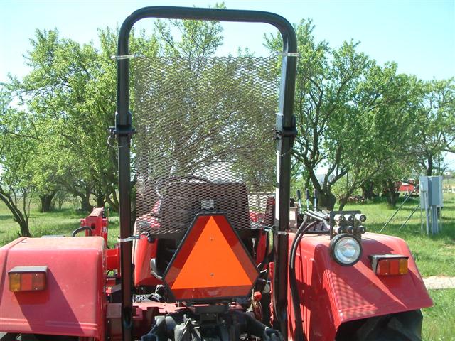

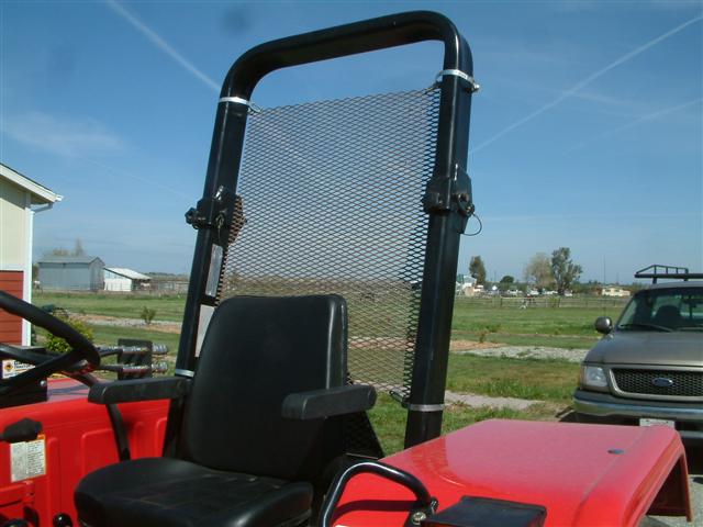

Here's a quick upgrade I added to my 2008 Mahindra 5525.
Attached a piece of expanded metal screen to the ROPS via hose clamps. Keeps any stuff thrown up by my mowers from whacking me in the back of my head.
View attachment 321537View attachment 321538
This is an incredibly good addition and very under rated/ not understood how important this is. A coworker of mine was killed a few years ago while brush hogging. When he backed into a corner of the field, he mowed over a downed fence post and a fence staple became a fatal projectile.....such a simple thing left a wife and young daughters without a husband and beloved father.
