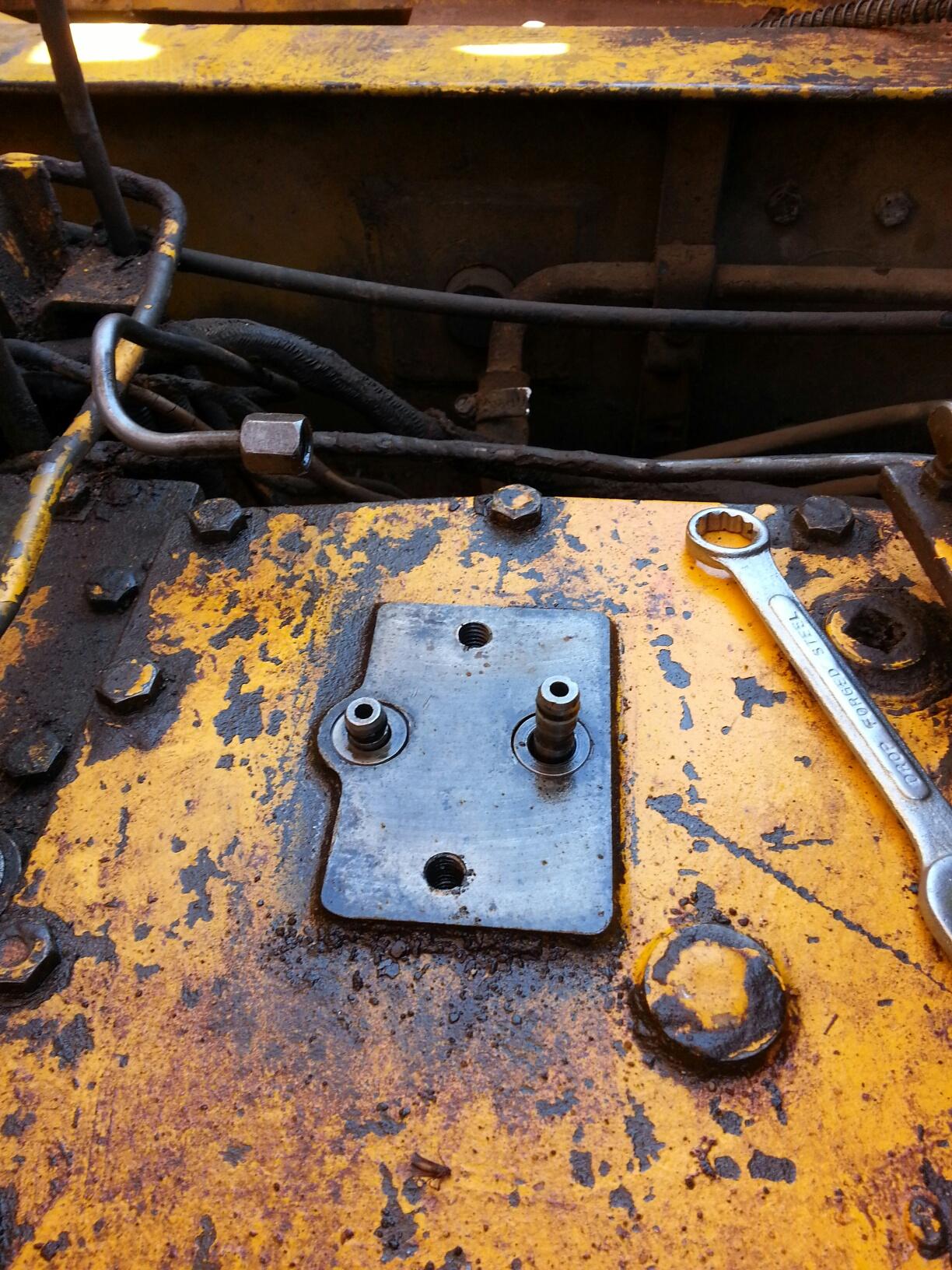

Any ideas on the hydraulic transmission in this tractor it is a 1979 diggs great... In low gear will not move in high gear moves but no power.
what do you think?? . thank you OBB:: ps this is a internal exstingaho back hole 3500 A siar

Good old IH 3500. Got one myself. Mines also gutless in high range. I would check the linkage going from the high low shifter to the transmission. One note, if you dont already know, always use the clutch when shifting. It is not a power shuttle or torque converter drive.

Thank you but my tractor has the hydraulic transmission it has to paddles on the left side floorboard I believe I found the problem of finding the parts is becoming a challenge part number calls for a 402865R1 I ordered this part there's four of them they go around to the goes into the top of the transmission the new ones only hold the line from going one way the old ones hold the line from going up or down so if you know anyone that has these parts original parts I would be highly interested in getting them thank you Robert or obb... 123.jpg
