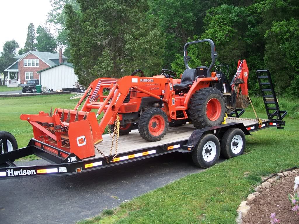

I've shown this elsewhere on the forum recently, but thought I'd post it officially in the correct forum.
18' of flat deck, +2' of dovetail, 10,000lbs. rated. I'm extremely happy with how it tows with L2800 (with loader and hoe), 6' boxblade on the trailer, and the rake in the truck bed. With a bit of fiddling, I'm sure I could fit the finish mower somewhere, or possibly the future rotary cutter.

Familyman,
Don't take this wrong , but you aren't binding that down the best way.
In the picture, you show the front chain hook, hooking the bottom of the tie down location. You should run the chain up thru it and then the hook rests on the TOP edge. Gravity will be your friend and keep the hook from falling off. Remember, if you let go of the hook and it falls off, you need to change how you are doing it.
Your way, if the load shifts and the chain loosens, it will release from the bind point completely and the tractor could slide off of the trailer. My way, even if the chain is very loose the hooks are still attached to the trailer and the tractor can't move very far.
I also don't like the loop in the other chain around the bind point for the same reason. Use those bind point to attach the chain hooks, take out the slack in the chain around your binders. I also don't like the snap over noggin knockers, but that's personal preference - they work fine.
Yeah yeah, I know -- pick pick pick.

nice trailer man, i need one of those i think i was quoted close to 3k for a 10k 20' flatbed like that. for now my grapes of wrath trailer is doing good.
I think i will get an enclosed trailer and take pictures of it and tell TBN my tractors in there so they wont tell me i forgot to flip the seats foreward on the backhoe and lower the rops for transport, lol

John and Workin,
Thanks for the the tips. I understand everything except flipping the seat on the backhoe. I never take good advice "wrong"!
Workin,
Maybe next time I'll wrap the whole thing in a tarp?
Cbr,
This trailer was closer to $4k. It's a 12k titled at 10k. The width is 6'6" between the fenders.

Glad you didn't take that the wrong way. !
I didn't get the seat flipping either. Then again my hoe has it's own seat - a bass boat swivel seat. Same as the tractor. Hey, the originals were shot, shot, shot again then run over and drug down a gravel road and I had two extra seats sitting around...
I had my trailer tagged at 10k then last renewal upped it to 12k. It was fine for my kubota with implements, but needed the extra for the Ford Backhoe. Although your trailer does have a "5 Ton" tag on it....
