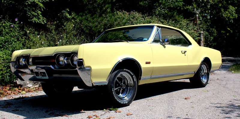

For your viewing pleasure here is a pix of the 67, it was a fun project and is
an even better driver.

Good looking Olds. I'd say do the same thing with the GMC. You'll have a better truck than a new one.

The 442 was/is awesome. It'll run faster than you really want to drive it.
