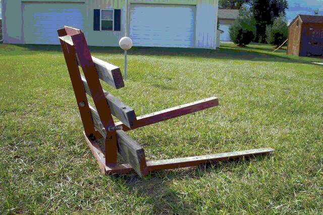

A while back I posted this thread about breaking my carryall while trying to move a big rock.
Broken carryall
The attached photo shows the aftermath.

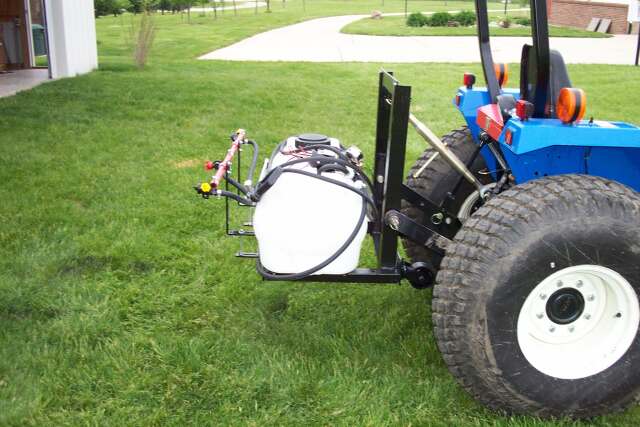

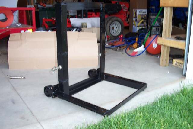

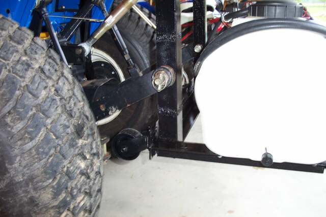

I finally got around to fixing the old carryall by cutting and welding in a new piece. (No amount of heating and hammering would budge the bent area)
I also shortened the arms and added a cross brace for a special purpose.
Oh, and I also added some heavy duty all-steel caster wheels which I welded so they would no longer swivel.

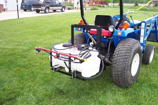

The carryall is now used as a permanent platform for my new sprayer. 3pt sprayers cost about $400 for the smallest models plus the cost of the pto pump. I purchased this ATV unit for $300 and it is just the right size for spraying my 2.5 acre lot.

Another pic
The sprayer is a Fimco. 3.5 gpm, 45psi, 25 gallon. It sprays an incredible 30ft path and has a hand spray wand also.

The wheels were left over from a previous project. They work great to roll the sprayer around inside my barn.
