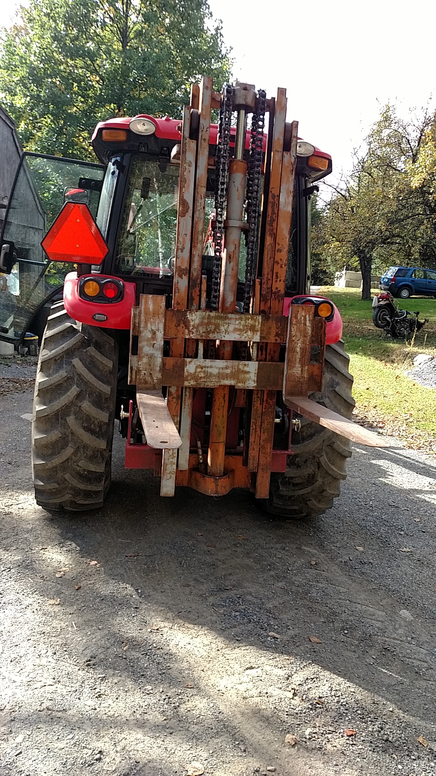

Or go with a 3point mounted forklift.
I made my from a forklift mast but you can purchase similar or simpler units.
The load on mine in that pic is a full ton.
