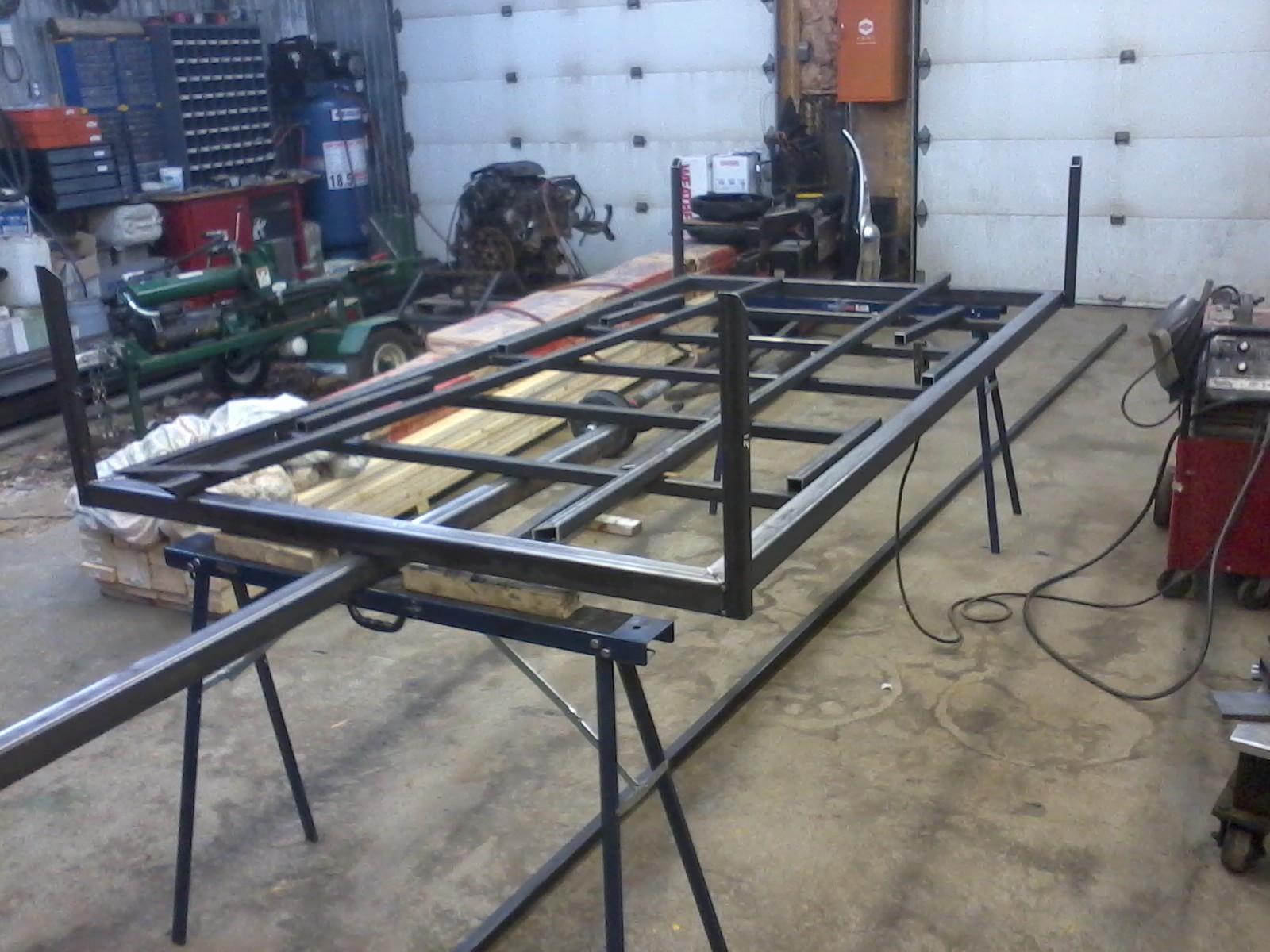

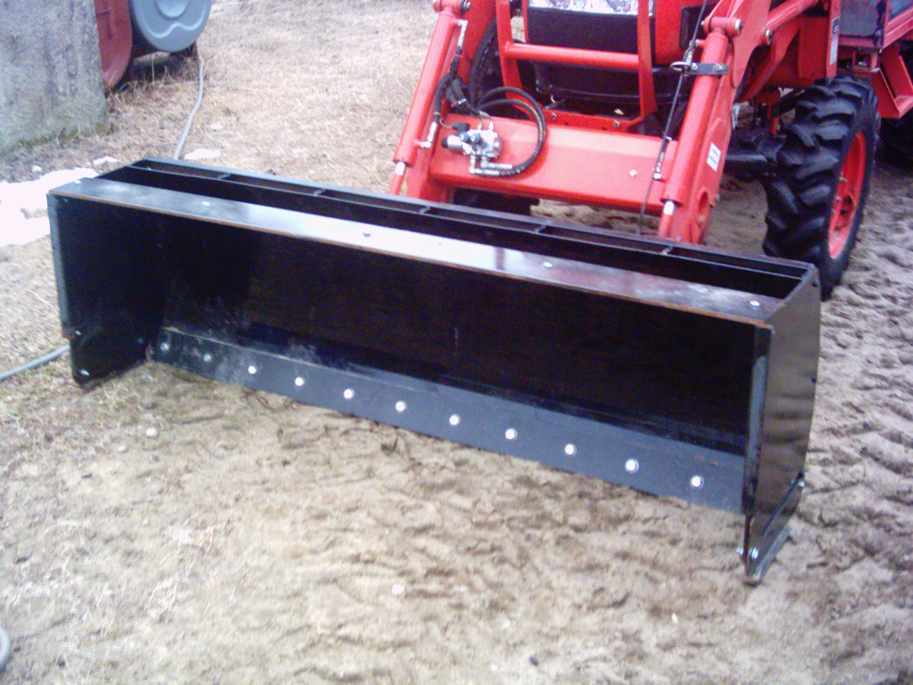

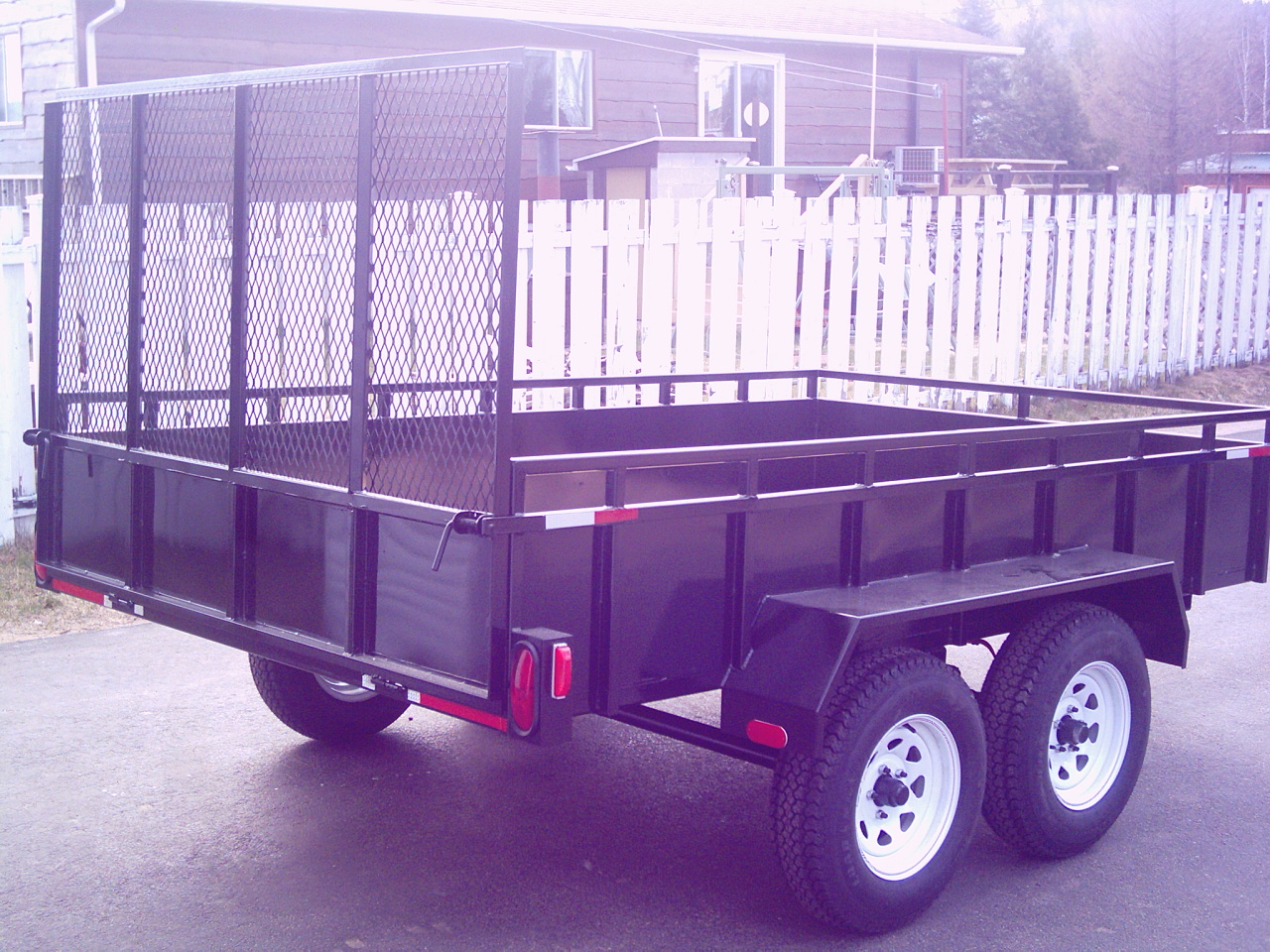

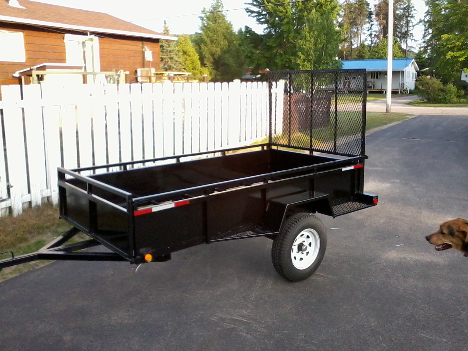

Thanks, waiting for the quotes, gonna shop around a bit cause these things aren't cheap. Meanwhile these are some things i built with my 211 to pass time:thumbsup:. photo tel 2 008.jpgphoto tel 2 010.jpgphoto tel 3 029.jpgtrailer 6x10 003.JPG069.JPGtrailer 63x123 006.JPG
