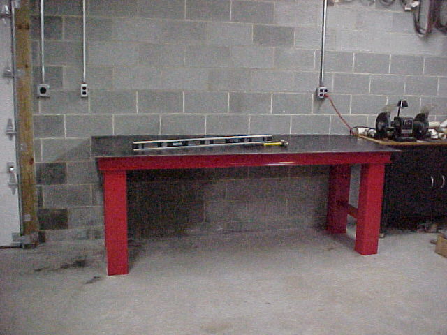

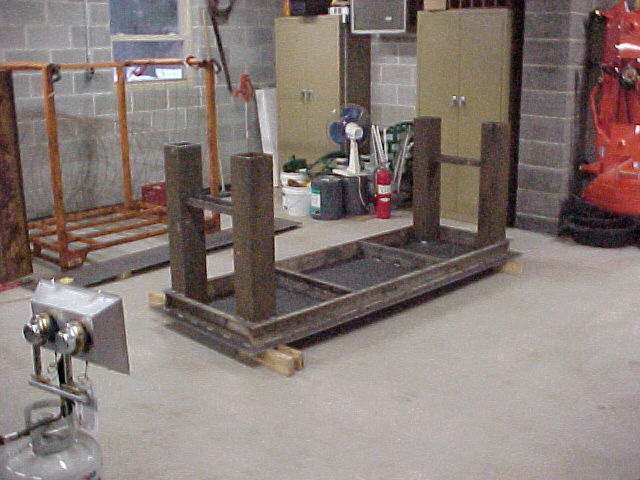

Always wanted a good heavy welding table,so I
glued one together. 6 x 6 legs, 4" channel and
3/8" plate, estimated weight 750 lbs.

Painted and in position, took a couple buddy's
to roll it over.

Nice job on the table. Is the top solid? When I make mine I plan on having some elongated slots in the top so I can clamp things down in various spots. I use those Vise Grip clamps (see attachment) a lot when I weld and some elongated slots in various positions would be helpful to clamp things down in the middle of the table.

Yes, Spence the top is solid 3/8". I set the channel back
2 inches because of clamping things down. Slots would be nice but they have there drawbacks also. Thought if I need a clamp in the middle i would tackweld something to the table and grind it off later, thats why i used 3/8 instead of 1/4 plate.
