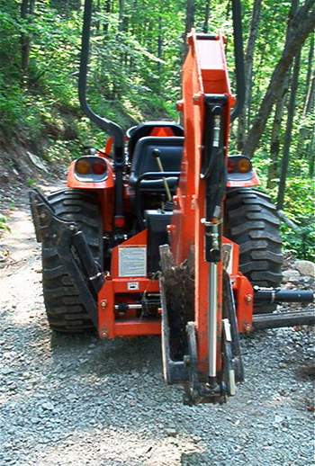

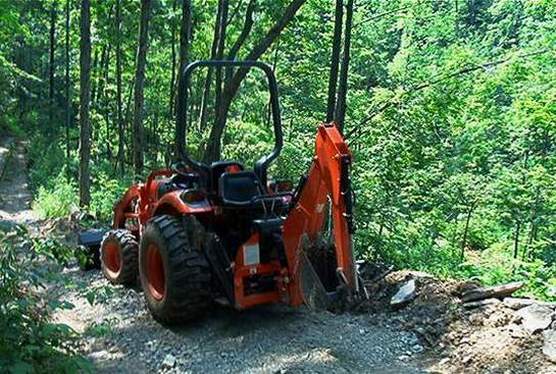

New Woods backhoe finally came in last week. I have run it quite a bit and it seems to work great. The newbee operator needs a lot of practice though.

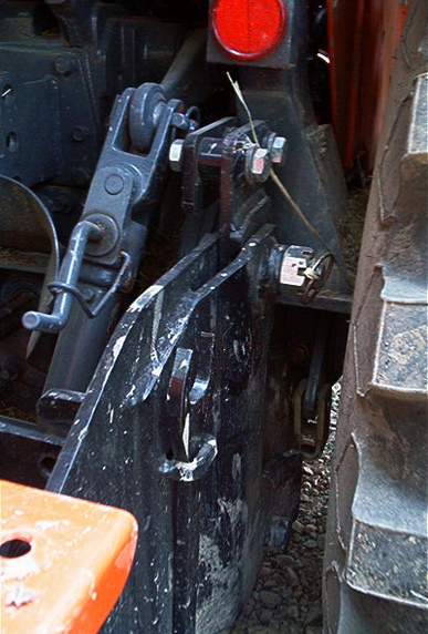

Closeup of 4 point connection. Lower outriggers and bucket, remove bolt on each side with wrench that rides on side of frame, lower unit with outriggers, disconect hoses, and go.

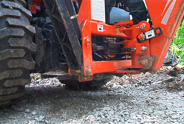

Side view of belly frame connection to loader/ tractor frame.
Seems to be tucked up higher than the Kioti hoe. Only loose
about 3-4".
This frame stays on the tractor all the time though.

Closeup of lower rear.

The 4 pt disconnect is very quick....but
Woods says that all the tractor 3 pt arms have to be removed-
unbolted, unpinned. And then reinstalled after removing the hoe. Not good.
On my last install I left all the 3 pt on and raised the arms up but they hit the hoe frame. still better but loose that much more clearance. I'm going to move the locking bolt thing on the tractor lever to the "raise" side so it can't be moved by accident.

I'm not sure if the back end tucks in better. That is an important area that I found out about after I got it. It will drag going through ditches or streams. I could measure it if someone wants to compare.

Cag, as for tucked back more, yes, it is a little tucked back as compared to the Kioti backhoe but still has a substantial bit of backhang. The biggest advantages are the sturdier mount, and less clearance loss, although, as 450EXC stated, it will still hit bottom in some circumstances, but pretty much all of them will.
