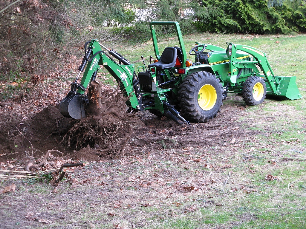

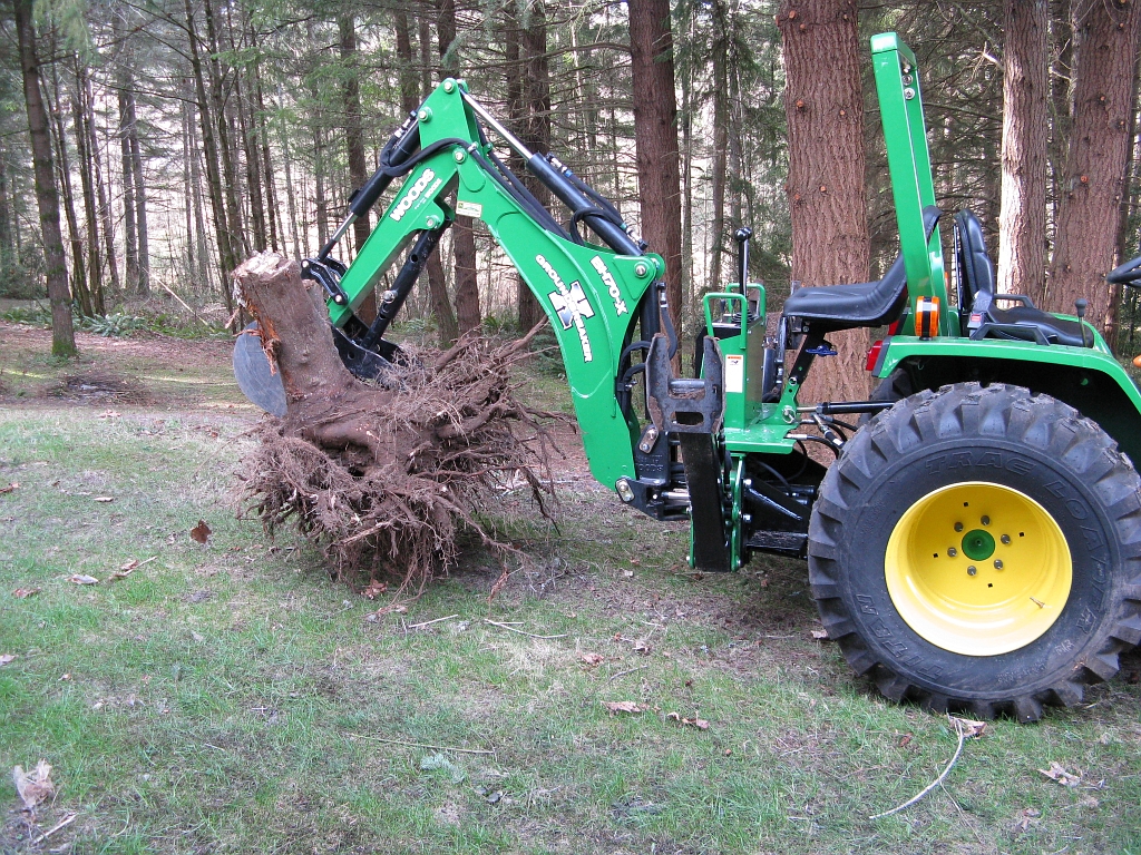

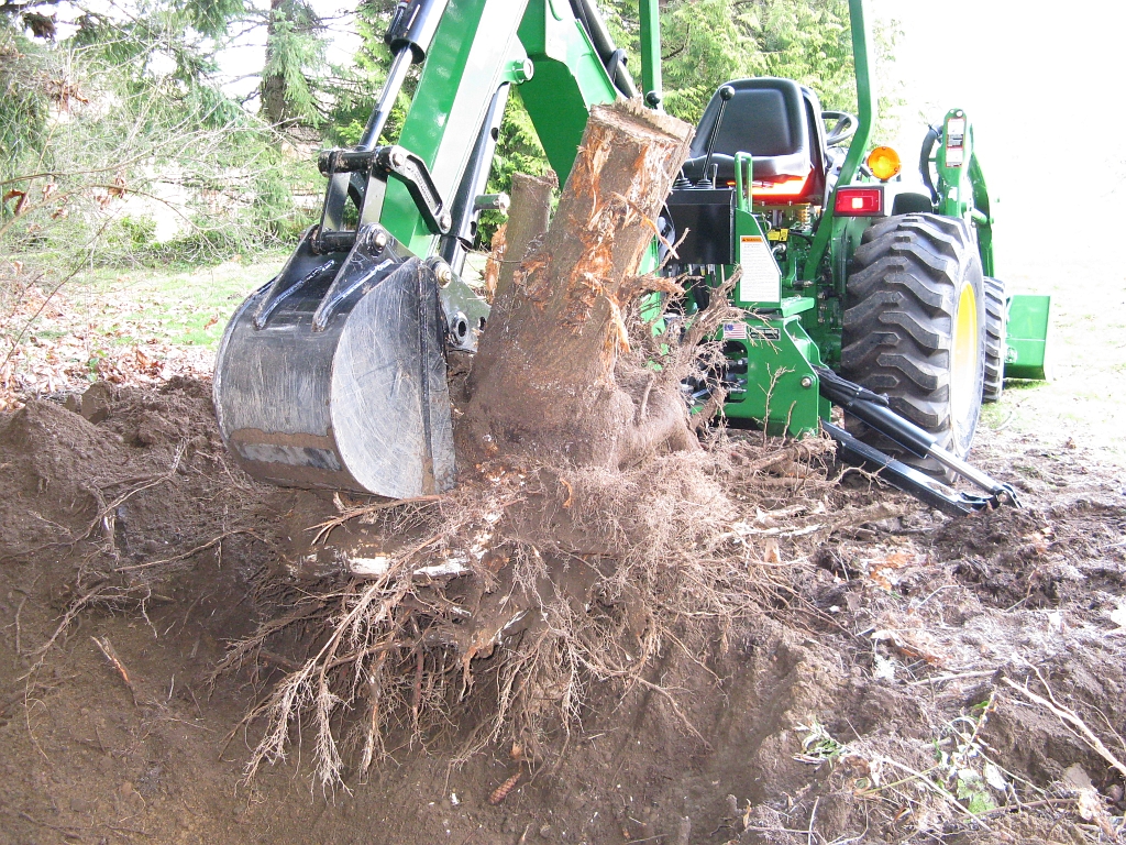

I just installed a new Woods BH70-X backhoe on my 790. It works great for removing stumps and stuff. Here are a few pictures.

Muxster, nice looking setup, good looking hoe attachment. Looks like the thumb was a factory option. Is the Woods hoe sub frame or 3pt hitch mounted? Have fun!

The hoe has the factory thumb. You deploy the thumb to where you want it manually (not hydraulic) and put in a pin to hold it. Then curl the bucket into it. Then when not needed you can park the thumb and use the full curl on the bucket... its sweet.
The hoe attach's with a subframe. There is a front hanger that bolts onto the loader mounts that receives one end of the frame. The back end of the frame mounts on the lift arm lower pins. Here are a couple pictures of the subframe and front hanger. The subframe is sitting vertically on the pallet. (that's how it came from the dealer)

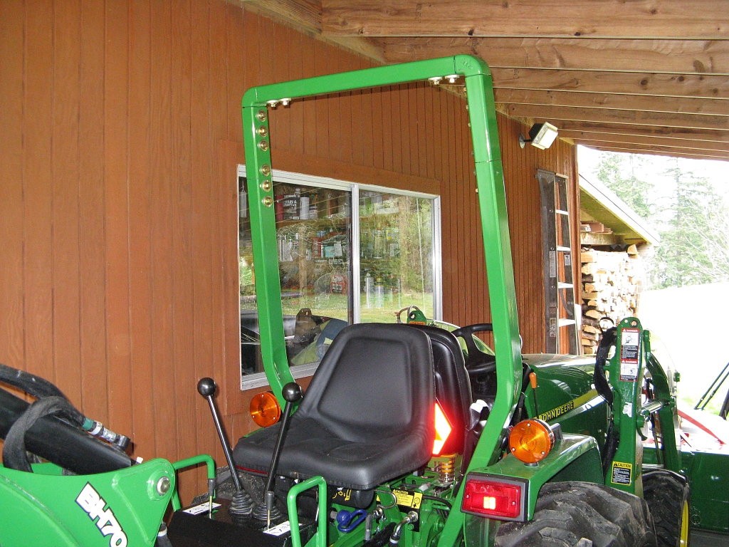

Looks great! Just one thing, you should get the ROPS extension Deere offers for that tractor. Here's a pic of mine. It's much better. I hit my head on the ROPS without it, was less then $100.00 through Deere.(not as pretty as yours;) )

I did add the ROPS extension. I didn't get it installed until after I installed and used the hoe because I had to order a 18mm wrench for the bolts (and yes, I also hit my head on the "short" ROPS). For some strange reason 18mm is not part of a normal set. I got the "in-between" set from Harbor freights.

Here is a picture of the ROPS extension installed. Also another reason it took me awhile to install is because it came in black and I wanted to paint it green. I was so cold that I waited a week after painting it before I installed it to ensure the paint was cured.
