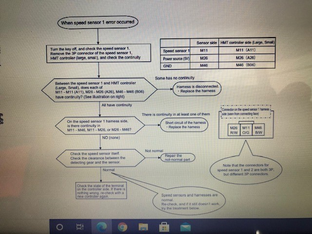

Does anyone know where I can find the descriptions for the DTC codes for my YT359 tractor? I’ve checked my operations manual as well as searched online and nothing.
My tractor is currently displaying and exclamation mark inside a wheel with the code 03 00046.05.
Thanks
   / New Yanmar DTC Error Codes #2
gkluck if you have your owners manual see page 14-56
Thank you.
