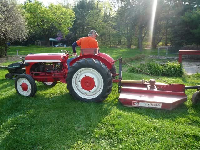

This is my Tractor
Here it is with its Bushhog
Thats not me riding it. Previous owner while showing me how it works.. And because of my few minutes on this site I understand more and new the right things to look for like the fact that my tractor has a 12v conversion and a slip clutch in place as well.

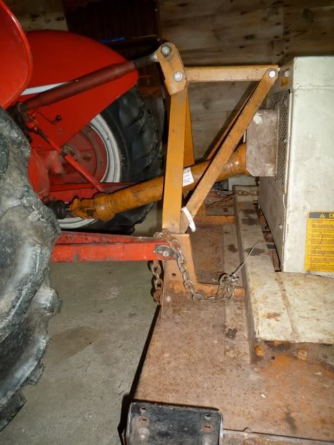

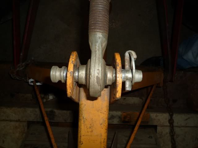

Now my questions...I purchase this Woods R59 last week and hooked it up on Sunday with the PO. First problem is the front of the mower wont drop down far enough. I said I think the driveshaft is too long and PO agreed. He said I could cut it down. He also questioned the top point on the three point hitch. Vertical position and the looseness of the pivot point at the shaft between the bars as shown.
Hopefully the photos help describe my dilemma
So- assuming I can cut it down . Tell me if my thinking is correct here. I have an electric cutter. (Better then a hacksaw). I will need to cut the dust sheath on the "plain" end . Other end has a large mouth to go over the universal joint. Then I will need to cut the shafts inside. (male and female) . At least I believe I will need to cut both. Any tips on doing this will be helpful. Now the important question is--- How much to cut off??? I noticed that the shaft expands quite a bit when raised to the full amount , so it would be VERY bad if I cut it too short. If I was to guess at how much to cut of I would say 2 inches. Is there a better way to figure it out? And what else should I be looking out for?

I am sure I will be in the minority, but I would just throw quick hitches on which will extend your lift arms about four inches.
