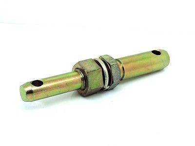

Once you get unhooked change all your equipment out to either cat1 or cat 2 ..
I've chosen to keep all mine cat1
Heavier implements get 7/8" slide pins
PIA but worth it in the long run.

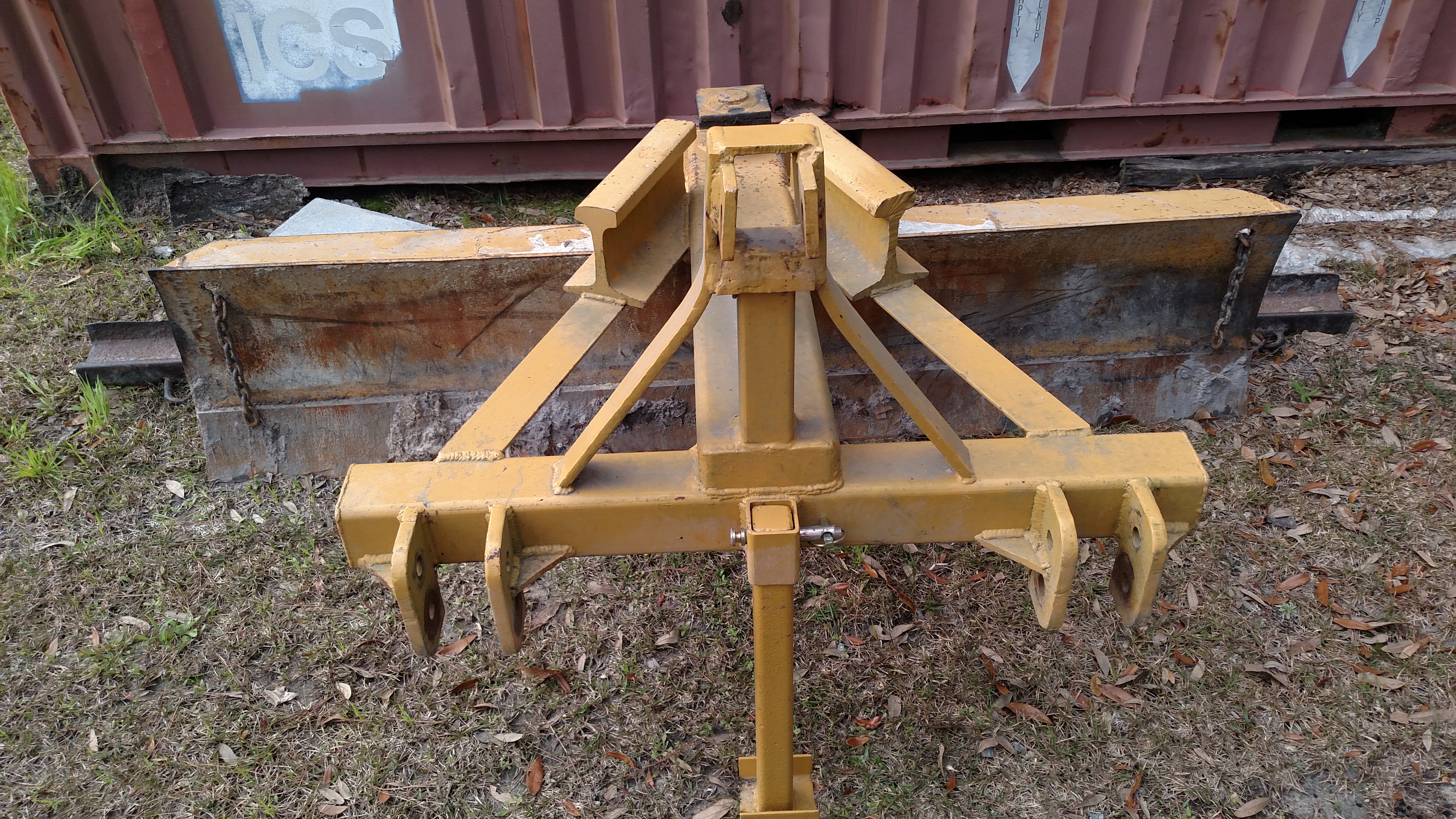

Like the custom scrape blade .
The only other equipment I have is a set of JD 16" 3PT bottom plows, which are cat2. But my lift arms accept cat1 or cat2 eyes I only change them out for those..
You can also think about a dual pin option I'm not a fan of them.. but it's available...
Get rid of those bushings they only make a easy job a lot harder.. choose one cat or the other or get a quick hitch if your work can accommodate it..
