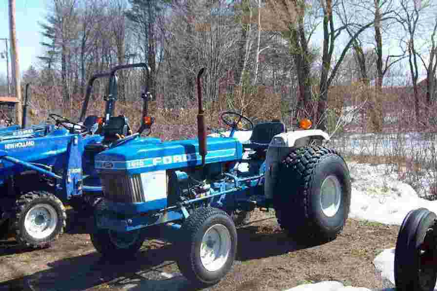

ok here's the update from my day of tractor hunting. Needless to say it was frustrating. After calling the dealer yesterday I left work early and headed up an hour away to look at the 1710. When I got there he told me I just missed it. THey lent it out to someone getting warranty work. I was PO'd.
In any case I looked at what they had. I drove a 1910 with no loader. Looked and ran good, but they want $6500 and it will cost at least another $3500 for a loader.
Then I went and looked at a yellow 3400 with 730 loader that I saw in the want ad. Rebuilt engine. Engine real clean. Ran OK, but seriously in need of paint job. $7100.
I think I am finding that the 2000-5000 series is more of a tractor than I need. Maybe if I saw a really clean one I would change my mind. I really liked the size of the 1910. I may go back on Saturday an look at the 1710 if I can get over the fact the the salesman screwed me. I guess if I had a warranty claim I would have wanted the same thing and can understand.
Here's a picture of the 1910 I looked at today. No idea what the loader would look like for $3500.

I own both a Ford 2000 and a 4000. The 2000 is gas, the 4000 diesel. The 4000 is easily twice the tractor the 2000 is and easier to operate as well. Power steering, independent PTO, an 8 speed transmission (as opposed to a 4 speed), and an extra 43 cubic inches turn a tough job for the 2000 into an easy one on the 4000. Both are 3 cylinder models from the early 70's and saw their share of abuse before they got to me.
Admittedly my 2000 is probably much more basic than the one you're considering, but if yours doesn't have power steering I'd pass it up for loader work. Ditto if it only has a 4 speed transmission, though most have at least the 8 speed.
Can't understand why your 4000 seems to lack muscle. Maybe too much low power running on Jet-A carboned things up. This should definitely be looked into before commiting. Used as an aircraft mover, a dropoff in power may not have concerned the airbase guys. As long as the tractor would get the plane down the ramp, it would be good enough. The stuff everyone wanted to work on had wings. Not every Airframe & Powerplant mechanic appreciates tractors.
   / Newbie--contemplating purchase of used Ford. #10
The 2000 you are looking at is a 1972 model. They were made from 62-75 (62-64 were the 4 cylinder, & are a very different looking tractor, much like the 100 series). With 3 cyl engine, it has 31 pto hp, cost under $4000 new. Today they sell for $1500- 5500 at auction, with $3400 being average.That's without loader. I'd say the price is quite high, but may be fair in your region, I donno. Better be the 8-speed for that money, and darn nice shape.
A 1710 doesn't have the best hydraulics, but work well & are good solid machines. I just got a 1720.
The very expensive loader they want to sell you new for the 19?0 tractor will look _just_ like the loader on the tractor next to it in your photo. Other companies make loaders that work fine for $2500 or so new, and if you don't need the loader _today_, you can locate used Ford loaders for $1500-2000 - it can take some searching.
A Ford 4000 is certainly twice the tractor of a 2000. Something wrong if the 2000 outperforms it. You can find cheaper/ better loader options than you have been quoted for the loader on a 4000.....
