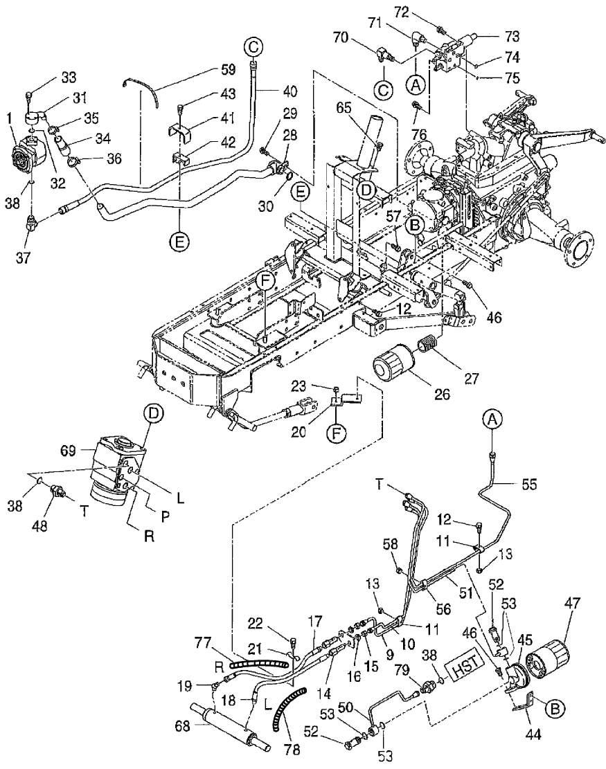

Dave, what you describe is true for your TC29D and my TC45D, but I believe the TZ24DA only has one main hydraulic pump. The power steering is tapped off that supply and routed to the PS valve at the base of the steering column. It's function is similar to a power beyond circuit or flow divider.
I'm attaching a copy of the complete hydraulic system for the TZ24DA. You can see the piping for the power steering and the HST filter in the lower portion of the illustration. By used the circled reference letters and details, you can piece together how the system flow works, but there is only one main hydraulic pump and no separate power steering system like we have.
Jason, if you will go to Messicks.com and go to the parts section, you can enter your tractor model and look at detailed parts diagrams like the one posted below. Earlier, I mentioned that the hyd filter was around $75. That was an error on my part. That filter is about $15 and the HST filter is about $26. If you want the special rugged HST filter that is designed for temperatures below zero degrees (and associated high pressure), then the price is $75 to $80. That's the one I first saw and reported in error.
EDIT: Here's another item about the TZ24DA that you can see in the diagram. The HST filter receives flow through the same pipe as the power steering valve. Therefore, the main hydraulic pump serves not only as the power steering pump, but it also is the charge pump for the HST. Larger tractors like the TC29D and my TC45D have their own charge pump that draws oil from the reservoir and supplies it under pressure to the HST for more efficient operation. On the TZ24DA, the main hydraulic pump supplies this function, eliminating the need for a charge pump on the HST. These are things NH did to keep the price of the TZ24DA as low as possible and reduce the number of components.
